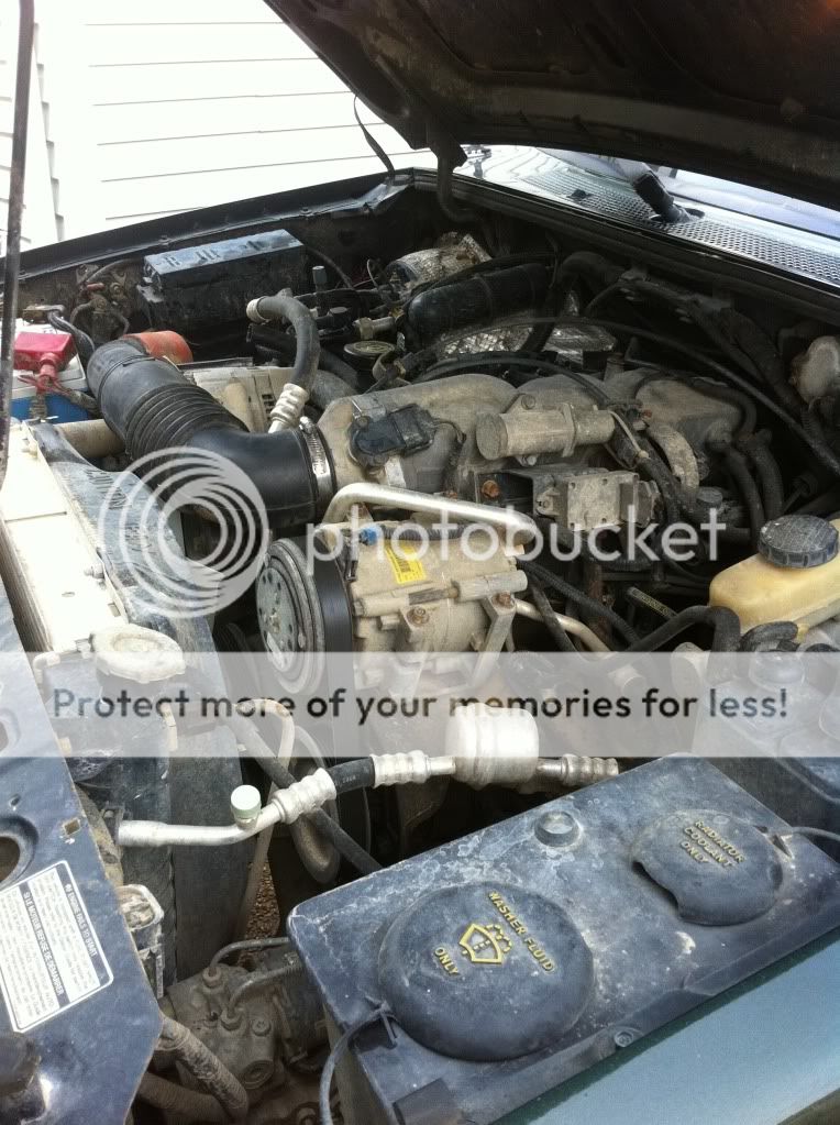

i know one thing, there aint much spare room under the hood compared to the ranger with all the goodies that came on it. im keeping the A/C and cruise but the EGR and ABS will be gone along with whatever i can get out of there.

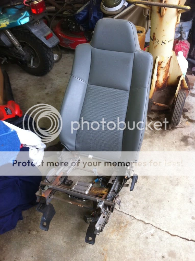

had a little time to kill so i started swapping the 2010 seats onto the expo electric brackets, wow what a bitch. the new seats have completely different brackets but i think i can make it work. but to do so i basically had to take the whole seat apart....so much for one of those "5 minute jobs".

shoulda said something Saturday....I coulda shown ya the "shortcut" on that:D:icon_rofl::icon_rofl:
took me what seemed like forever on the Drivers side when I swapped the Expo Sport seats into the Diesel....but once I figured it out, I had the passenger side done in less than 20 minutes :thefinger:
l8r, John
your seats bolt from the top side too?
