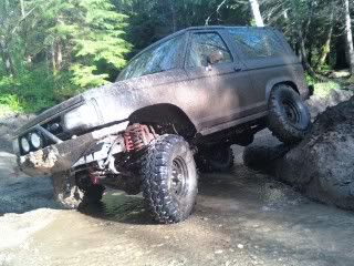

Went out today and thrashed around at redneck station a bit. Tried like hell to get stuck so I could test out the winch, but the damn thing just bogs right through. The weight of the bumper and winch was just what this thing needed, it evened out everything and now its pretty well balanced. Worked wonders on the flex as well... Not too bad for a cheap CL lift, $15 shocks and skinny track width... And I think there is a bit more in it as well-
Poser shot-

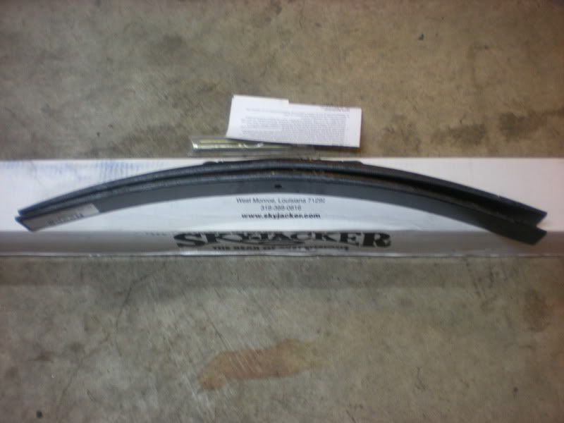

3.5" Duff kit from another member on here and an SJ AAL for the explorer springs. A set of homebuilt extended RA's as well as a couple of 1" coil spacers will accompany the front lift, Ill get to that in another update.

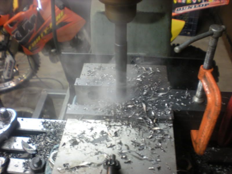

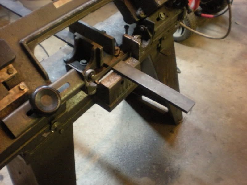

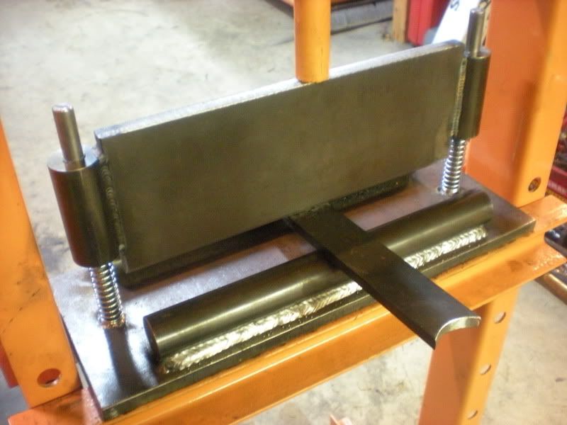

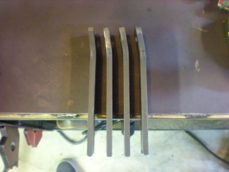

I also built some HD extended shackles, cost me a grand total of $20. Here is some pics of the construction.
Project El Taco...1990 BII

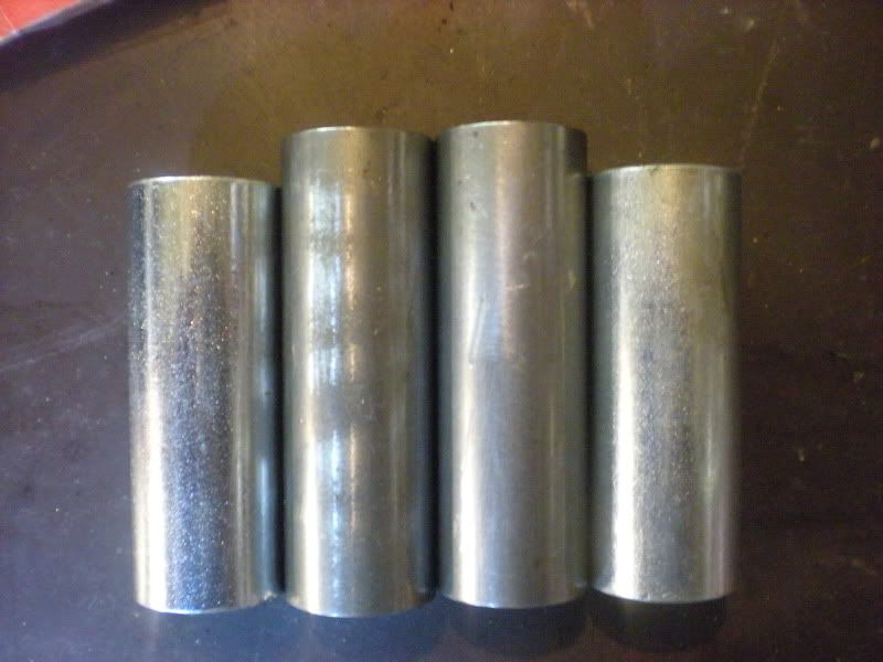

Had to make some new sleeves that were 3" long instead of the jeep bushings 2-5/8" sleeves.

They are roughly 4" longer from pivot to pivot, should give me an extra 2" of lift. 3/8x1-1/2" bar stock, tig welded.
