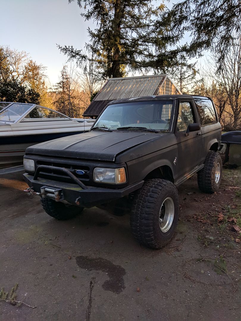

It's been 5 years since I drove El Taco on the street... If you don't believe me, the license tabs prove it. As per my last post, I was daily driving this thing until about Nov of 2013, and it had been the most reliable vehicle I owned at that point ... However, it started to become unreliable.... I remember doing front spindle bearings in the dark, just to get home, I remember having an LTB blow on me, and having to drop $1400 on new wheels and tires, just to get things serviceable. Around the same time, I was completing a 6.9 diesel engine build for my F250 (Smogie for those who are familiar), and basically parked the bronco....For the next 5+ years.
I've been so busy balls deep into the Diesel thing, that it got neglected. It's always leaked internally, but sitting compounds it....The interior got ruined. I'm saving the seats (They are the most comfortable seats I have ever sat in), but they will get recovered in marine vinyl. Future plan is to chop top it (No reason for a top if it doesn't keep the weather out) with some good finishing on the sheet metal to make it look good, as well as a custom roll bar, and eventually a custom soft top.

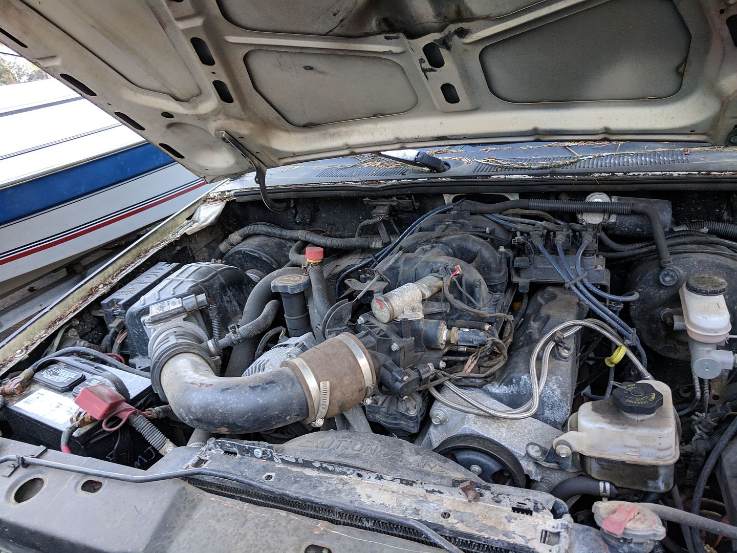

For the blasphemous part... I'm pulling the SOHC. Not because I don't like it, or have regrets about it, I'm glad I did it, and I'm glad it worked out. The main reason is because I am putting an NP435 in it and I have everything to put it behind a 5.0. I know about the adapter plates and all that, I own a full machine shop, I could easily adapt the NP435 to the SOHC. My issue is that the reason this thing has gotten to the state it is, is because it's not worth my time....Sad to say, sadder to admit.
The goal with this build has become effectiveness and enjoyment, if you read the first post, you'll understand the emotional attachment my wife and I have to it, and even if it became a rusted pile in my back yard, it will be mine forever...But my intent is different...Build something that My wife, my Daughter, and myself can enjoy forever, and have the appeal that most of us see when you see an early bronco.
I have my eyes open for a complete explorer 5.0 cheap. If I can't find one before I'm ready to swap engines, I have a complete HO that I can use, and will if I have to. Either engine will be gone through and freshened up, along with an XE264HR cam.

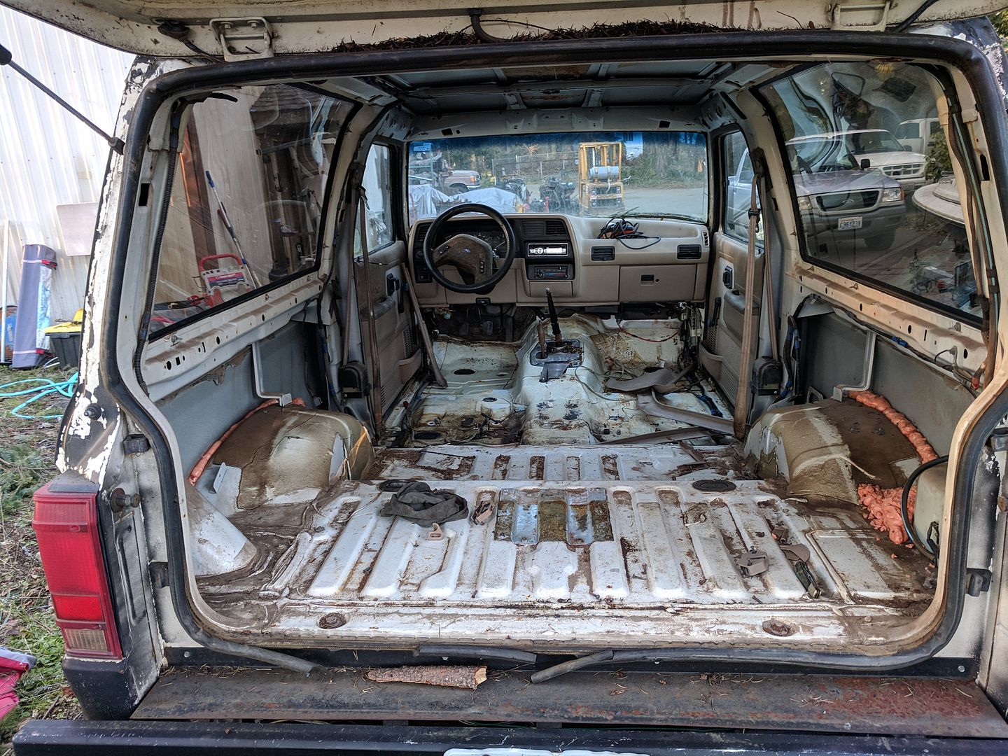

Anyway, the weather is getting better around here for the year, and I will keep up on the thread with progress as it happens. Today I ditched the destroyed interior and it's ready for pressure washing inside.
