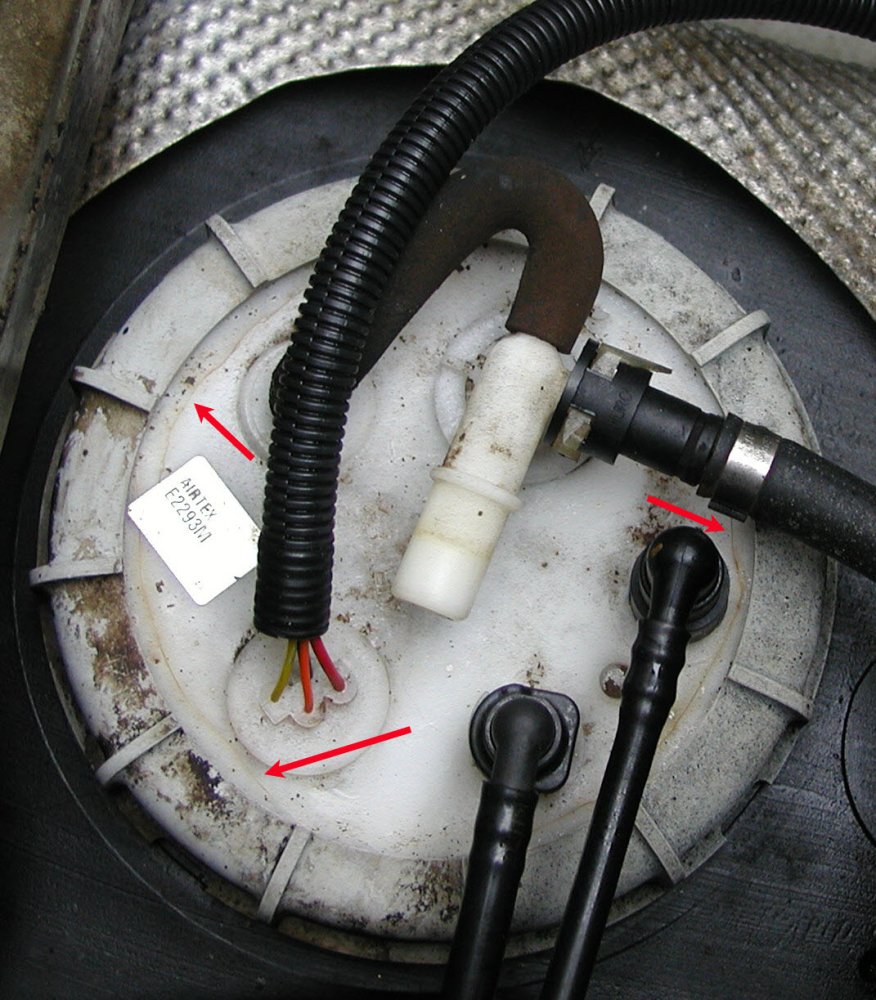

Powered up the system and same thing - instantaneously fuel sprating all over with not much chance to isolate it. Took a close look around at the components and dound a hairline crack running almost completely around the pump's top surface. Not sure what caused it whether I tightened the retaining ring earlier too much at last pump replacement, or if the Metal Prep caused it from pooling/sitting on it after spraing the fwd bed sheet metal. So replaced the pump with a new reatining ring and seal to solves that.

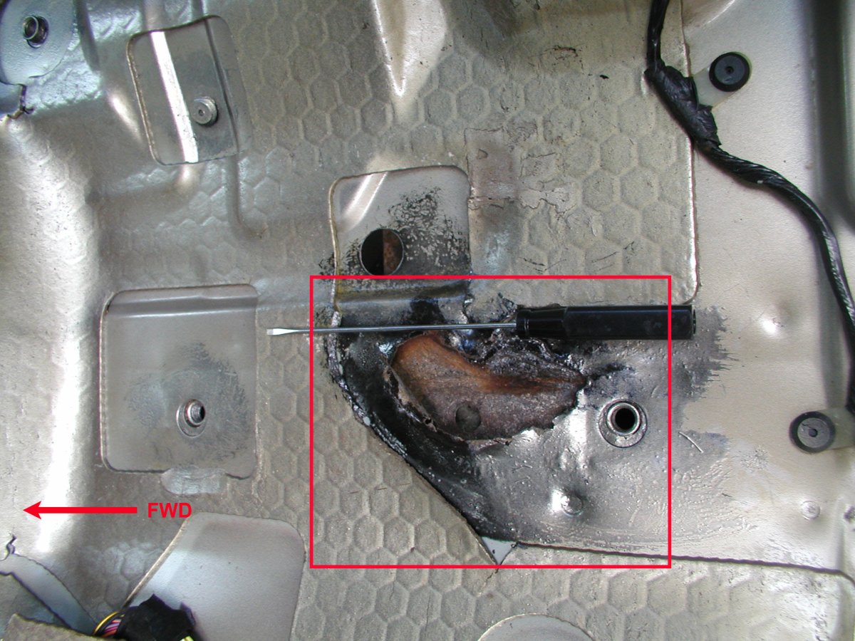

While looking for parts, I removed the seats and carpet from the cab. Found the carpet backing a little moist under the driver's seat which never showed any indications prior. Peeled up the rubber coating glued where the corrosion was. It looks multiple layers of sheet metal afrom the metal sandwiched in the middle. Mechanically removed all corrosion I could see and applied Metal Prep. All looked good so I mixed some Marine Tex (Strong2-Part Epoxy. to repair/reinforce the area. Mentioning this as there's multiple rubber grommets fittted to holes in the floor that may break down allowing water infiltration.

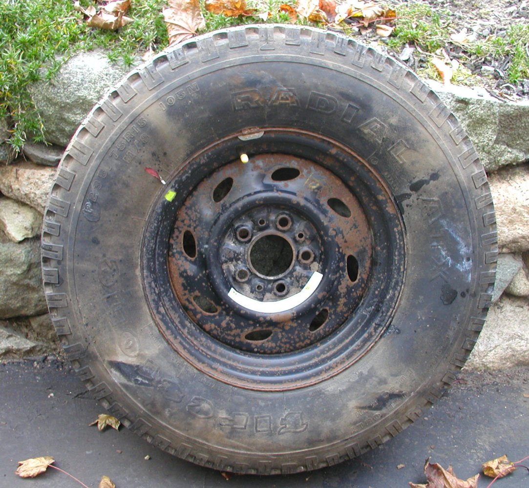

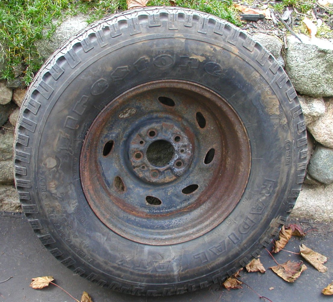

Of course with the bed raised I'm touching up the Frame/Chassis members I can get to with POR until I can get it in the garage to do it correctly. One find I thought was fairly cool, I lowered the Spare Tire - Firestone which looks beefy and an unused original tire assy. Although it looks like a normal, everyday driving tire it still sports the "Temporary Spare - Do not Exedd 50 MPH" on the side wall.
