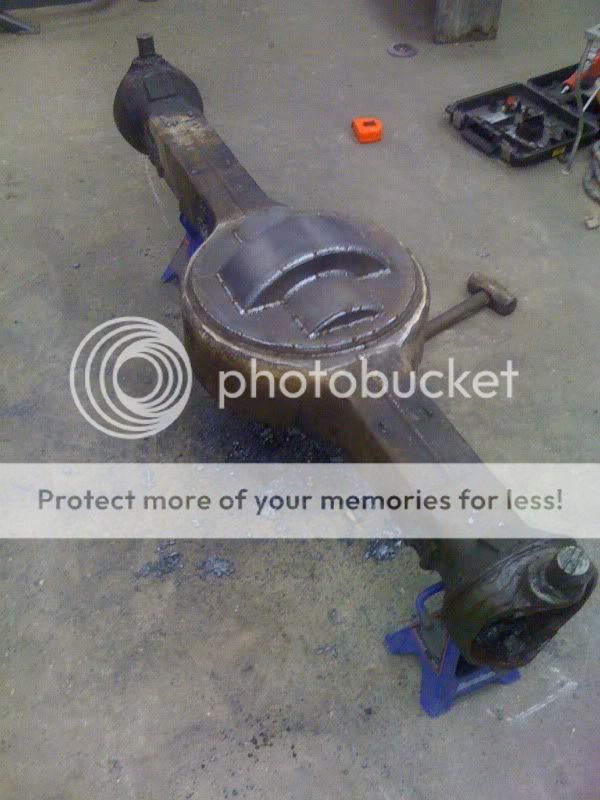

I am curious, why did you cut the bowl part off and replace it with this? is this for clearance between other mechanical parts that might hit it as the suspension travels?

That pic isn't mine. As it happens, photobucket had it on the bottom of the the upload page when i was uploading pics of progress i had made. The old skid has about 2" of dead space below the bull gear and as much as 4 1/2 below the caps. Removing it and replacing it simply gains ground clearance and lowers the oil capacity from 12qts to about 8 1/2qts (if my math is right) another benefit is that tho stock skid is only 3/8" thick while the rest of the housing and third are 1/2" thick minimum. I plan on abusing the hell out of these things and want the reasurance offered in a 1/2" skid.
ahhh I see now.
I really want to see the area you are going wheeling at that will damage these axles :p
