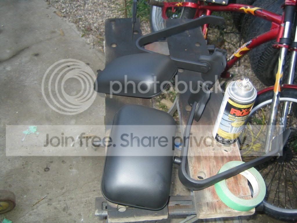

as far as progress, i did buy some mirrors and paint em, but didn't get too many pics as the camera died and i have no charger. frig. but i got 2
you can see the mirrors in this pic, flat blacked, but i couldn't find a passenger side one. found the bracket. these are off a bronco, not b2. cause its all they had. they are about 1.5 inches wider than the ranger ones but the same hieght. didn't think this would be a problem. the actual mirror itsself is the same.

As for the mirrors....NICE. I think thats what i'm going to do too. I have some metal etching primer and some flat black spray paint so thats going to be on the to do list. The chrome on mine are all scratched up and not worth looking at. I know my dads truck would look better with flat black mirrosr might run the thought past him.

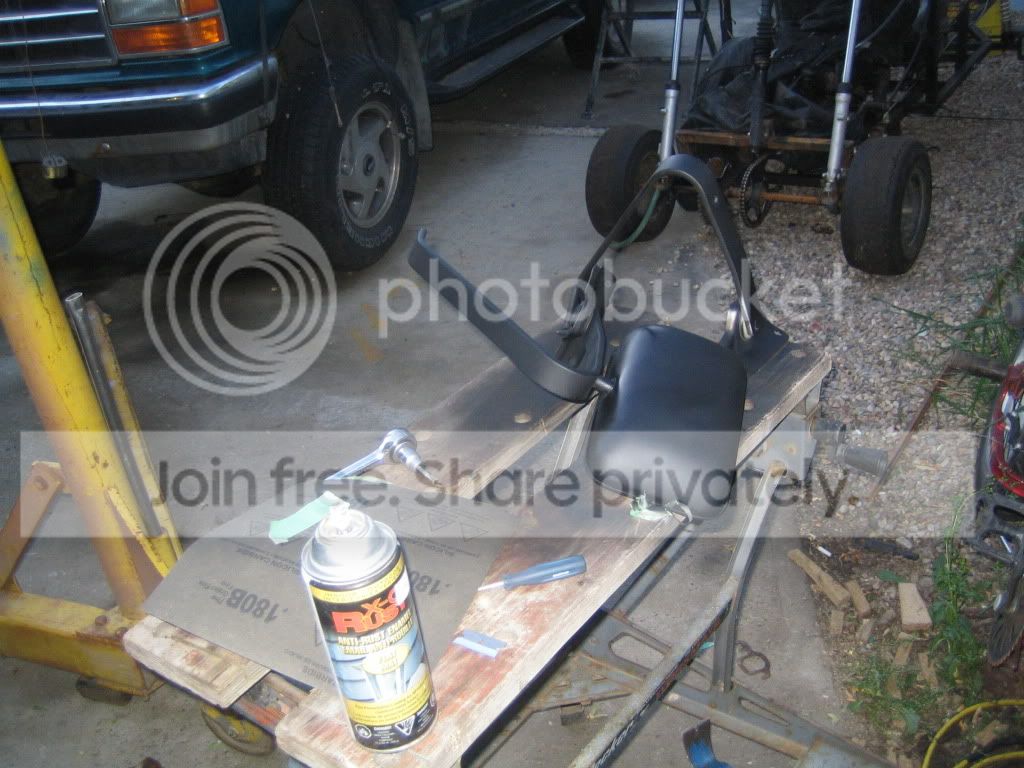

got both sides done and painted numerous coats. got 2 ranger ones for free but im usin the f-150 brackets, they are a little wider. mirror size is identicle. and they were free. yay!

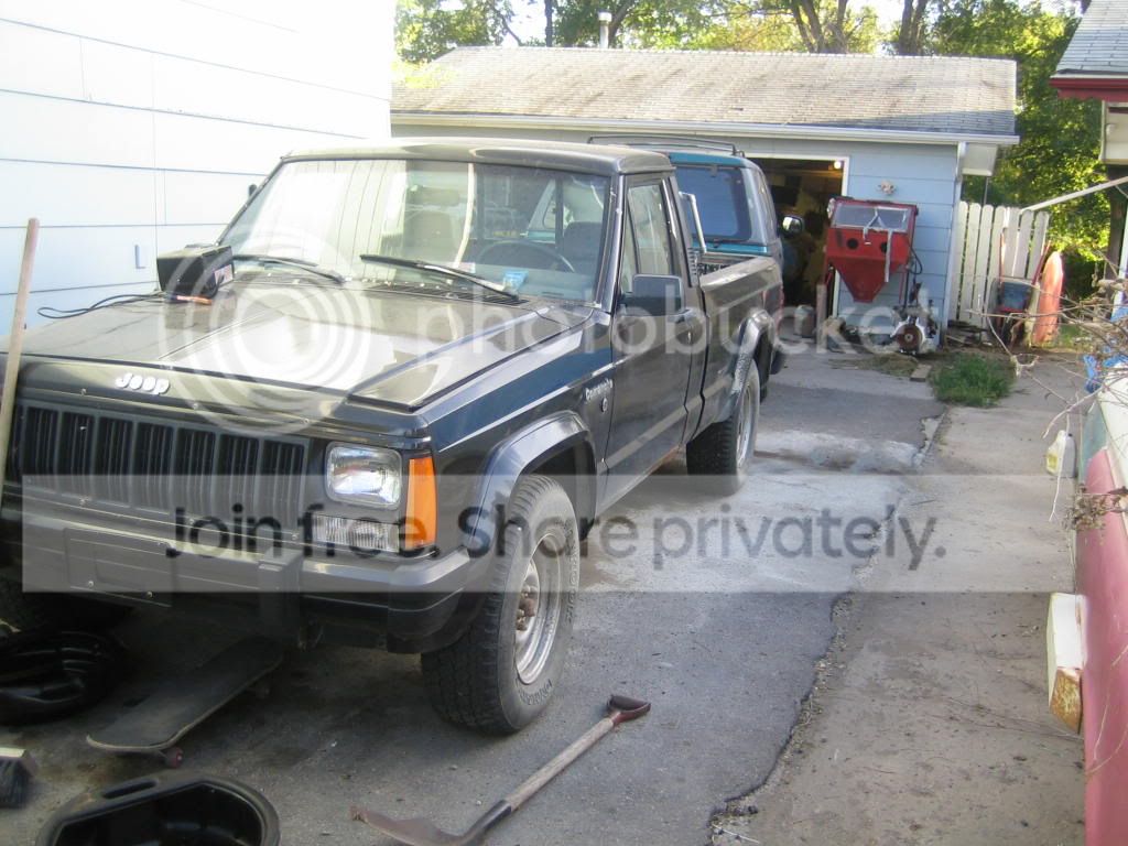

the unknown owners jeep. we were doin some work on it but lost the owners number and he hasn't come by in over a year. his names dana? i think he likes the free storage.

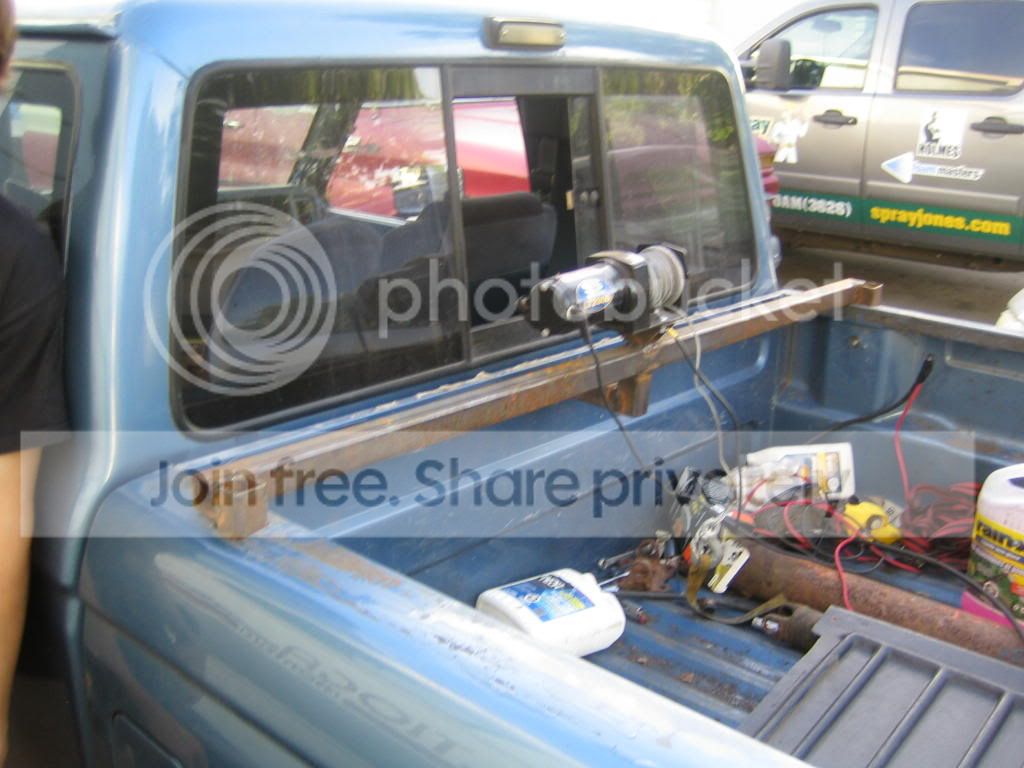

my sad excuse for stick welds, on my home brewed winch bar. i used it to get shmuck in my truck

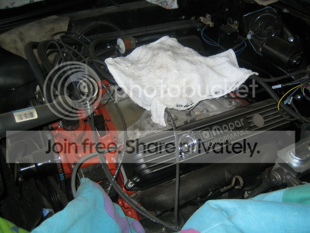

un veiled the beast! 428 Cobra jet! freshly rebuilt 9 years ago with top end stuff! worth nearly 10 grand, making over 650 pony's.

the sad excuse for a ghost stripe on the roadrunner. its getting repainted, yes yes.

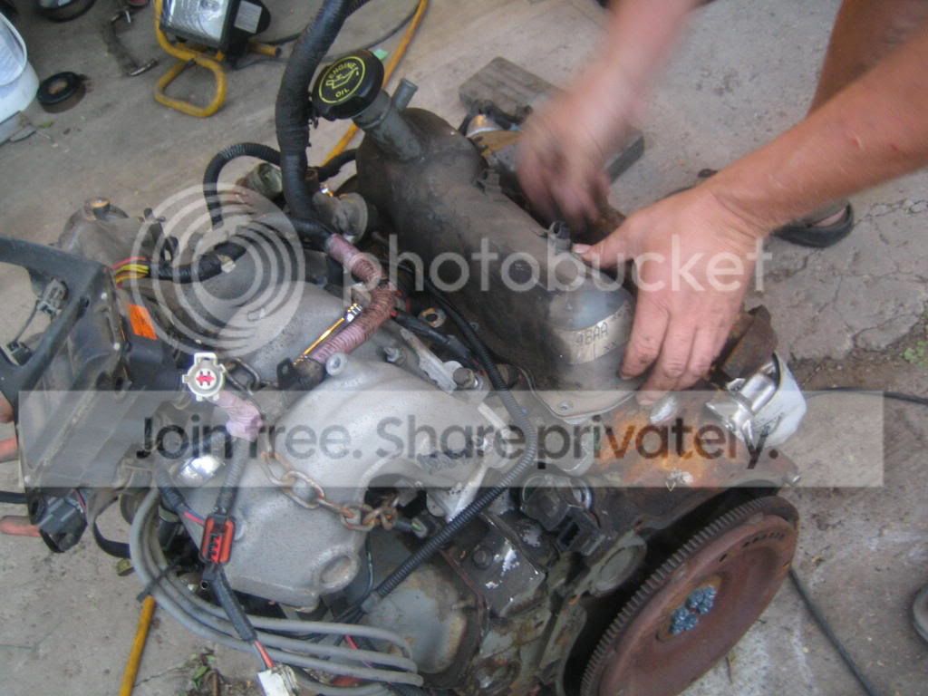

ok. thanks to someones hounding (hint hint) i actually got off my ass today. what i did was truly phenomenal. that was, to get my dad to do the same! WOW!

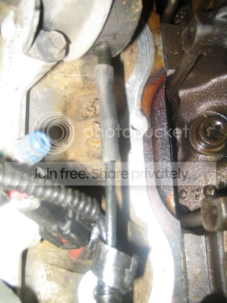

alright. since i hate uploading pics and its already 1130, heres the downlow. we finally figured out what the guy on the explorer tech thinger was talkin about, thx to my dad, and we used his technique for a flawless install!
first, i cut a piece of masking tape at exactly 34 mm. we rotated the engine to tdc compression stroke cylinder#1, by removing the valve cover. (we already had a new gasket so this was all done in a night) we put the tape on the crank pulley on the front of the engine so the piece of tape went 34 mm's from the 0* line marked, on the passenger side of the engine. i have pics, im submitting them in the "submit info for the tech section" thread.
then, we turned the crank clockwise until the needle that reads advancement is pointing to precisely the far edge of the tape, therefor 34mm from the 0 line, aka,26* as specified by the instructions givin to us by the ford dealership master mechanic (who was quite helpful, and knew exactly what we were talkin about)
then, we turned the sensors shaft w/ the hylicel gears so the c shaped mechanism inside, the TOP EDGElines up with the advanced mark on the clear sight glass on top. this is done so that as you insert the gear into the block, the hylicel gear makes the c line up with the second line, which is 180* to the plug inserted. once installed in the block, the sensor can be turned to adjust, and should be set so the edge lines up with the mark that is 180* to the plug. the whole assembly should then be almost if not exaclty perpendicular to the flywheel/back of the block. tighten the hold down clamp and make sure that the c stays on the mark it is supposed to line up on.
you are almost done. now simply rotate the engine over twice, and if the sensor c returns to the line 180* to the plug, you are set!
got the @#$%&* sensor in. easier than i thought it would be. hope it all works out.

the engine together!!!
Project black betty(aka money pit)

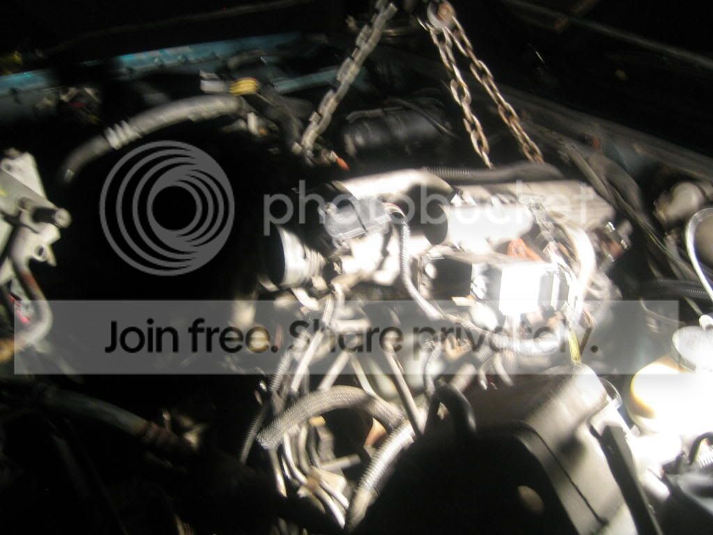

engine bein dropped in. kinda reverse order but STFU
givin us trouble, this was the first attempt turns out ford drills holes in the flywheel for balancing, but in their infinite wisdom, drill them in line with the torque converter boltd. so we;re tryin to force a fricken 1/4" stud through a 1/8" hole, we get frustrated before i notice, hey this holes too small. and then my dad thinks, o right, theres smaller holes drilled in the flywheel for balancing. 2 minutes later, viala. she clunked together and ready for the next step. so thats an adventure we saved for another day cause we were tired from fighting with it, and i was tired from goin shopping with the lady friend.
