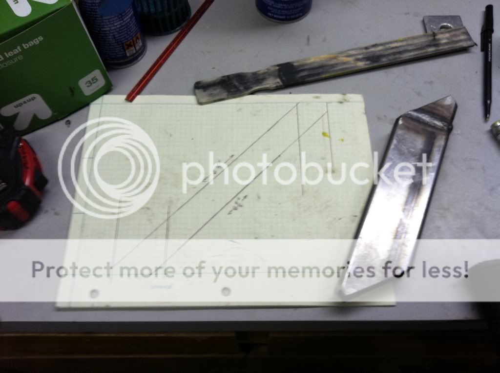

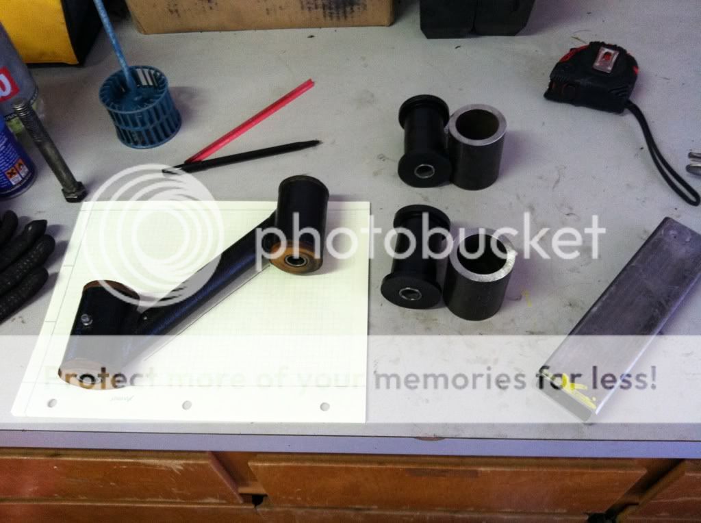

Started fabbing my new idler arm with bigger bushings, using common standard chevy leaf spring polyurethane bushings. DOM steel sleeves and bushings from RuffStuff, and 12" of 1"x2" .120 wall square tubing.
Transferred the angles to graph paper, and cut the tubing (too short :icon_confused:). Measure 3 time and I still manage to screw it up...so I welded it back and cut it again...this time right on the money.

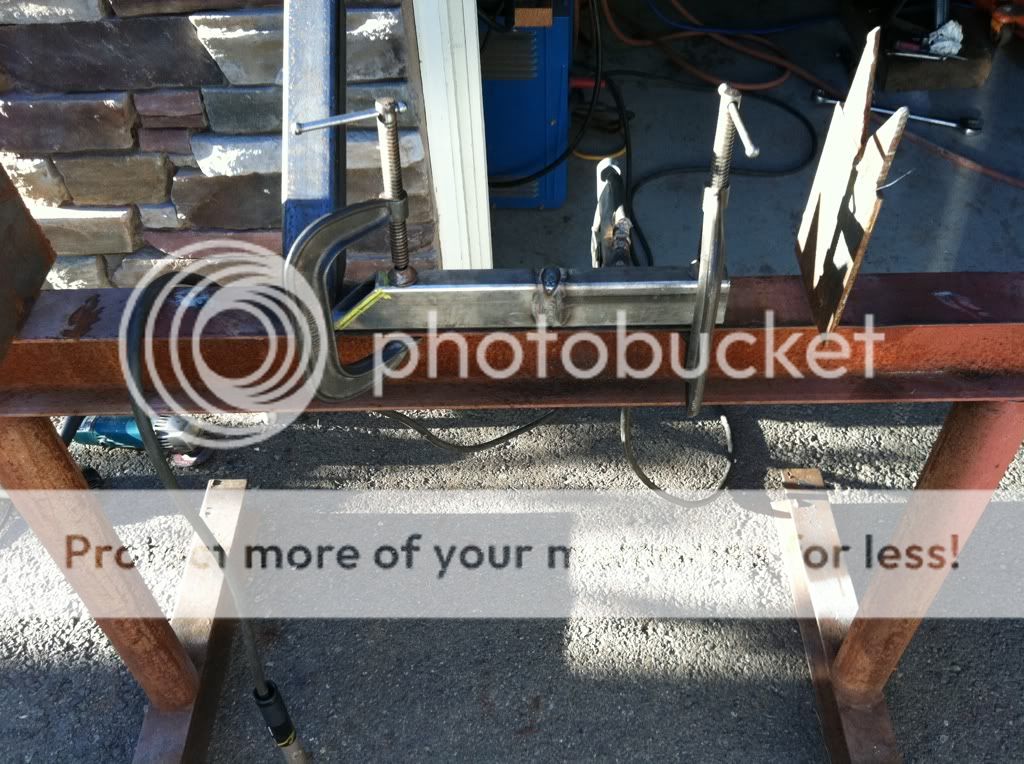

Next have to carve out the tubing so that it is curved and has minimal gap-agge so I can :icon_welder::icon_welder::icon_welder: it up nice.

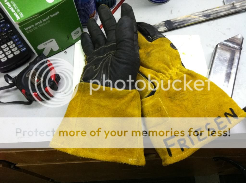

New welding gloves:

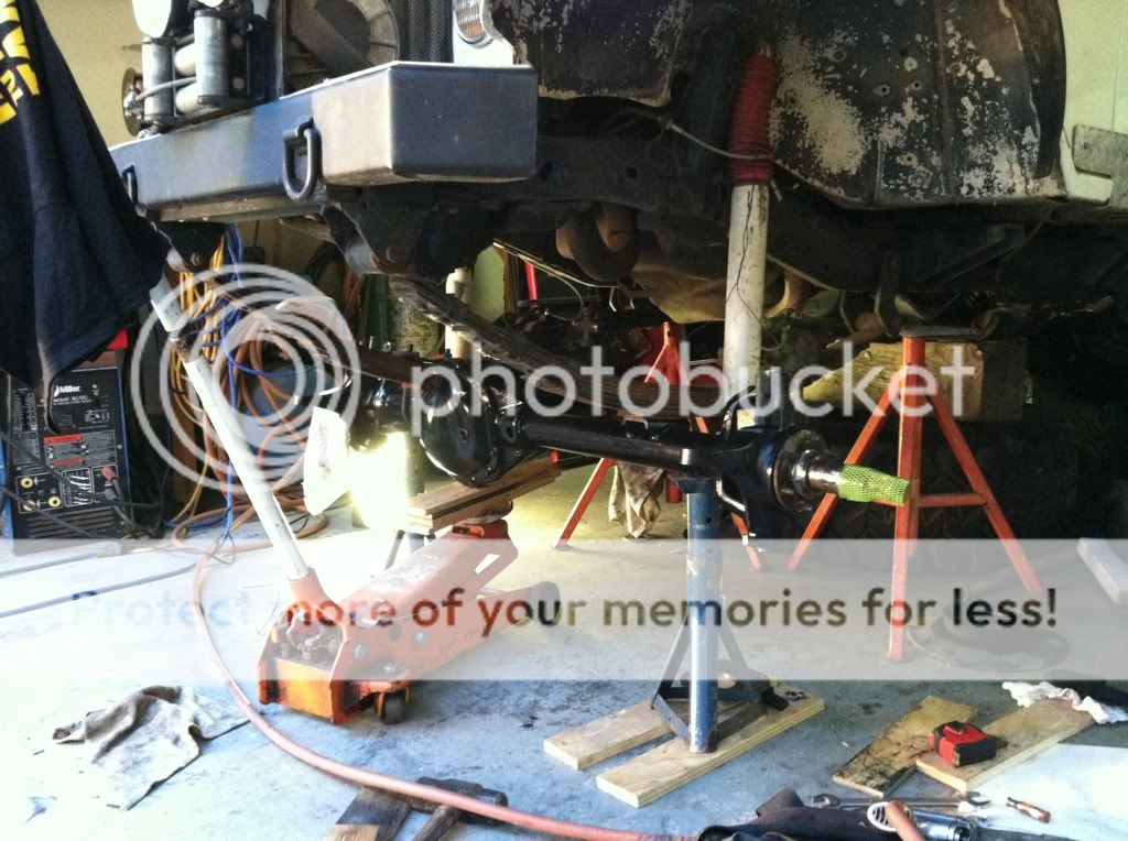

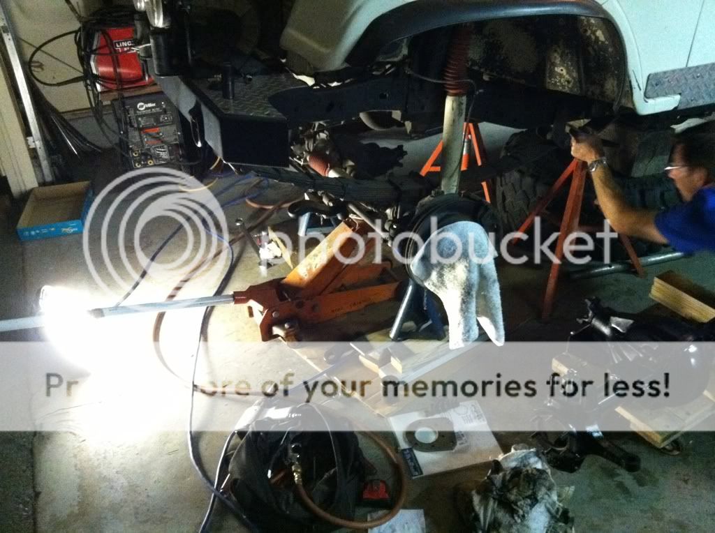

Helped dad start his D44 swap:
He still needs high steer arms, tie-rods made, and misc. TRE's...all his outer hubs will bolt right up!

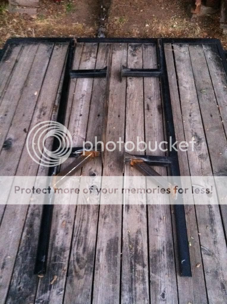

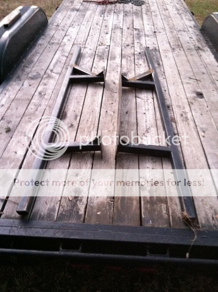

Boggin, here are two pics of my sliders, let me know if you need more or different angles.
Notice nothing about them looks straight. This is on purpose, when bolted up the are dang near perfect. The frame rails are not parallel and in two places they change angles, so there is actually Alot of geometry going on to keep them parallel with the body. The tubing is all just butt-welded together. The last 12" down at the end by the large tubing gussets warped some due to me totally spacing out and forgetting to clamp them down (idiot). I'll have to heat them up a little and straighten those ends out. And try to remember to clamp the crap out of them when I weld in the next set of gusseta for the opposite ends.

Dad's progress:
what leaves is he running up front?
Who knows. Thats a good question. He says they are the epitome of a bastard pack, spliced together from the stock cj springs, lifted cj springs, yj springs, and some from some ford leafs. Basically anything he could grab at the time.....15 years ago when he built it all. Surprisingly, they flex pretty good, but he needed beef to hold up the V8....

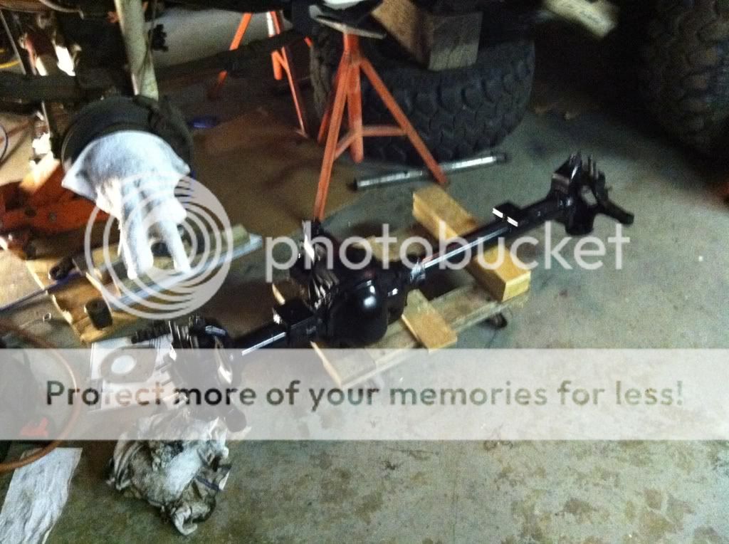

Axle shafts ordered, from Jeffs Bronco Boneyard. They are listed as heavy duty OEM replacemnts. Whatever that means :icon_confused:
The gears ($680) locker ($506) and shafts ($257) are behind me now, the rest is cake:
