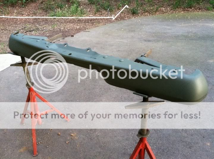

Figured while the bumper is off, might as well get rid of the remaining chrome:
Ground down to bare metal, then 2 coats of self etching primer (a must for painting surfaces once covered in chrome):

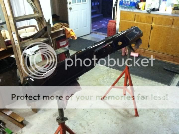

2 Thin coats of Glossy black Rustoleoum:
Project 4x4 Commuter Mazda
It will get another 2 thin coats before all is through and through.

looks great, but wouldnt it have made more sense to make it bedlined like the rest of the lower half of your truck?
It would have but, I've seen what bumpers look like painted with Monstaliner and I'm not fond of the way they turn out. Too much bed liner IMHO.
