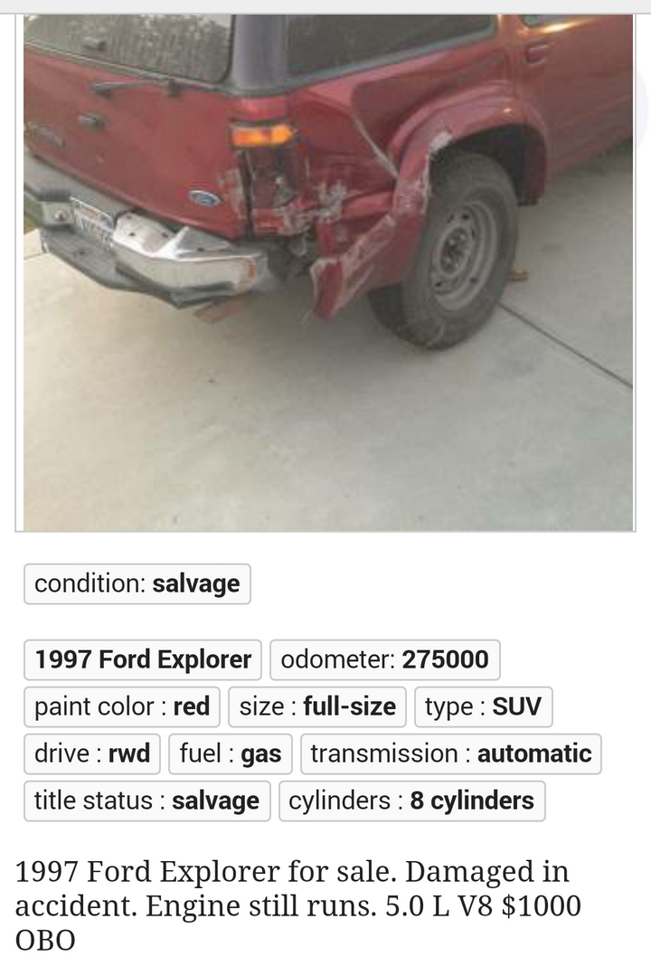

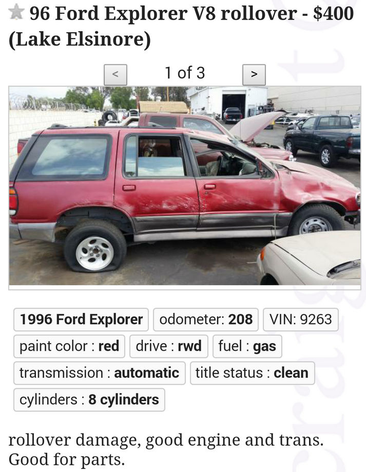

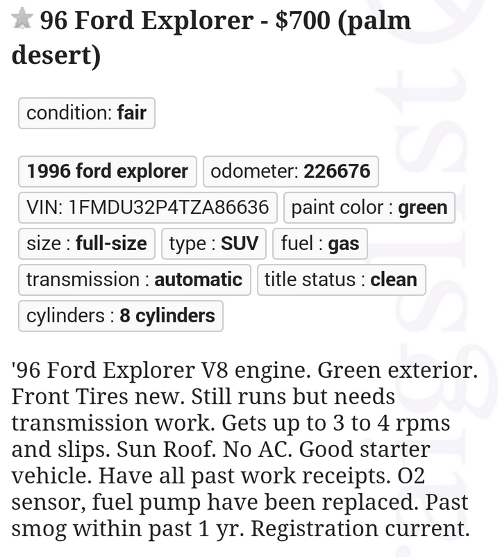

Shoul I pull the trigger ? am i better off buying a running Explorer or the wreck?

Unless there's a ton of crushed stuff under the hood of the rollover, that's the one that is the most interesting to me.
The $700 no ac/trans issues is 2nd, the $1000 rear end damaged is too much money.
Go with the first one, not only is it the lowest mileage of them all (200K is not really much for these setups, I swapped in a 190K mileage drivetrain that ran and drove like 50K, and my second swap was a 168K drivetrain, it runs and drives like a 75-90K), but you know it runs and drives otherwise it wouldn't be wrecked. For $400, I'd jump on that QUICK!!
