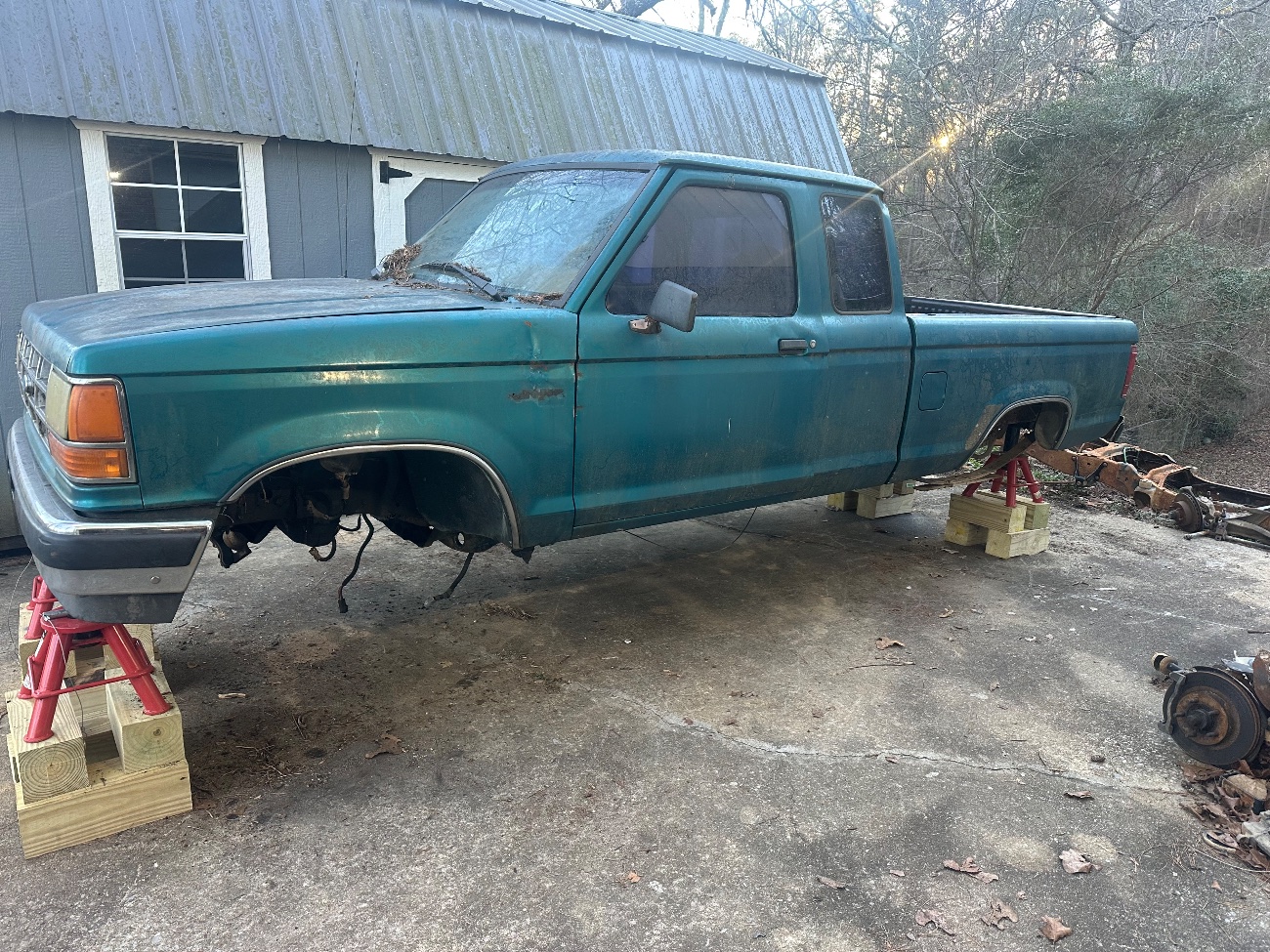

Gonna make some headway tomorrow as I’m off work.
Anyone wanna join the fun?

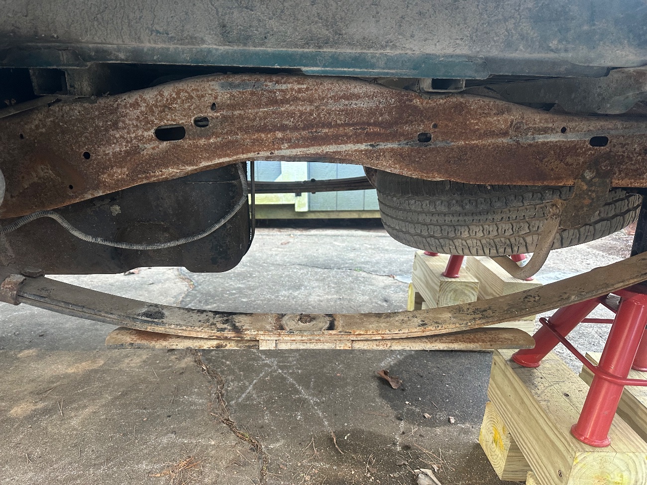

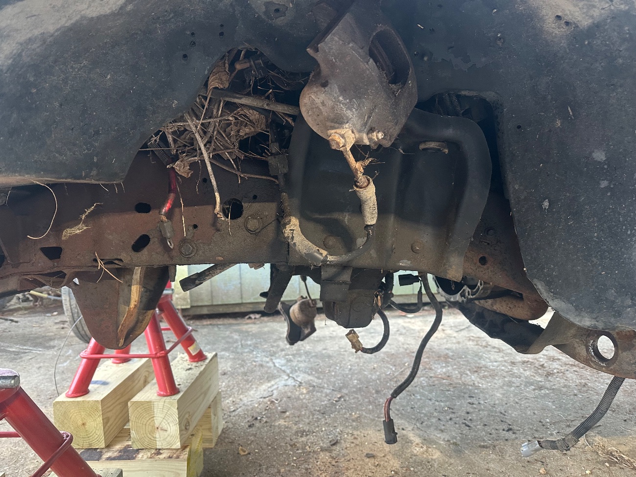

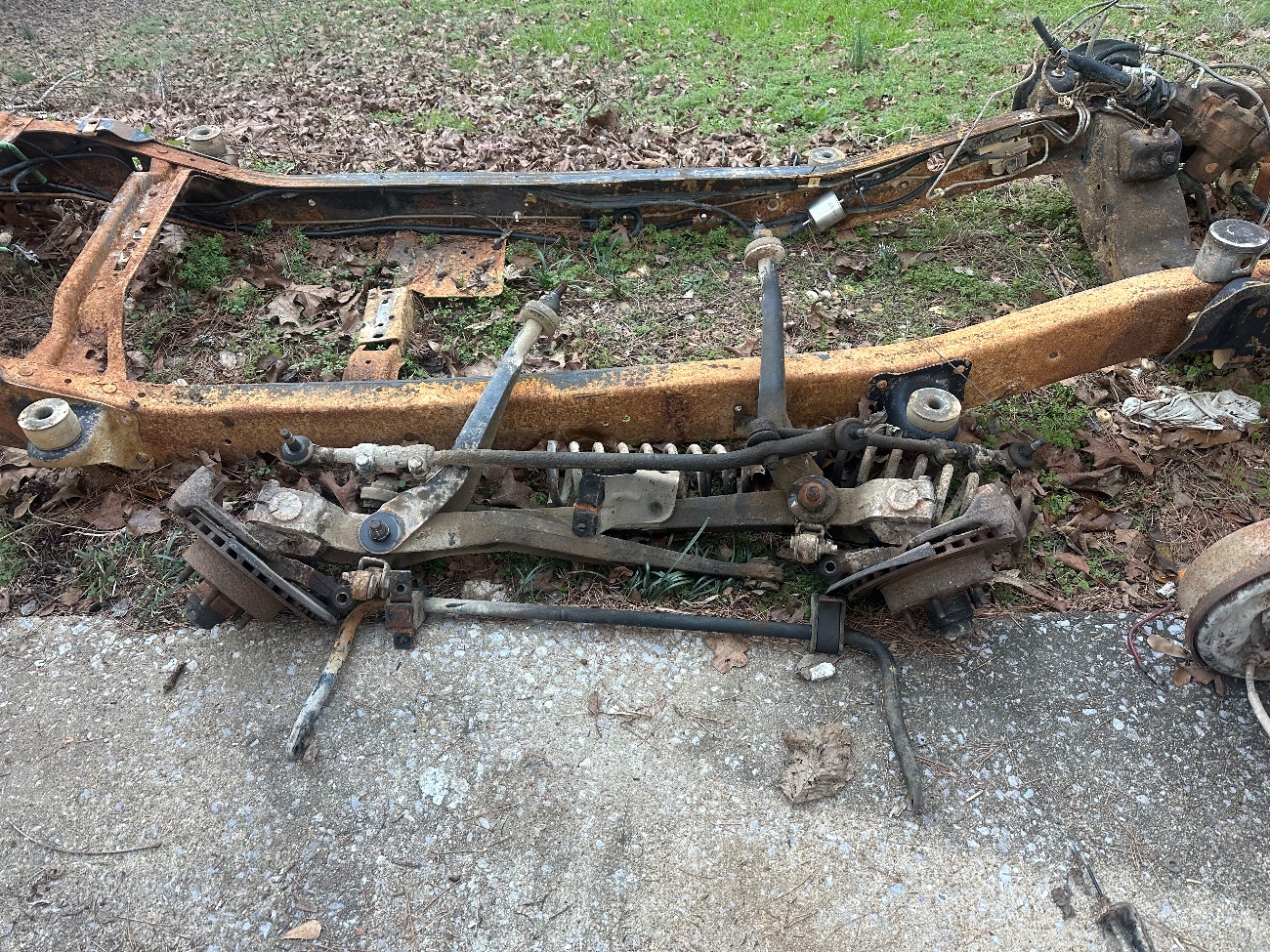

Stripped out the suspension today. Funny thing, the rear axle was harder to drop out than the front suspension…. Guess it’s bc I didn’t cut any brake lines or cables
Project “Fat B!tch 2.0” is officially underway!!
Front suspension. Anyone need it? Going cheap! 🤣

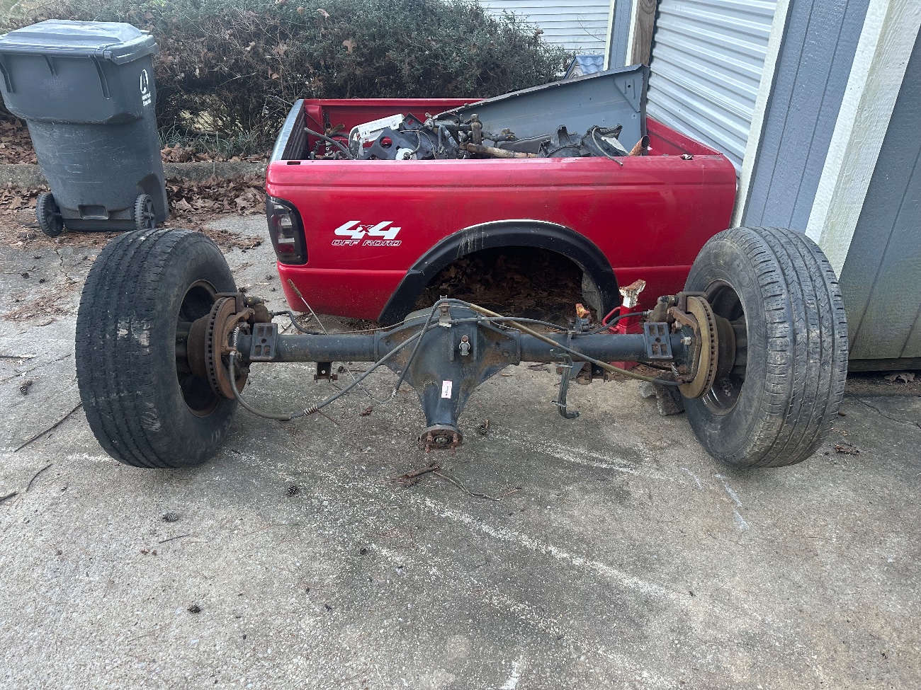

Here’s the rear axle I’ll be using…. Saw today that it may be a D70! I’ll have to confirm later, right now the goal is to get the spring perches at the correct width, and pinion angle set (kinda).
Gonna be doing the Chevy leaf spring conversion also, but I’m gonna have to figure out about the rear cab mount. I’ve read the article on the tech page, but I’m not sure I like how the front mounts for the bed are left with no support after the rear cab bracket is trimmed. May have to fab a new “all in one” bracket, but that’s a problem for a later time.
looked like a dodge axle for a min..but those are usually corporates....or a c&c dually ford van maybe.
70 will be a 35 spline. ford perches are generally rolled, though there are econo chassis with the cast things.
Yep Bobby, that’s where I got it from!! A Ford Ambulance.
the super 70 has bigger shafts ... like 36 or 37 spline so common lockers ect can be a shit show...like the 60u with 32 spline oddballz
The 2000's? Chevy ambulance I drove had a factory limited slip in the dually rear axle. The thing would drift in snow covered parking lots like no other.
That's an Eaton gov-lock or some people call them a gov-bomb, they work fine right up to the point they explode... taking out the carrier.
