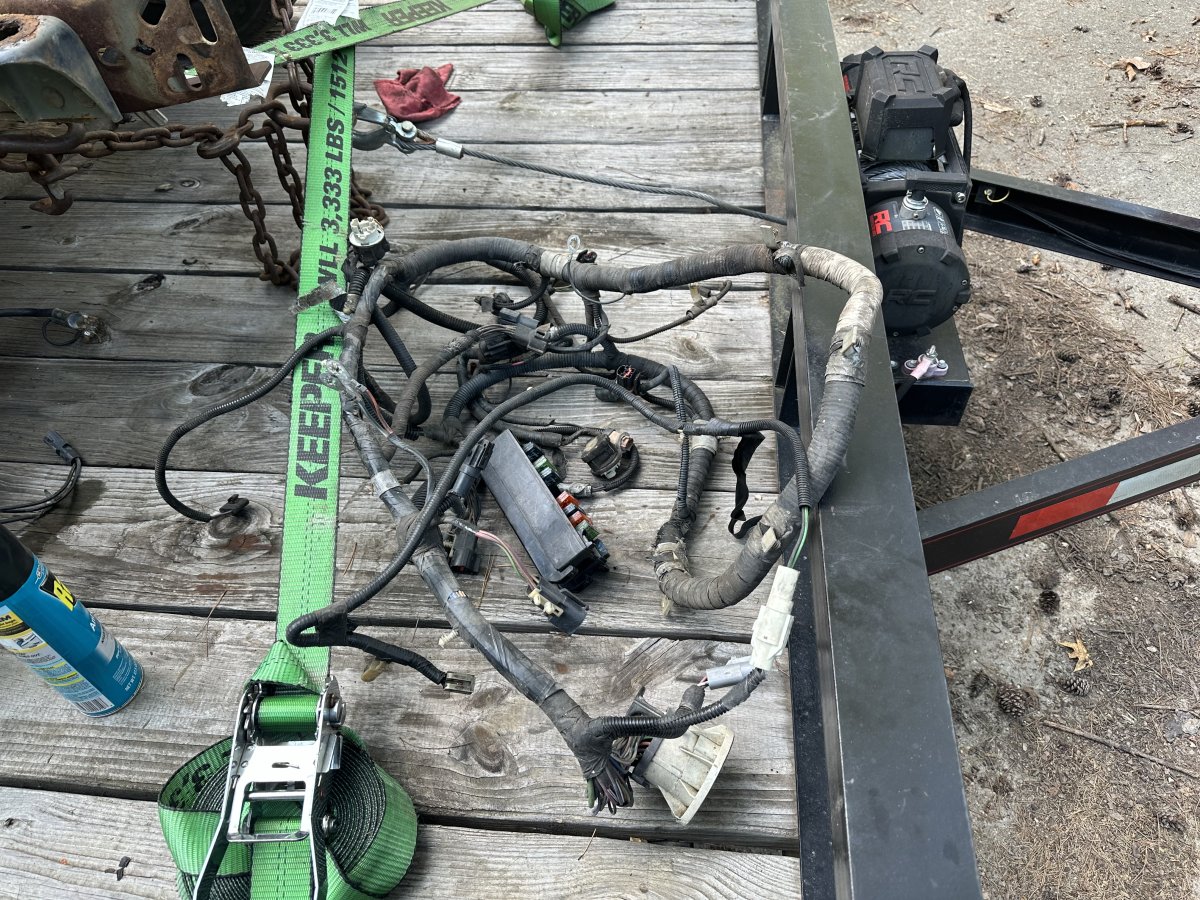

Today I came home after work and untangled the wiring harnesses that were laid back when the previous owner harvested the inner panels for the front end.
He was pretty cool in that he didn’t cut anything, just unattached it and laid it back over the motor.
This evening I’m gonna look into adapting the Explorer 5.0 harness to the harness(es) in the truck to make it work.

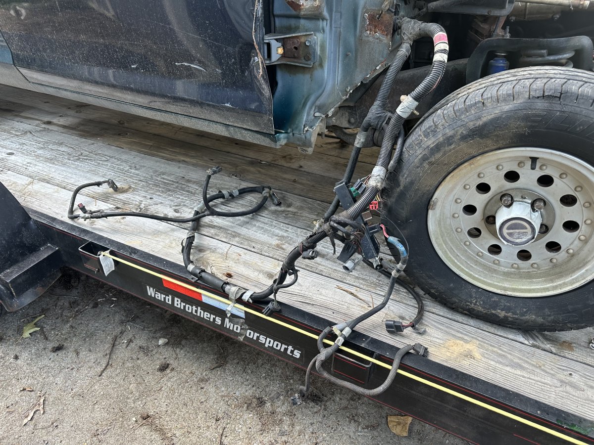

Wiring unfolded and removed.
The “Headlight” harness
Harness coming from the PCM

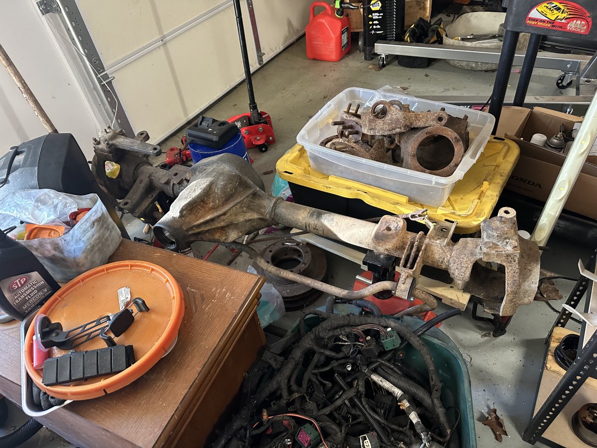

The 79 D60 front I will be using.

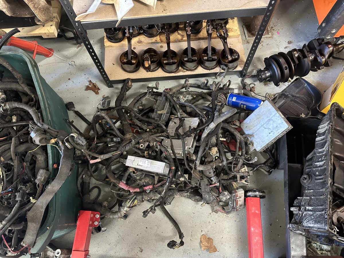

My 5.0 Harnesses. There are 2 of them. One is PATS, and one is not. I will be using both if I need splices or connectors.

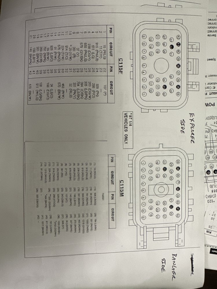

After looking at the harnesses last night, I’m thinking of making some “adapters” for the harnesses.

Printed out some wiring diagrams for the 97 Explorer and 92 Ranger harnesses I will be using.
….and now I’m as confused as a baby at a strip joint!! But it’s ok, I’ll settle down and figure it out tomorrow.

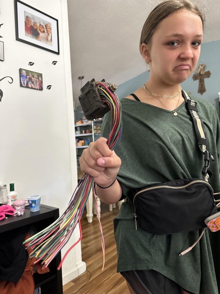

Got the 03 ranger plug that I harvested down to where I can see each wire, even though it’s still dirty….And my beautiful daughter is quite happy to hold it for me.
With the help of my wife and her scanner, I got both sides of this harness on one sheet of paper. To ease the confusion. If you’ll notice the circuit numbers are all *ALMOST* the same between the two, even thought a lot of the wire colors are different.

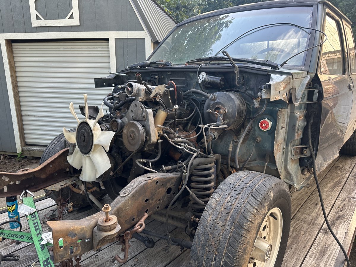

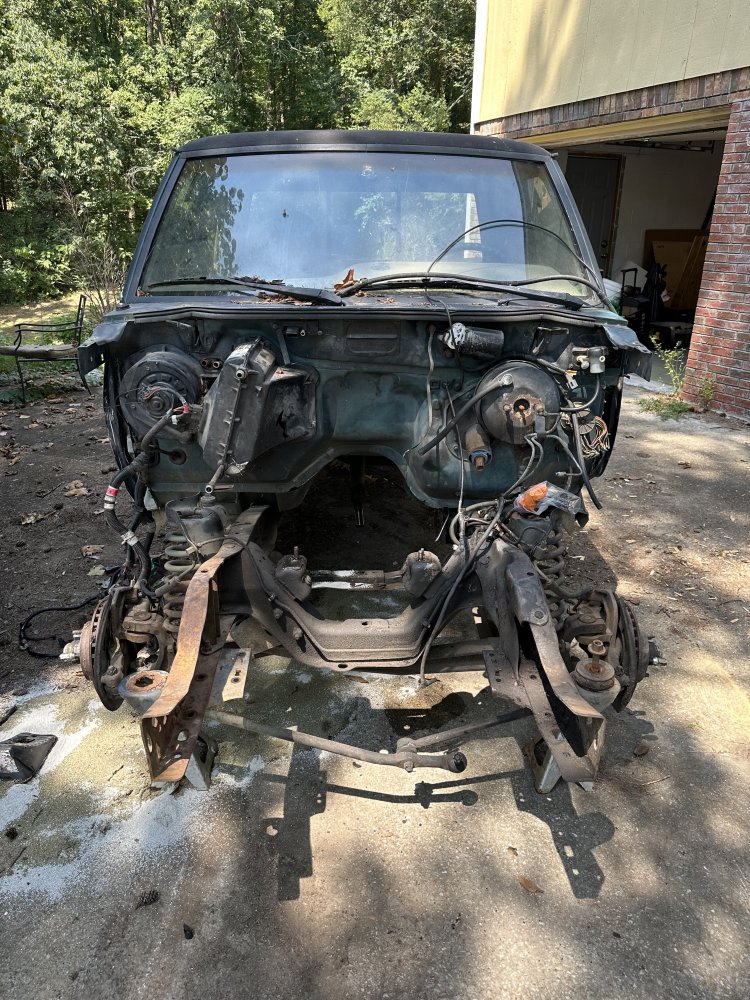

Stripped a little more off the truck today in preparation of pulling the motor and trans.
Labeled a few wire pigtails, and confirmed that the 3.0 is, sadly, locked up. I’m gonna inspect the trans tomorrow.

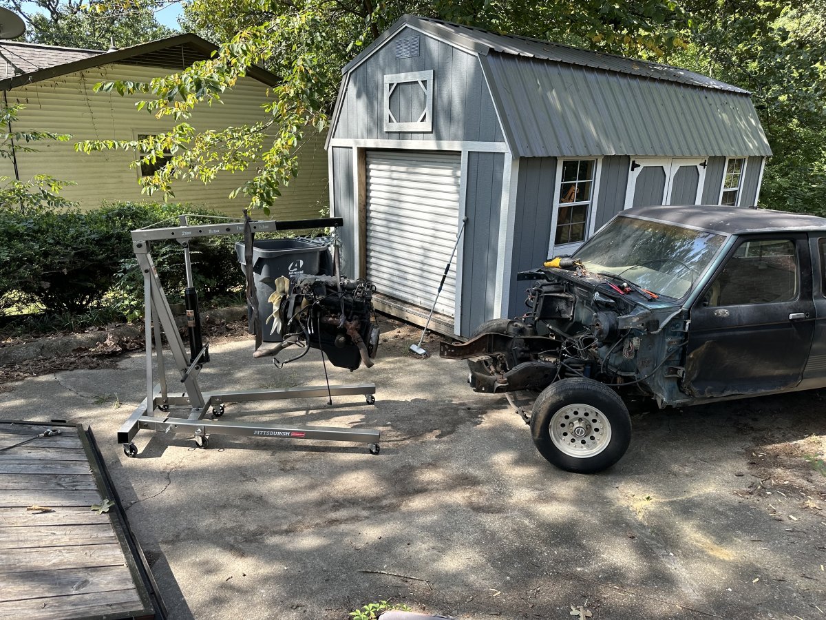

Out with the old 3.0
(Free if you want it!! There’s an Ad in the “Free parts section”)
(I’m keeping the flywheel and bolts though)

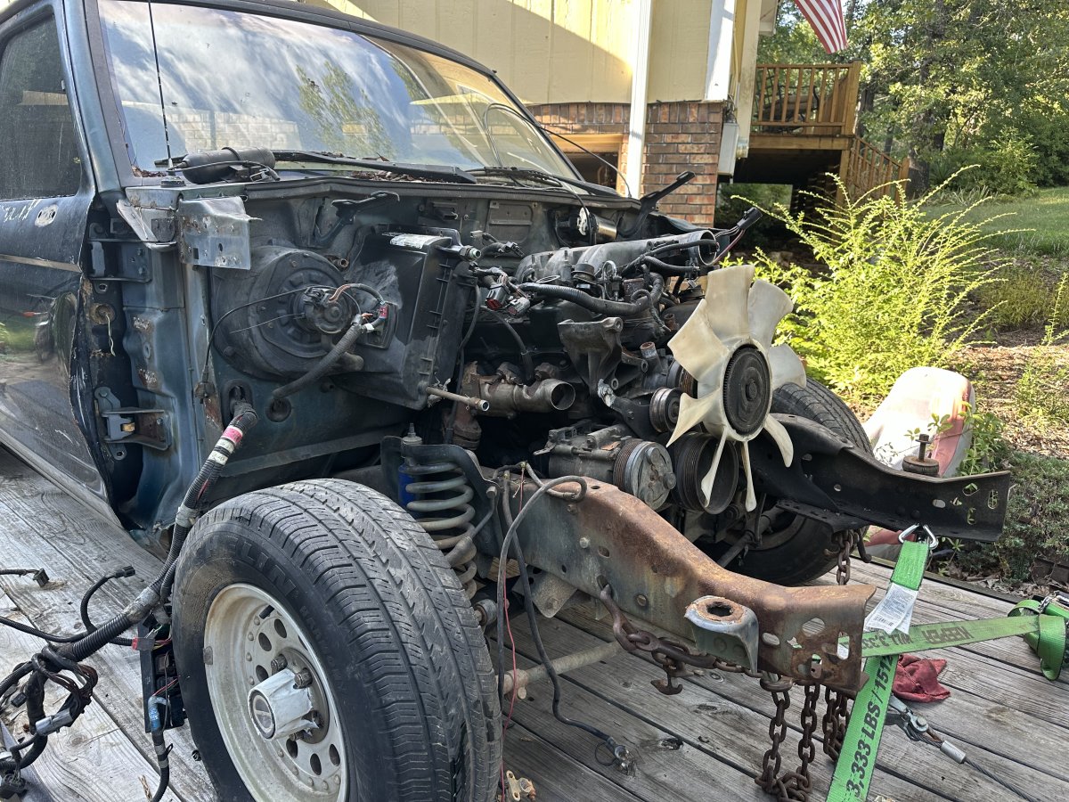

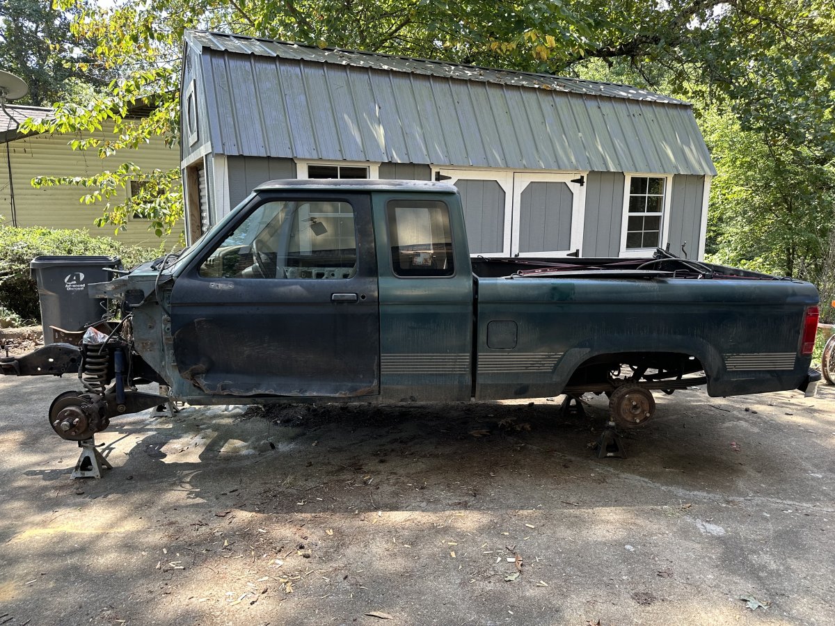

Motor and trans gone. Gotta beat the pinch weld flat and modify the A/C box while it’s out.
Pulled the rims off for another truck I got (89 Ranger ext cab, 2.9/auto, 2wd, manual windows. Even has the factory cassette stereo. Nicknamed “Old School”).
Gonna pull the Steelies off of Old School and swap the tires onto these rims and vice versa and then make it a roller again.
