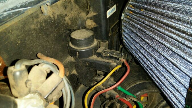

There are two hard plastic lines that go to a thing on the passenger fenderwell.it makes an odd noise when the motor is running bad....anyone know what it is?
Picture?? There is a lot of stuff going to the fender well.

Canister on rad support or fender well could be part of EVAP system, it may make a vacuum type noise as engine stumbles, and could be part of the problem if EVAP solenoid is stuck open, so it is a vacuum leak of sorts

this is the vacuum thing i was talking about that makes the weird noise...also makes a buzzing noise after i shut it off sometimes. ..
mine was doing that same thing. i have an 86 b2. i just blocked the egr and disconnected those hard plastic lines. i unplugged that dodad too. from what i feel it didnt change anything on the motor or how it runs.
ford was having such a problem with the egr and knock sensor. they just deleted both from the system in 88 and up. lmao im still trying to locate a 88 and up computer for mine. that way i can just remove both components.
im not sure of a fix if your wanting to keep it original, but you can get one from a jy or buy new. make sure your egr is cleaned of carbon and the port.
