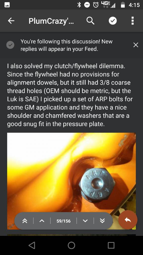

The ones I used are actually some GM application. I have a Luk flywheel with the pattern for both the 10" and 11" cover
The flywheel used 8mm bolts where as the OEM would have been 5/16
The ARP bolts have a slight shoulder to center up the cover

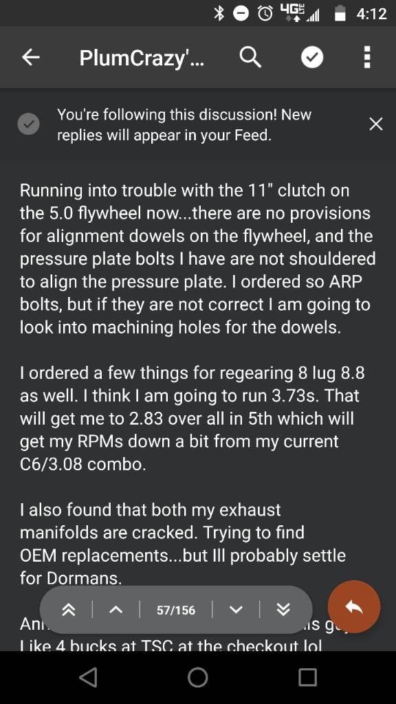

Here are some screen grabs of information from my F150 thread
Sent from my Moto Z (2) using Tapatalk
Here are some screen grabs of information from my F150 thread[/IMG]
No dowels, standard threads. Clutch is a Luk just like yours.
Your screenshots are a goldmine, thanks!
