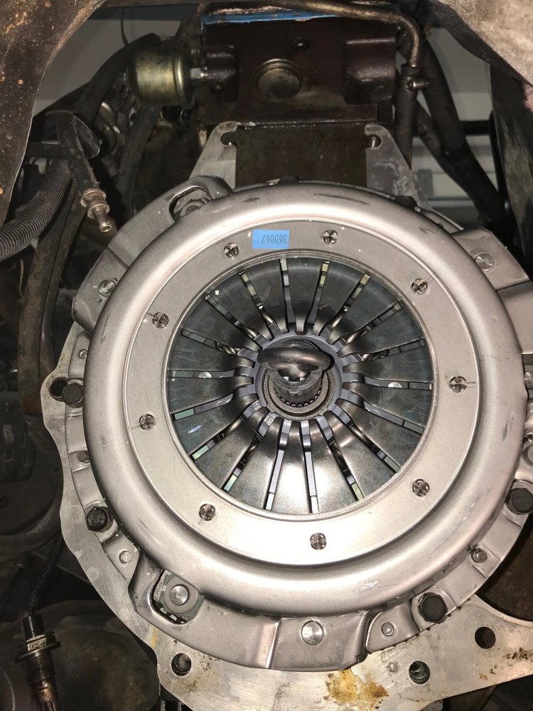

And finally: 1) Just cause I'm a rookie at this, I have to say: I swear I put the clutch in correctly. Flat side against the flywheel and the higher-side fitting into the bulge in the pressure plate. See if you can tell from the pic?? 2) Its a 23 spline and the old clutch is 8-7/8". According to RockAuto, my new clutch is 9". But it came with the pressure plate and bolted perfectly to the flywheel. Also, the kit's dorman key fits the old clutch perfectly. So I'm fairly confident its the correct part (was 100% certain until this strange clutch-not-working.... now, who knows?)

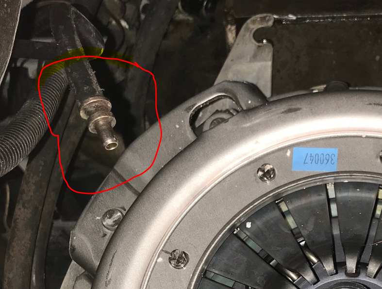

Thanks, but it sounds like you are referring to the newer quick-connect style, yes? The old style simply has a metal fitting that slides into the slave cylinder and is held in place with an "R" clip. With my truck, if I disconnect, there is nothing to stop the fluid from draining out the bottom of the hydraulic line (see pic). If I push the master cylinder rod, it will simply squirt fluid out the bottom. I've done this, but it is certainly possible there is more air in the master. I'll do it again.
Anyone have experience bleeding this style of master cylinder?
