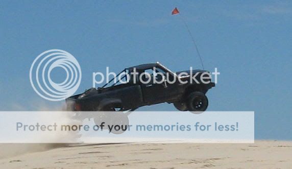

I've got a good example of when cut and turn is better than drop brackets.
The sand spray is from my drop brackets biting into the sand in compression. I want to go with shorter brackets and a small cut and turn.

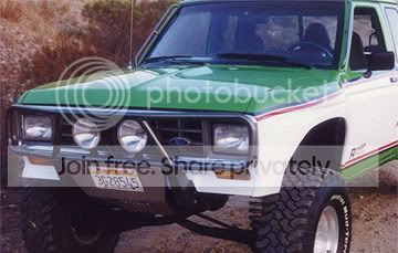

I was looking at my bumper design and was thinking it might be a little front heavy, especially with a winch. So I was thinking of doing something like this but with a front receiver, so I could still use a cradle mounted winch.
According to Solidworks, my bumper weighs 62.67 pounds with .120 wall tube, plus a 100 pound winch.
Im also liking the Gen 1 prerunner look, rather then doing 2007 front conversion.
