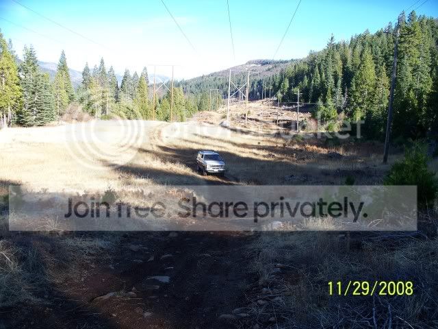

Just to give you guys an idea of the places I wheel. Not alot of time is spent up close with rocks and trees, its pretty much wide open. But of course Iv only had my truck for about 4 months and only been out on the trails a couple of times.

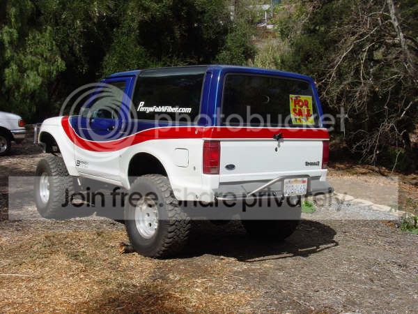

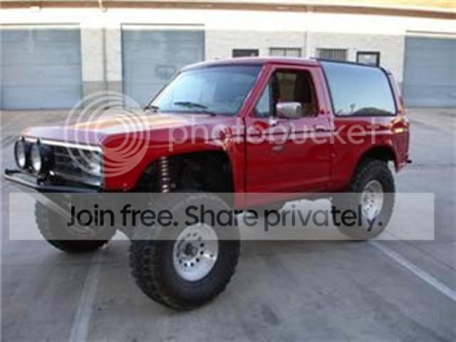

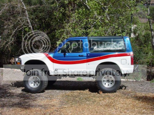

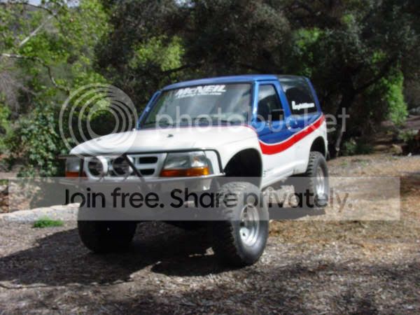

Now you cant tell me that the B2 doesnt look sick with the fiberglass. But right now Im going to focus on getting my 4.0 Liter built and in:icon_thumby:. Anybody know what kind of performance parts are available for the 4.0? And where to get them?

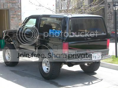

Here is a picture of mine.
I would think you being in Northern Cal you'd probably want to check out the famous Rubicon trail up near Lake Tahoe some day. Awesome trail (although a little crowded at times).
I ran it a few years ago myself and thoroughly enjoyed it, real pretty up there in the high Sierras.
Actually that picture wasnt taken too far away from the Rubicon. Maybe 50 miles as the black bird flys. Same distance from my house to either place.
