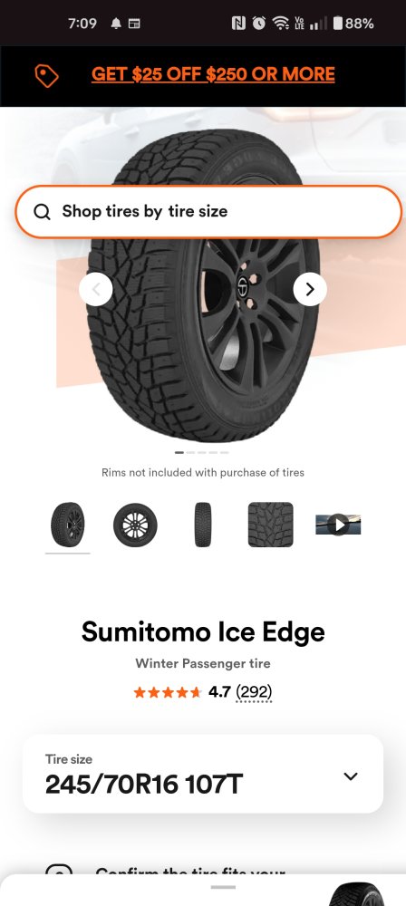

How about 245/70-16, this might be a good compromise, to keep them close to what they are now? Id like to get skinnier tires for the benefits you guys mentioned but obviously, the skinnier you go, the shorter the tire since 70 is as large as the ratio goes on the snow tires I can find.
Looking at these Sumimoto tire and the 245's are $115 each vs. $170 for 265's so that's a plus as well!
Would only lose an inch of height so the truck shouldn't look comical with the few inches lift I have.

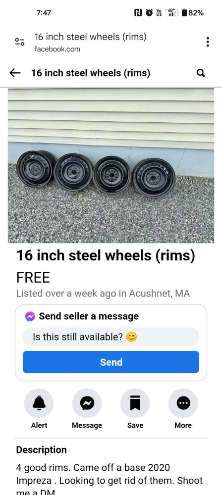

A wheel is a wheel is a wheel when it comes to a winter set.
Save some cash and find a used set of whatever will fit locally on Craigslist or marketplace. 5x100 is an extremely common bolt pattern.. id be more than surprised if you couldn't find a set of 4 used steelies for 100$. Could probably find a set of alloys for not much more.
If your dead set on buying some *new* wheels though... buy whatever you think looks cool for a SUMMER set.. and just run the wheels you have now in winter.

Will do, nothing good close to me at the moment but I'll keep my eye out. There was a decent set of 16" steel rims on there but they are two states away and came off a Subaru Impreza. The point is though, it's definitely worth looking! Thanks!
