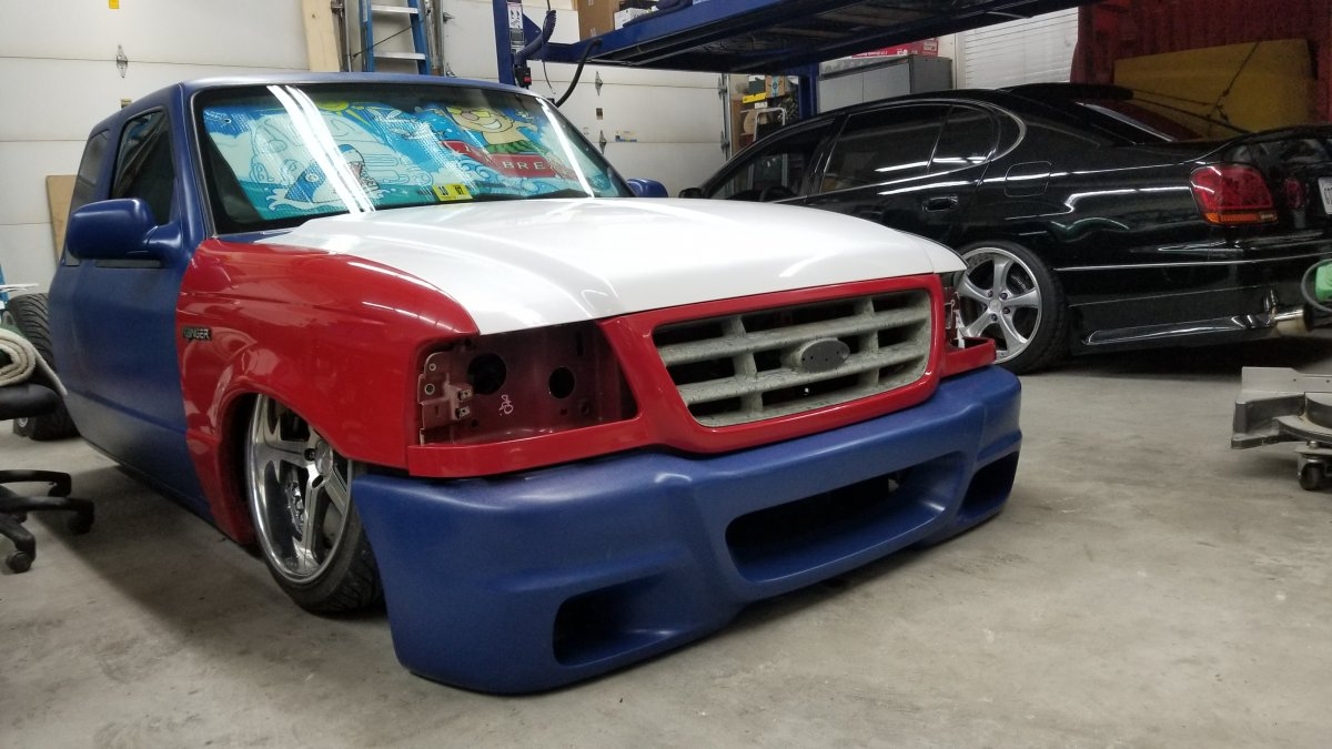

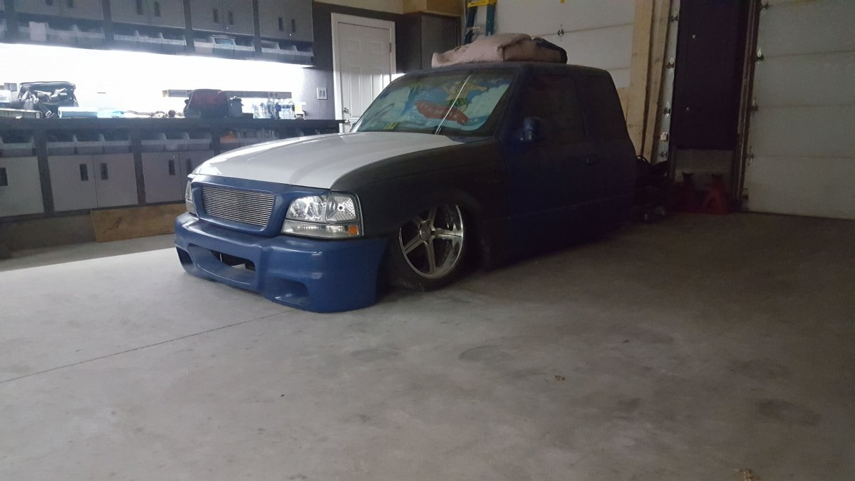

Here is my 2000 with both a 98-00 grille/headerpanel and a 01-03 grill/headerpanel.
The OG fiberglass PowerDome/Edge hood fits a 98-00 I've done it a few times and one of my rangers has one right now. It is a simple bolt on. The gap is tight to the grille, tighter than it is on an Edge, as the edge grille is frameless at the top.
Adjusting the hood-to-hinge bolts, the rubber spin up stoppers, and adjusting the radiator support's catch latch up to max was all that was needed, but it is a tight shut. Although there was no modification to do, the hook on the hood itself should not need to be changed or spaced down at all.
