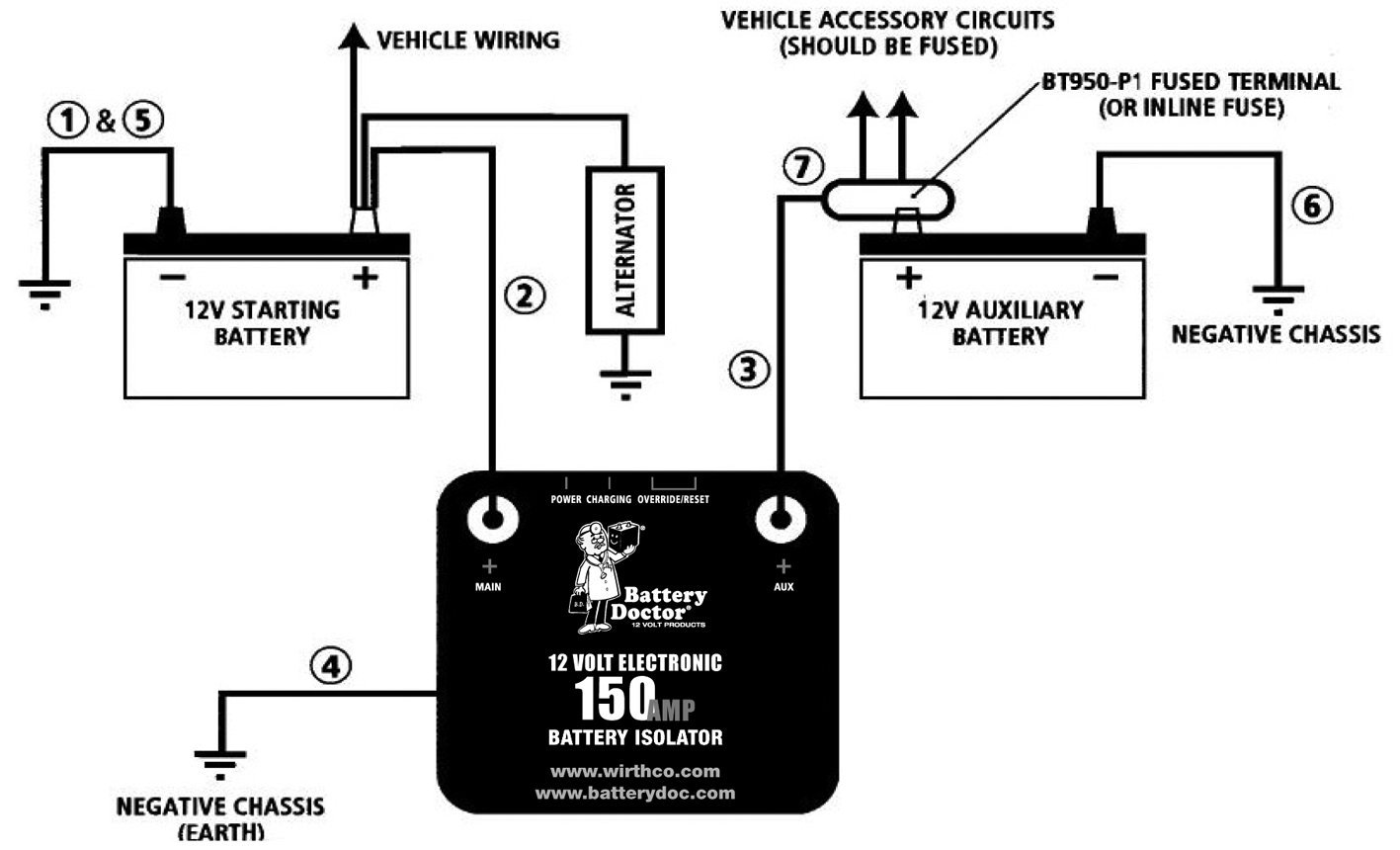

I'm thinking of installing a power inverter to the cab of my truck, while I have it gutted, so I can charge by power tool batteries. Has anyone done thins already? I am also thinking of a 2battery setup to help with charging while the truck is not running. any ideas or info will help.

two batteries with an isolater is ideal. and a jump pack if something messes up....happened to me yesterday in terrehautte...
I'm running dual batteries with a 750w inverter built into my custom center console, it was a cheaper unit but internally it wasn't as crusty as one would think. It works well and takes quite a long time to kill the battery. works great for charging tool batteries and low draw devices.
Installed a decent 2800 watt modified sine wave inverter in my snow plow truck with dual batteries. Works with all my power tools including a couple of chainsaws and pole saws. Did not run my heating systems though because of the fussy and finicky electronic control panels. Had to buy 2000 watt Honda inverter generator anyway.

Hard wire it with a switch and fuse directly from the reserve battery and install a good charge isolator. That way you never discharge the starting battery. A marine battery switch will allow you to start with the aux battery if the main takes a crap. Alot of options available how much you want to spend?

Run wires directly to the battery terminal clamps, with a fuse in-line in the positive wire, and grommets anywhere the wires pass through sheet metal. Even better is to use shielded DC wire, and ground the shielding.
