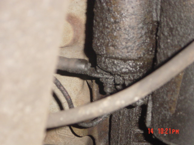

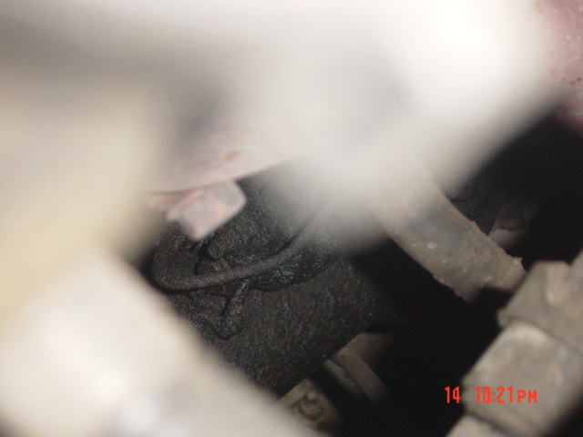

Did some searching tonight. Can't really chase the cables very far, they get lost in there. But I did find some gunk on the connection to the starter motor. Would this kind of buildup cause these problems? If so what's the best way to clean it off? And ya I know the pictures are kind of crappy, its the best I could get.

It probably wouldn't hurt to pull the wire off the starter and clean the contacts up some and get all that oil off of it.

Wouldn't hurt to pulll that started out and give it a good clean job as well there is a lot of old oil and grime built up on it as well. May save you some headaches down the road.

Cleaned the grime off the starter and ran a jumper cable between the battery and the block during start-up. Problem is still there. Is it safe to assume then that the ground to the block is good? I also checked out the connections to the starter relay and they seem fine. What's left?
