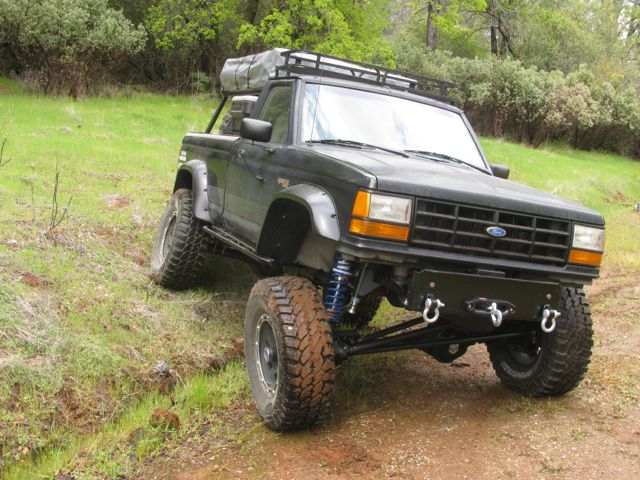

here's a pic of mine (the rest of the photos are here: http://www.therangerstation.com/forums/showthread.php?p=1220854#post1220854)
2.5 x 12" bilstein 9100 series with 250 x 12 over 300 x 12 springs and 185 psi nitrogen charge. the weight of your truck and the shock angle ,both inward and rearward, will all affect your spring rates and valving. no two set-ups are exactly the same. hope this helps.

What is everybody doing about nitrogen?
Flexfab do you have any pics of your air bumpstops and the pads they hit a the axle?
I lease a tank from a local welding shop, bought a regulator and had a high pressure hose made up at a local hydraulics shop with an all brass tire chuck on the end.
