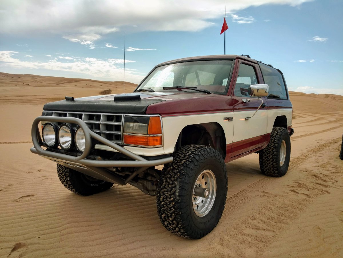

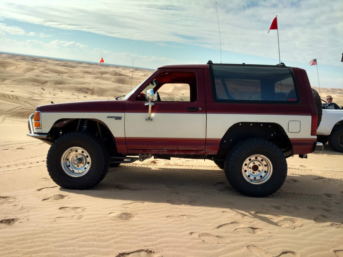

My 88 4.0 only need to trim the fenders so I can take it on trails. So glad I did all the work.
You snuck that one in there... nice looking truck!
Love the stance... maybe you can share what you got going with tires/wheel specs.
I also need a pair of those steps. Someday I'm thinking rock sliders with an integral step... but until that becomes reality...
Thanks Uncle Gump. It's got the sky jacker 5" w extended length radius arms, 8.8 and dana35 both done at Randy's, I love the Detroit trutrac in the rear. M5odr1, everything from a 91 explorer rebuilt, 4.0 w the Odessa heads and the comp cams 410 cam and ceramicoated headman headers and it sounds so cool. I don't care if little hp gain, the sound is perfect. The rims were just $50 steel wheels w 3" offset till I can afford beadlocks. 456 gears w 33x10.50s. Next up trimming the fenders and maintaining the lines so she can flex. Thanks for asking.
Well now I get to be envious of not only better paint... but a fresh 4.0L/M5OD. Nice job... you built yourself a keeper.
I'm looking for wheels/tires for mine. It's a sizable enough investment... I only want to do it once. They look like 8 inch wide... or are they only 7? Talking "offset" on wheels gets messy... do you know the backspace?
And seriously... if I don't put some steps on it... the wife said she was gonna put a For Sale sign in the window. What brand step is that? Maybe a part number or a link to the item?

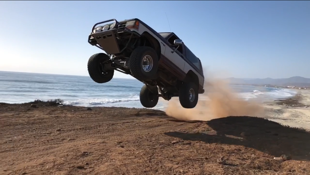

4.0L SOHC swapped... front coil over... melting in the air... dune cruiser. If you would be willing to share your build... I think @Jim Oaks would be willing to hear you out.
