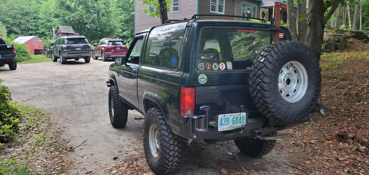

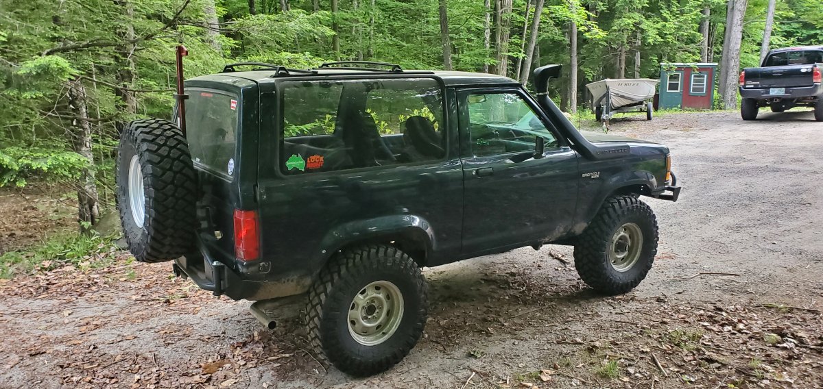

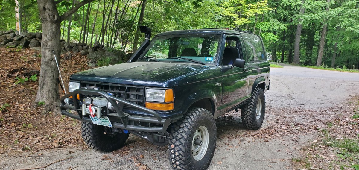

More pics to come when I get it offroad later this month.
Specs:
- Dana 35 fully rebuilt out of a 92 Explorer - 4.56 gears and an Aussie locker (c-clip eliminator spring as well)
- Fully rebuilt ford 7.5 rear end with 4.56 gears and a Lockrite locker
- 33x10.5r15 Maxxis RAZR-MT tires
- James duff front and rear bumpers
- James duff stage 1 lift kit
- POS 2.9 out of another POS BII
- 100s of hours of my pathtic life, blood and swearing

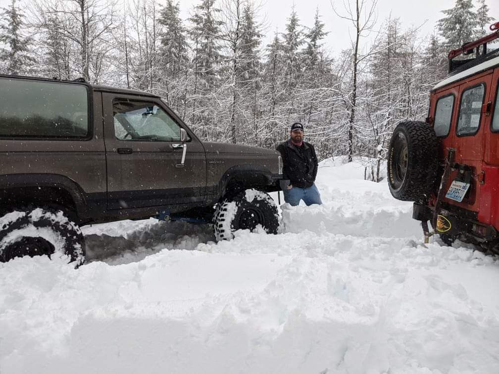

Thanks, been little bits done over the yrs. They're 35"12.5R15 Cooper STT
I had those tires on my Taco for awhile. Great offroad, good enough on road, but man did they wear down quick!
Anyhow, great build!
