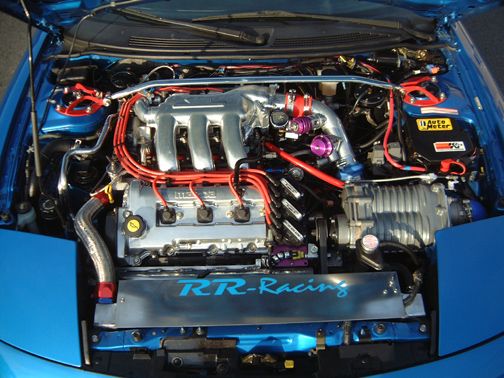

ALL of this said... again, this is nothing NEW! Usually they come, looking a little something like THIS... (this is for a Ford Probe GT (latemodel))
It just bolts above/on the "towers" (?), where the spring perch and shock go up into.... visual learner? :icon_rofl:

That's not a sway bar, it's a strut tower brace. Unibody vehicles like most newer cars and SUVs can have a lot of flex in the unibody structure, and having that brace keeps the front struts from flexing independently.
Since your truck has a (relatively) stiff full length frame, the front suspension doesn't flex like it would in a unibody car. Nobody makes a strut tower brace for a Ranger, because there are no struts, strut towers, and the gains from a brace like that would be very small since the truck frame keeps the front suspension on both sides located where it needs to be.

I'm going to answer your question with more questions. If you did this, where would you mount the brace? What would the ends attach to?
Unibody cars hang the suspension from the skeleton of the body. Theoretically, this results in less weight, and better ride comfort. The problem, is that you have suspension that is just mounted to weak sheet metal, instead of a sturdy full length frame. To keep the front suspension from caving in, or bowing out during hard driving, people add a brace like the ones you posted to improve handling.
Trucks are not typically unibody construction, because they need a strong frame to carry heavy loads, and keep from twisting while towing. The suspension hangs from this sturdy frame, so it's not going to move under stress like a car suspension would.
In theory, you could brace between the fenders to strengthen the front of the body, but the will only add weight (up front where it's not needed), and won't do anything for the suspension, because the suspension is hung from the frame, instead of the body.
