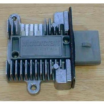

Kinda sounds like an ignition module is getting hot and shutting down.
Edit... when it quits... check for spark.
Gump is probably correct. Common issue with TFI Fords.
You'll need an ignition control module. Get a Motorcraft one. Most aftermarket ones have a 50/50 chance of being junk right out of the box.
To avoid the problem again in the future, relocate the tfi module.
I agree with the TFI module getting hot and failing. I've been thinking of making a remote setup for mine, someone has done so already and I think posted a thread about it on TRS somewhere I thought. Need to get it done before mine decides to die...and pickup a spare TFI...
FYI that TFI module is a PITA to get to, and requires a very very small nut driver to get it off the back of the distributor, or I guess you could always just remove the distributor to get to it really easy LOL.
I relocated mine. One.of the top three mods I've done. Can snap some pics.
Not a.great shoot, but didn't see this until I put the new power center in today...
Used a harness out of a escort or topaz, drilled out a old tfi module and made ir an adapter (added three wires).
EBay heat sink with a integrated cooling fan.
Zero ignition issues since.
