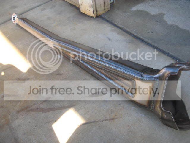

Just so you know wider is not necessarily better. Shock tuning is key as well as knowing how to drive a desert truck. You can still roll a truck with 10" per-side beams just as easy as a truck with a stock track width. Keep in mind the wider you go the longer the tie-rods will be which means weaker. If your not good at geometry with a wide truck a hint of bump steer will end your day. Like mentioned a Ford 9" is what your going to want to run. The D60 is strong internally but externally its a week point and has a cast center section. There is a reason why you dont see many on desert trucks. Depending on how serious you want to get I recommend you get a custom 9" housing. They are designed to handle the abuse and are well worth it. Here is what I am running on mine. It has 3.5" 250 wall axle tubes with another 3"250 wall inter sleeve. Also here is a pic of the new beams I'm going to put on my truck. They are equal length beams.

oh pretty :shok:. so whats wrong with the old ones?
