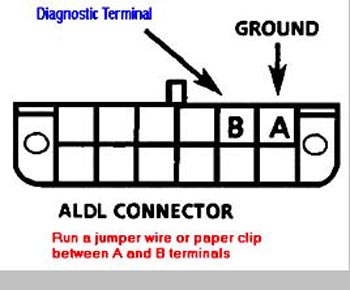

You'll want to count the flashes of the CEL. For example, one blink, a pause, then two blinks is the code "12". This is the "System Normal" Code.
Here's a link to a site with a reference of OBD1 Codes.
http://www.extreme-check-engine-light-codes.com/GM OBD1 Decoder.htm
