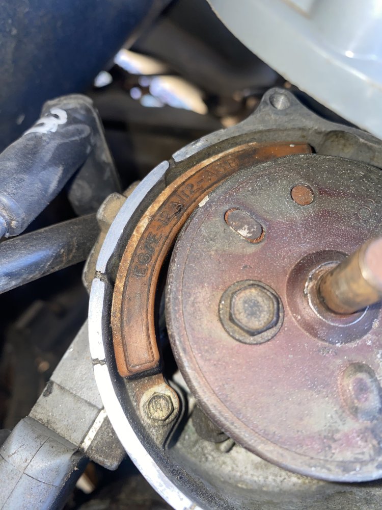

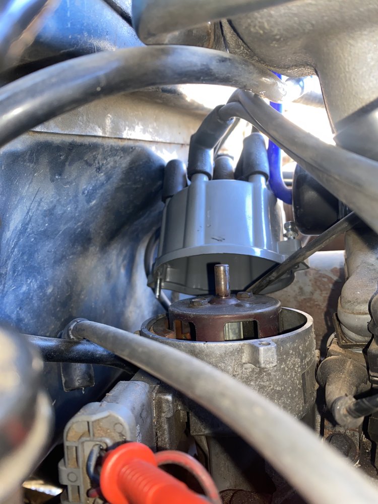

I bought a new ECU and while it seemed to solve my problems at first I'm starting to notice the same symptoms showing up but now with the new ECU it finally provided me with a trouble code that seems like it might relate to the issue at hand. The new code I'm getting is 14, a problem with the PIP sensor. From what I've read online it seems I should replace my distributor with a new one rather than just trying to replace the PIP sensor as it's easy to mess something up dissembling the distributor like that. Sounds fine to me as the distributor is likely original with almost 200,000 miles on it. What I'm unsure of is how to get the actual distributor out from behind/under the air intake and the A/C lines. It seems impossible tight to pull it out. Does anyone know for a fact theres enough clearance to remove it on a 2.9 without removing the air intake? Im trying to prepare the tools necessary for the job and if the air intake and A/C line needs to come off that makes it a whole other sized job. Also curious if anyone has any recommendations on purchasing a new distributor. I hear the remanufactured ones often have bad PIP sensors already in them?
Here's a photo of the PIP sensor in there and the space I'm working with to pull this thing out

There is a bolt on the rear side of the plenium holding the AC hoses. Remove it and you can raise the hoses . Remove wires and cap . The distributor will come out.
