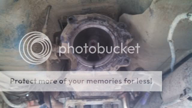

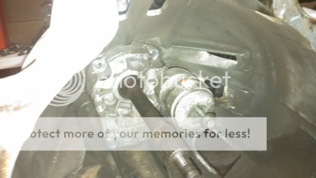

Pulled my trans last night.
Good thing I decided to pull it before the next trail ride. I would have had pick my tcase up off the ground.

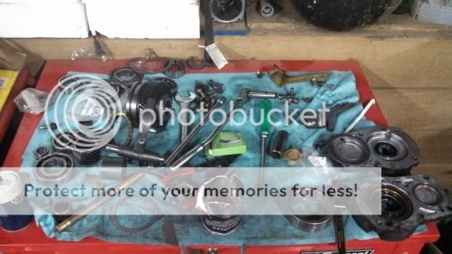

Thought I would share the nifty trick I have been using to pull the front covers on M5ODs lately...I just thread a long bolt into one of the slave cyl holes and use a cheapo slide hammer weight and she pops off in two smacks..

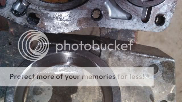

The only obvious possible source of noise I found was the input bearing race starting to go..

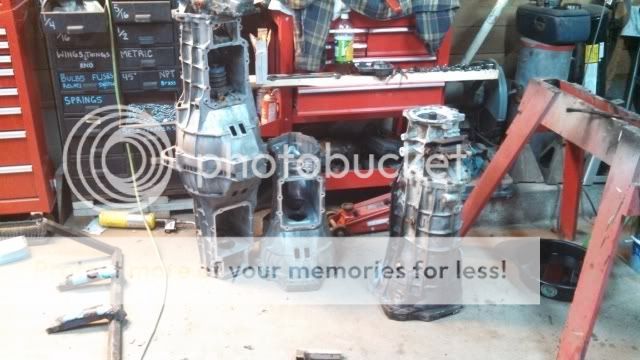

Since Im in tranny building mood lately....we picked up a looow mileage 3 leaker 4x4 trans last night to use as a gear donor for another hybrid trans for the B2.
Its an 02, so it has the updated synchros and shorter throw aswell.

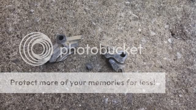

I also found some more trashed bearings from my last trans.. I get pictures of those tonight.

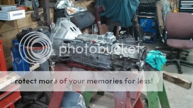

Got Humpty Dumpty back together again last night....
Turns out the updated synchros with the friction surface coating make a night and day difference. It glides right into every gear with ease. Normally the added effort required to shift due to the short throw shifter is noticeable, but not anymore. I think it shifts smoother than my Dads 07 M5OD.
And its quiet as can be. I think there is a little air in the clutch that needs to work out, but its still 100x better than before.

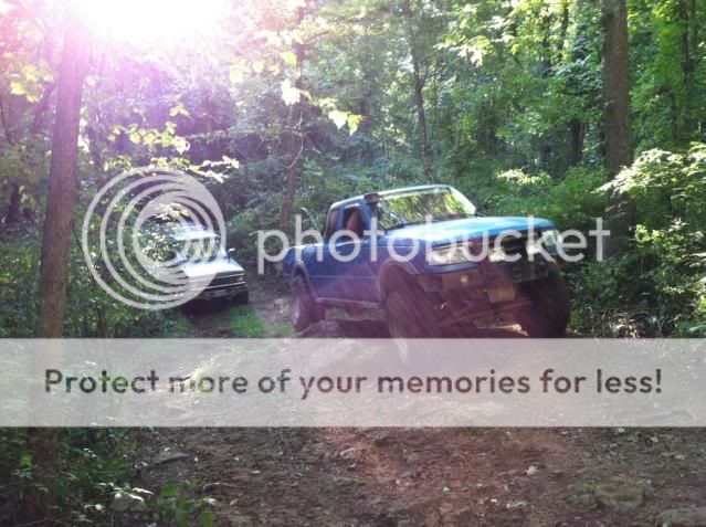

Wheeled at the Stillwell Stompers Charity ride this weekend....
Started off the day on the wrong foot and ended up in the wrong group. We were in 38s and tons territory right off the bat.
Brad popped a shaft, so we headed back to camp. Upon closer inspection, we realized his Ranger was done for the day... broke the trans cross member, blew a brake line, and tweaked the frame a little more.

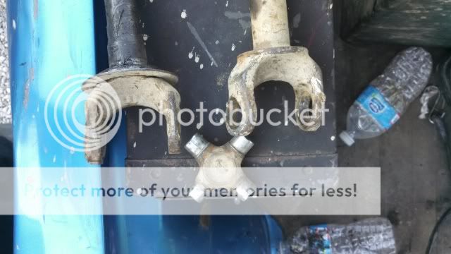

I joined up with another group (supposedly a lower tier) and had a blast. Unfortunately, all the street driving from earlier had already taken is toll on my axle joints. First big obstacle I tried ended in popping my driver shaft.
Not sure what happened... the caps were tacked and had full snap rings on them, but some how it popped apart with breaking the joint or an ear.

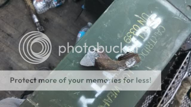

So we limped it out and headed to camp. I threw in my old EB short side for a band aide. I wheeled it all day no issues. I decided to have a go a 37 heaven before we headed out, which ended shortly after I popped the EB shaft.....
I haven't pulled the rest of the shaft out yet. Pretty neat break though, it broke the whole head of the shaft off.
