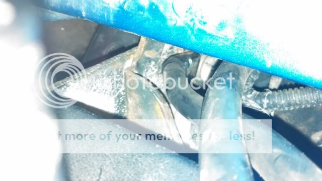

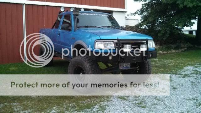

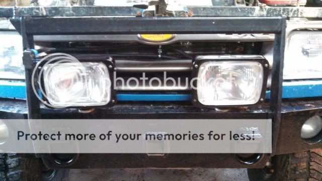

Pulled my front bumper last night to work on straightening it out and beefing it up.
I tweaked the driver side in a little which made the filler panel I had basically just tacked in for looks start to bow up. Lesson learned.... full weld it next time, even if you think its just for looks. lol
I will more than likely gusset it to the mount and maybe box it in.

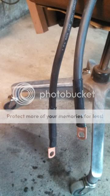

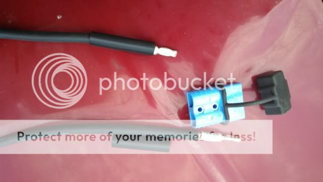

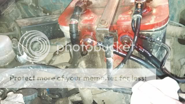

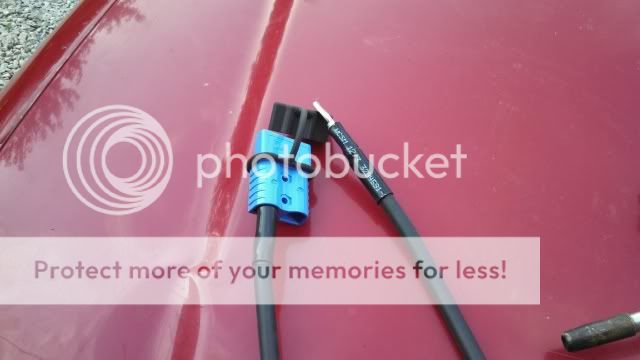

I also started my 150A plug setup. I picked up some 1ga wire and crimped and heat shrinked the contacts and popped it together.
Ill mount it up once the bumper is back on.

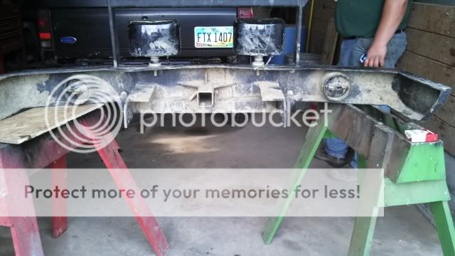

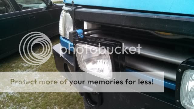

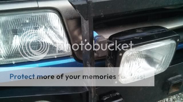

Bumper is straightened, welded, reinforced half ass painted, and bolted back on.
Mounted up my aux high amp plug, I still have to crimp lugs on the battery end.

Winch plug complete.
Chevy side posts are good for something.

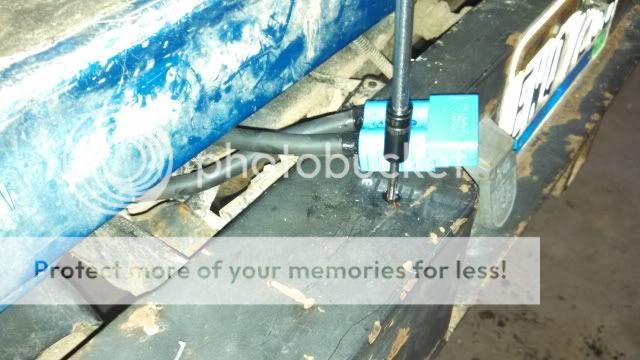

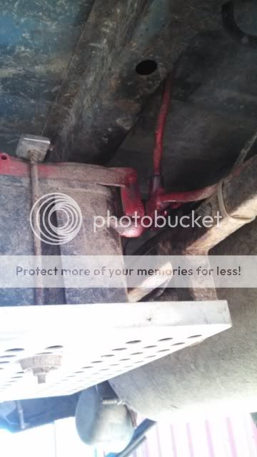

Did the rear 150A disco last night.
I ran my positive to the rear battery, and that left me with only 8" of wire left, so the neg I just grounded to a bumper mount bolt.
I drilled and tapped the mounting holes since the bumper is boxed is boxed leaving no access to put nuts on the bottom. Homo Depot sells all their small hardware in packs of 3 apparently, so I need to grab one more stainless 10-24 to call it done.
Tap sockets are the best thing since sliced bread I swear.lol
Ill get pics of the final product tonight. I plan on throwing a disco on my jumper cables too.

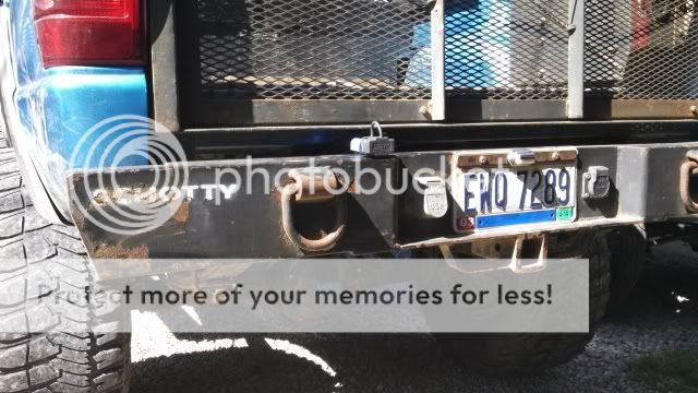

Mounted up.
Sprayed the sh*t out of it with terminal protector.

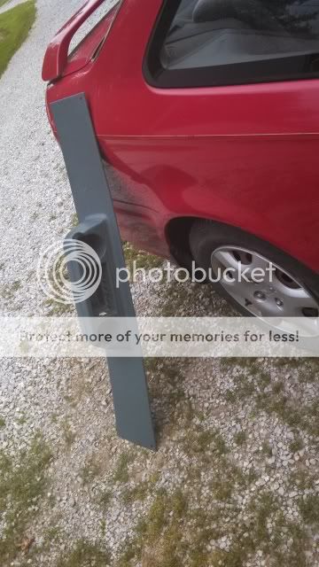

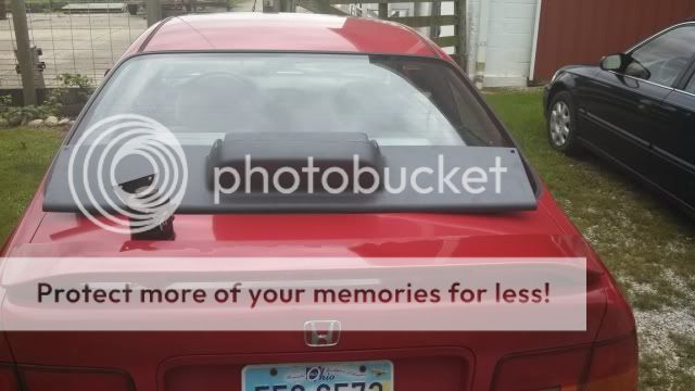

I have never seen one of these before.
A rear panel with cupholders in a supercab 2 door...
So I bought it.lol
