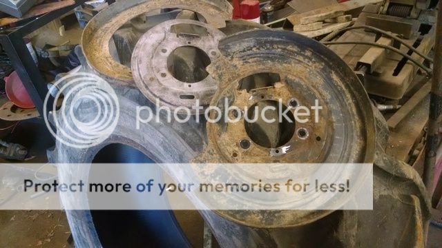

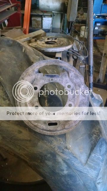

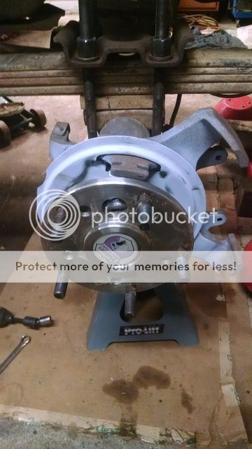

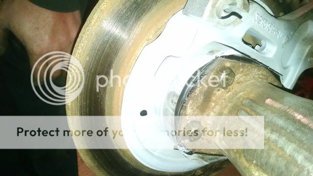

Not much progress. Did solve my issue with the semi float bearing retainers bending when torqued down...turns out the thickness of the dust shields needs to be accounted for...
I wanted to leave them off so the mud and debris would be less likely to build up in there, so I trimmed the shields down to only cover the parking brake, which upon closer inspection is required to mount the shoes anyways.
