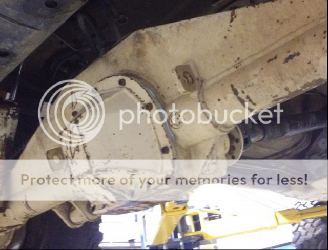

I ran across this pic the other day.....So this will be happening.lol I always get snagged on that rear lip. I did like how the stock housing had a "sump" inside though that let debris settle out, but Ill give it up for 1.5" and a smooth bottom. I saw another member one here (RockRanger maybe?) epoxied some filler plates to make the lip smoother to slide over stuff, but I like the shaved approach. I have seen the shave done a lot on the Corp 14 bolt since they hang wayyyy low, but never an 8.8. There is a lot of room in these guys that can be slimmed down without getting into the ring too.
Jb weld a magnet in there to collect debris and start shavin once u cut the bottom you can probally straighten your housing pretty easy
I have a mag drain plug in my current cover already. The ABS sensor normally grabs some stuff too.
Im pretty sure the tubes are bend right at the housing on my current axle. Im not fooling with it. I want to redo the perches, truss, and weld the tubes correctly this time. I did them on the truck last time...there was oil and dirt in there, I didn't bevel the casting or pre heat, so the welds look like a 6 year old did it with their eyes closed.lol
