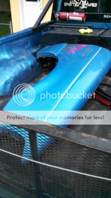

Next thing was to strip the the silly pink splash decals off the guinea pig fender.

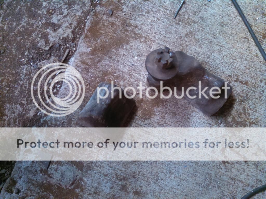

Tore the passenger knuckle down to see what the damage was....looks like I snapped a trunnion off a 760..and deformed the ears on the inner chromo.
I already have a new pair of inner chromos, but I forgot my snap rings at the house, so I just stuffed my spare EB shaft in to keep the oil in.lol

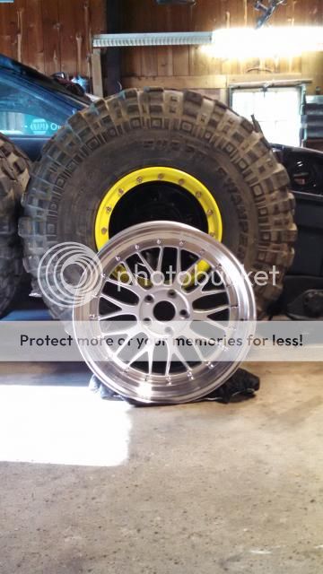

My brother picked up some new hweels for his whip..
18x9.5s...fender rolling and pulling is a must..lol

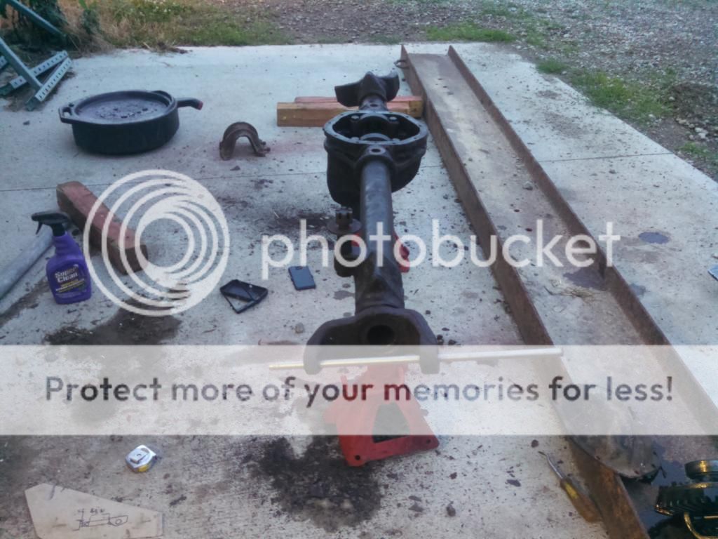

I was hoping my 150 parts would be here this weekend, but they are scheduled for Monday...so I needed something to do...

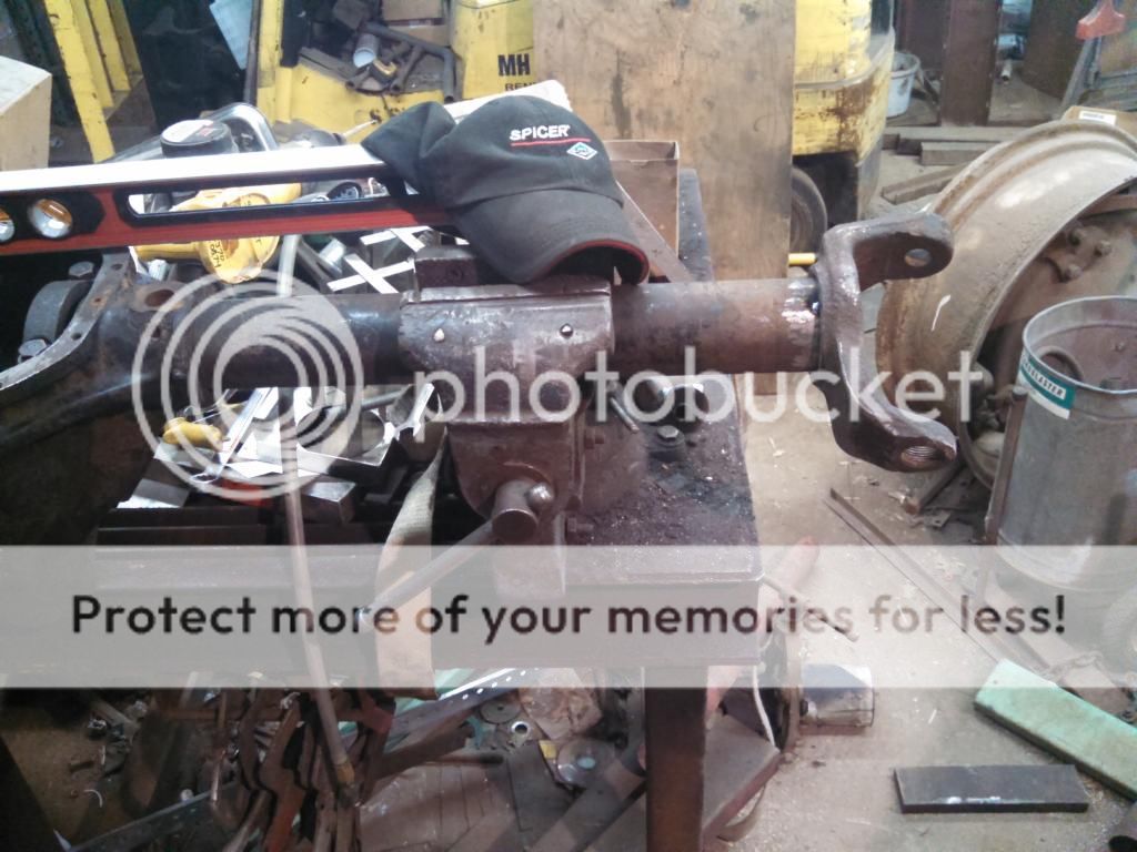

I grabbed my grinder a started working on this guy

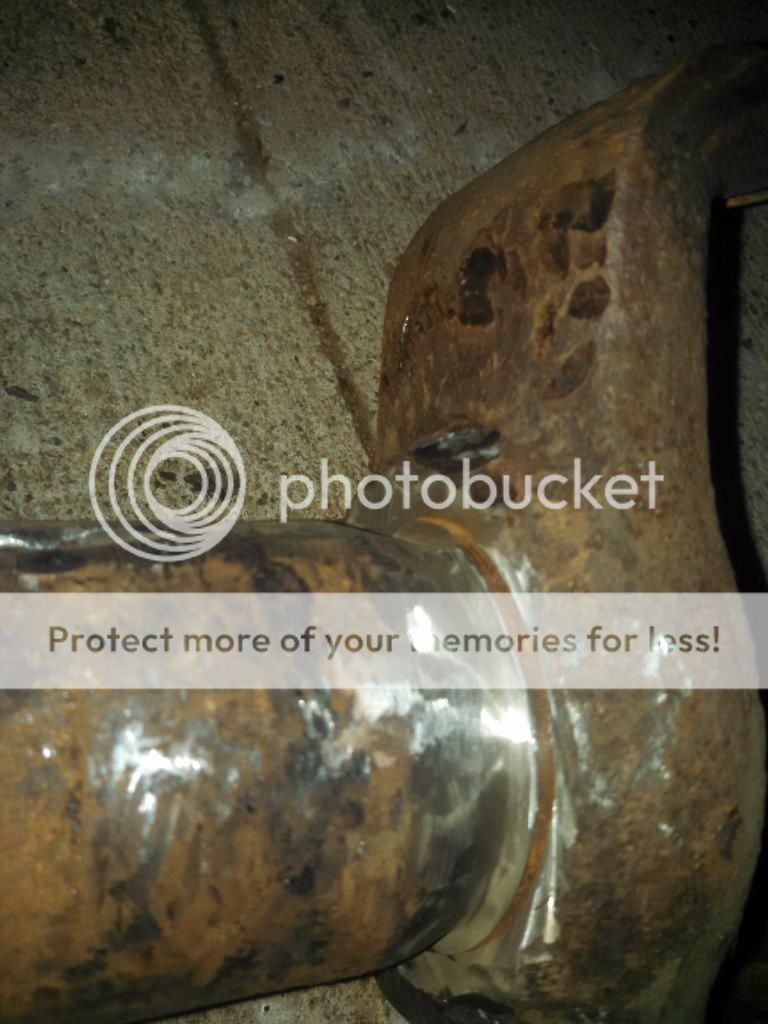

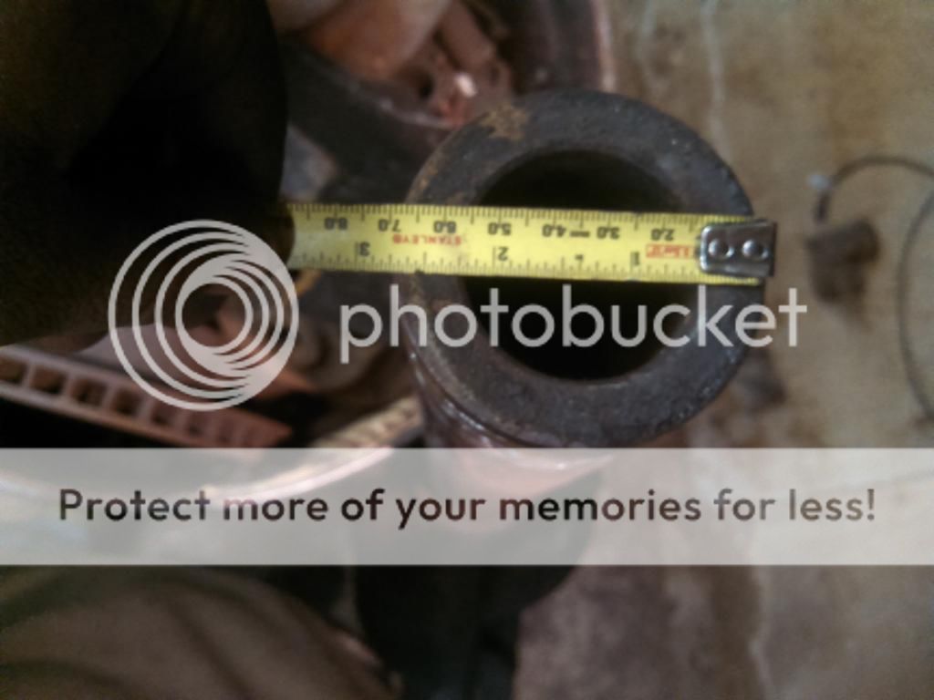

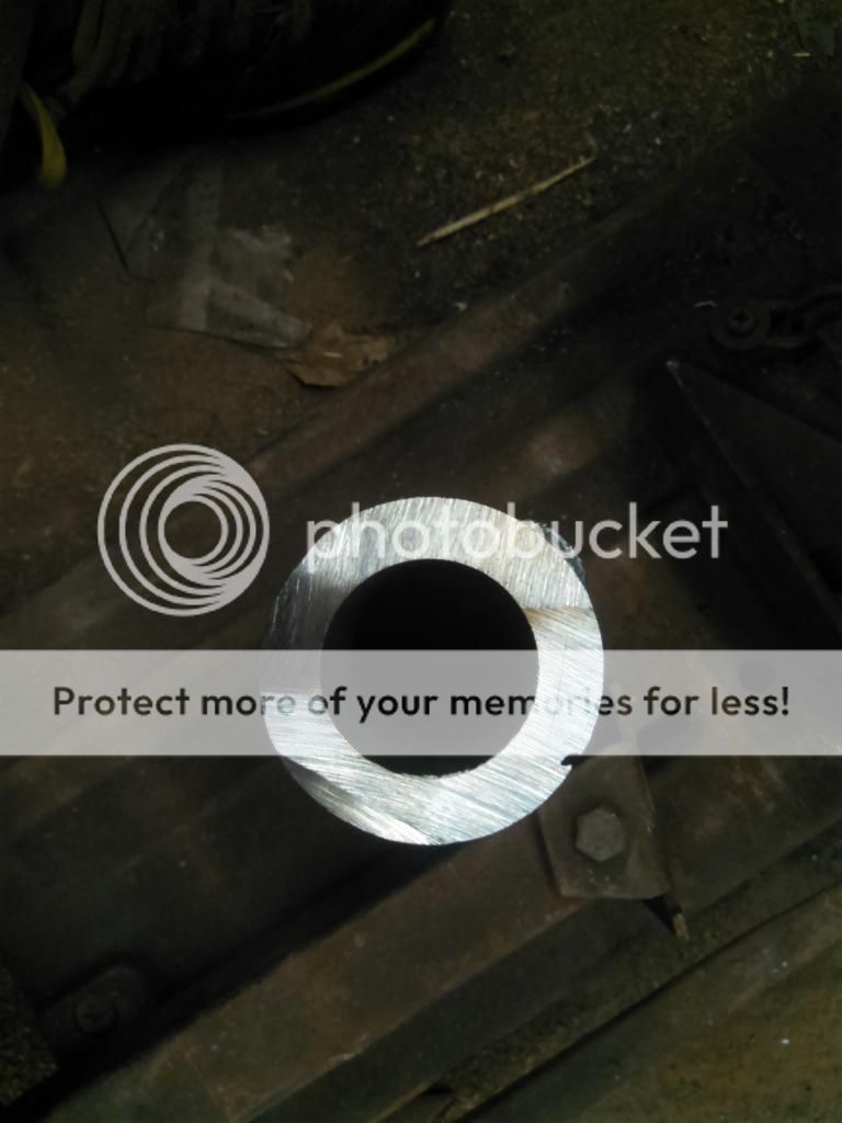

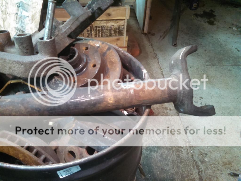

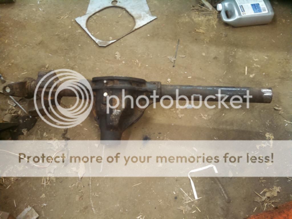

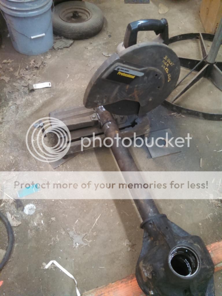

I considered getting a 78-79 axle with cast wedges for ease of narrowing, but they only have 1/4 - 3/8" tubes. I decided to go through a little extra effort and keep my 1/2" tooobs.

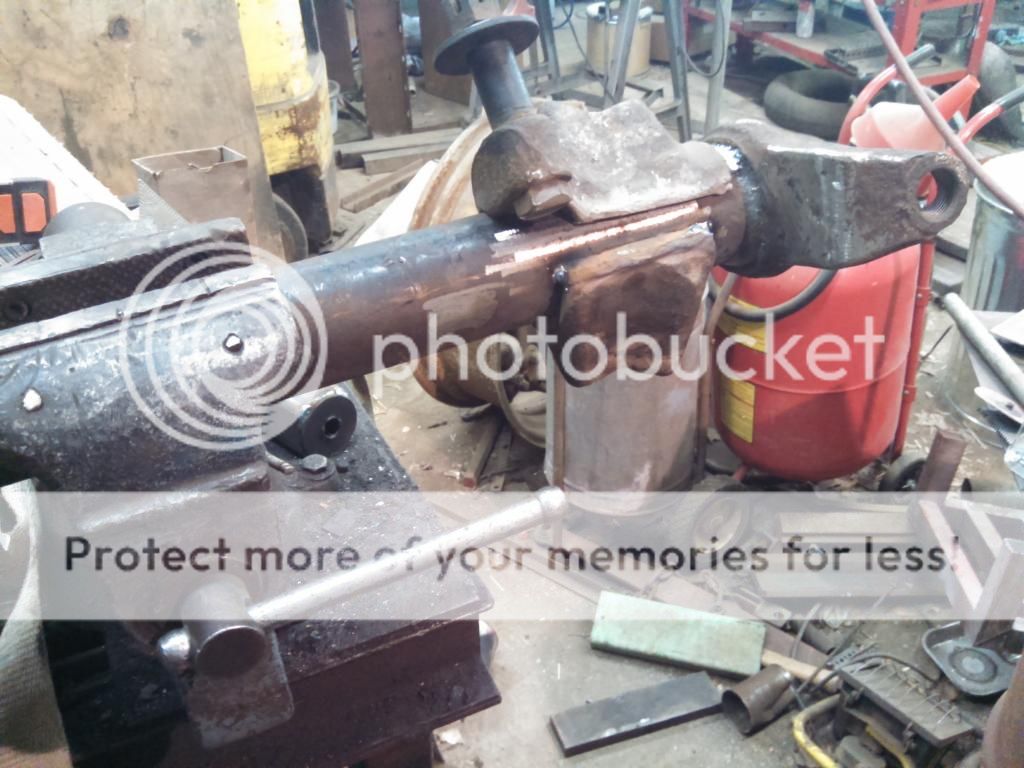

Wedges off
Inner C welds ground and broke loose.
1/2" wall

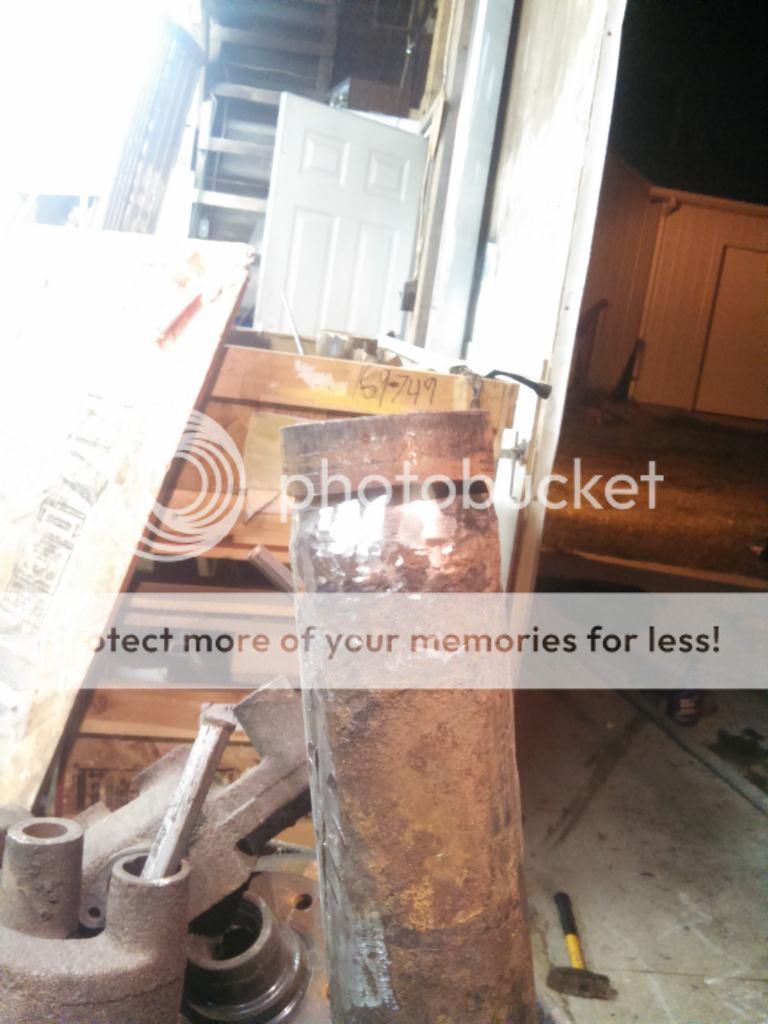

Chopping block

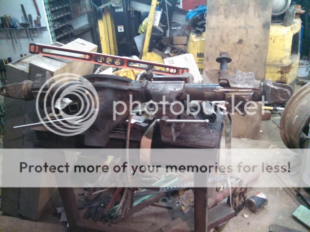

Ready for reassembly.

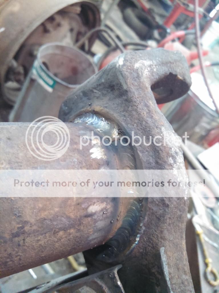

First pass.
Rear wedge on.
More pictures on the way.
