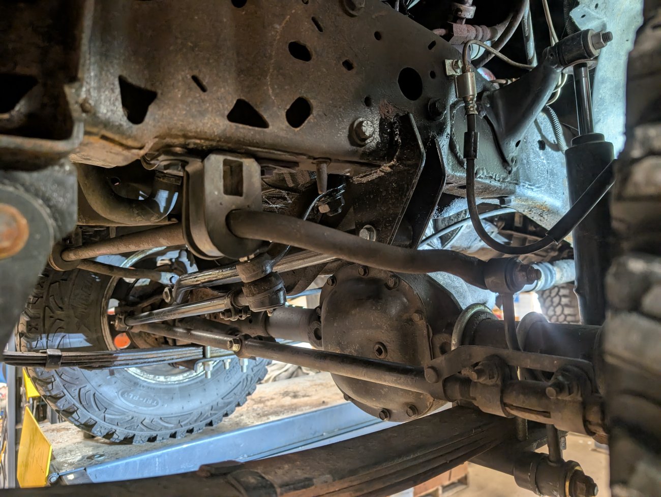

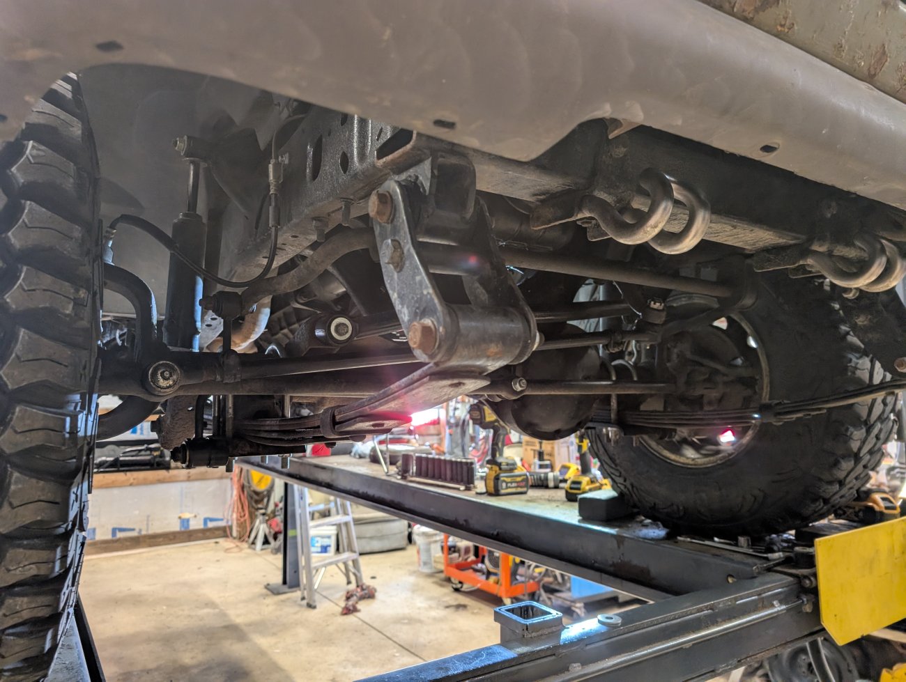

Even with the track bar this truck still doesn't drive as nice as I was hoping for. I planned to continue putting 15-20k a year on it and it honestly I havent been driving it as much because it kinda sucked on single lane back roads with a decent crown and bumps. It didnt bump steer but really took a lot of steering wheel action to keep it straight.
I have the caster set best I can while keeping driveline angles and the shackles in a reasonable spot and it the steering wheel self centers pretty well.
So I put a front sway bar back on the truck and it really made the difference. I think the only thing that would make it better would be a less aggressive tire. Now i think what little wander it has left is just like new 10.50 wide MT behavior.

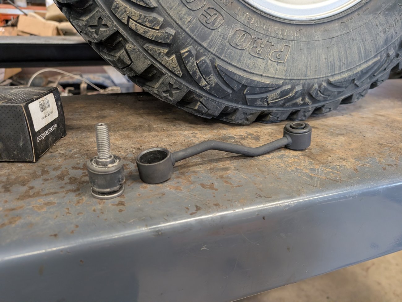

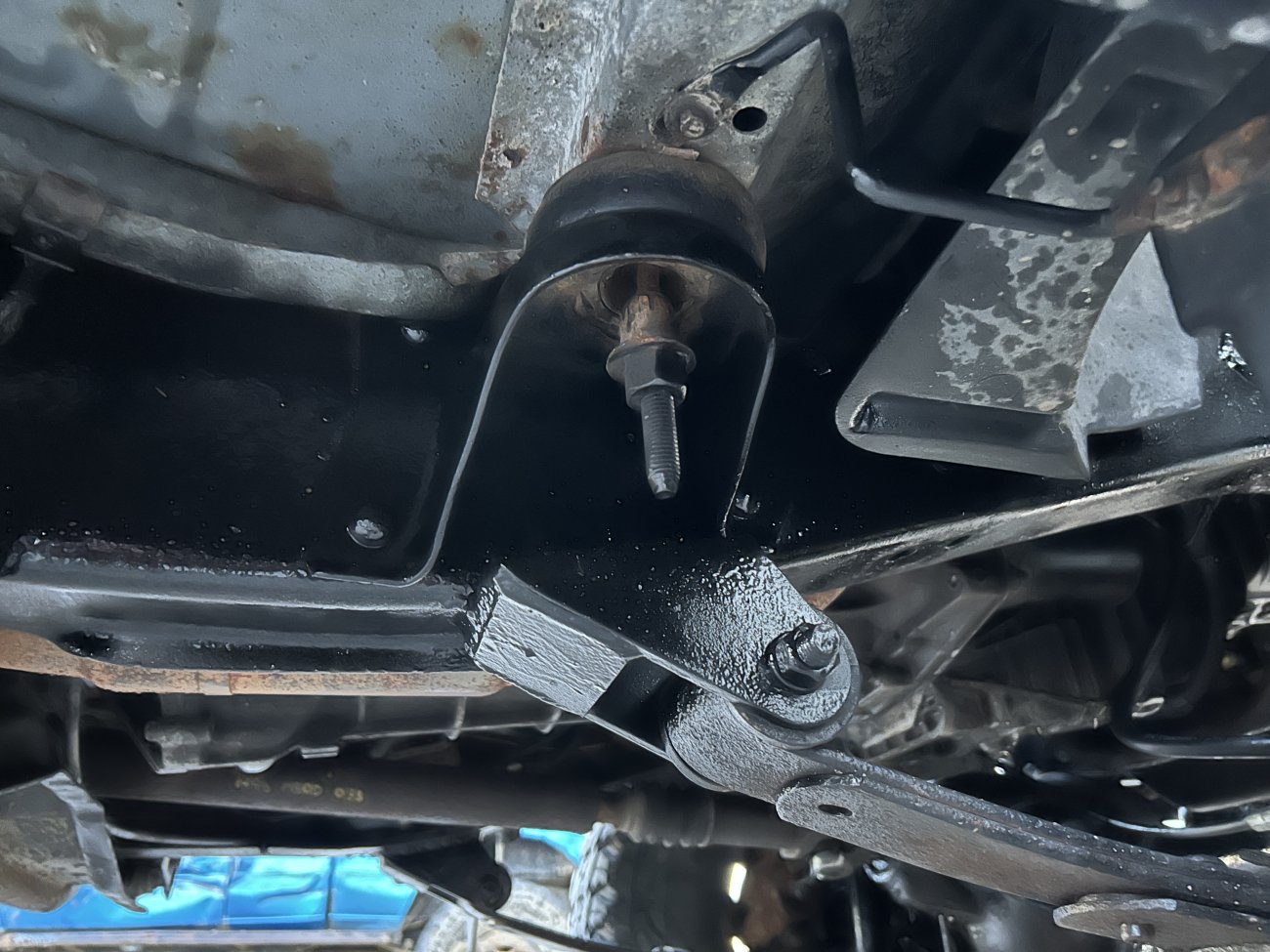

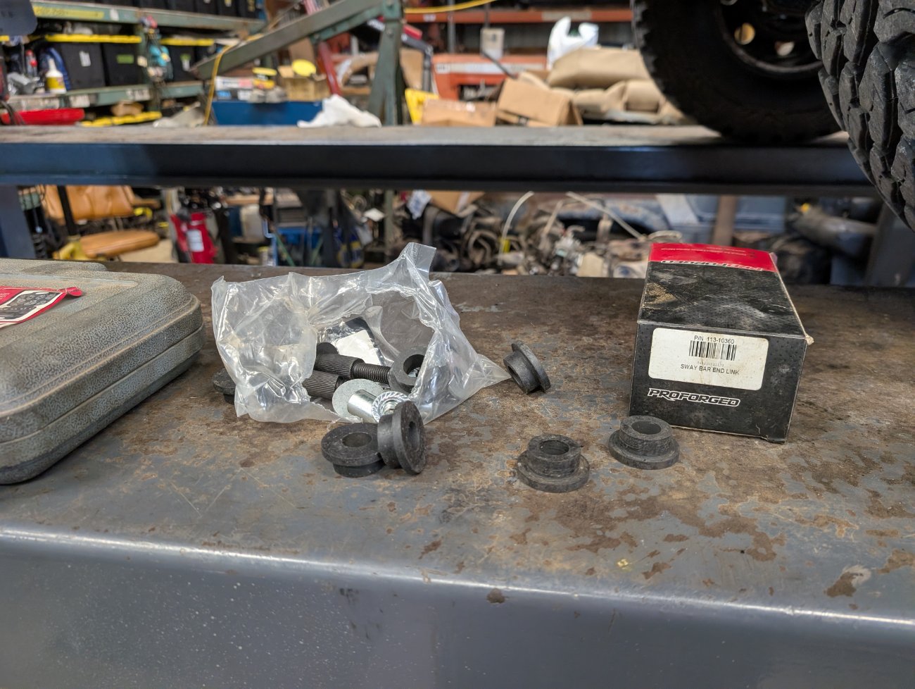

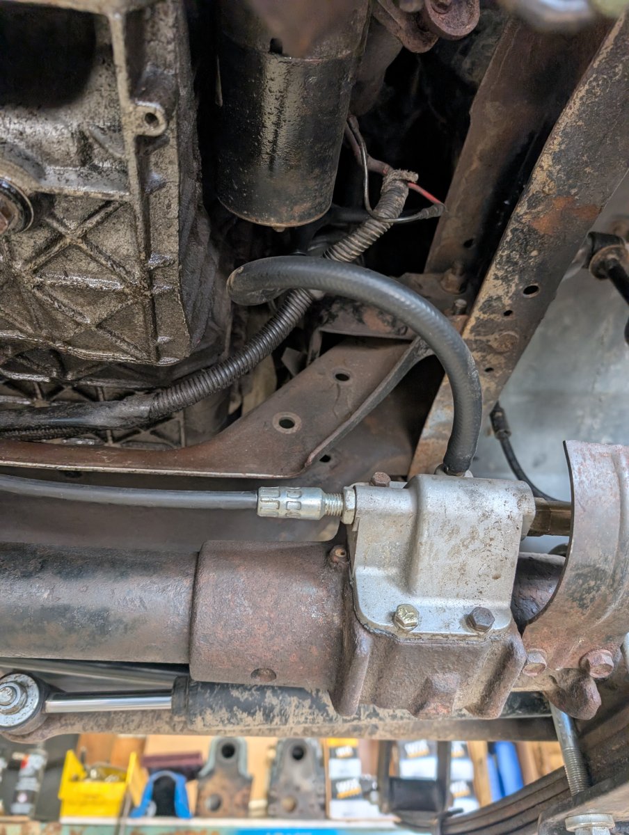

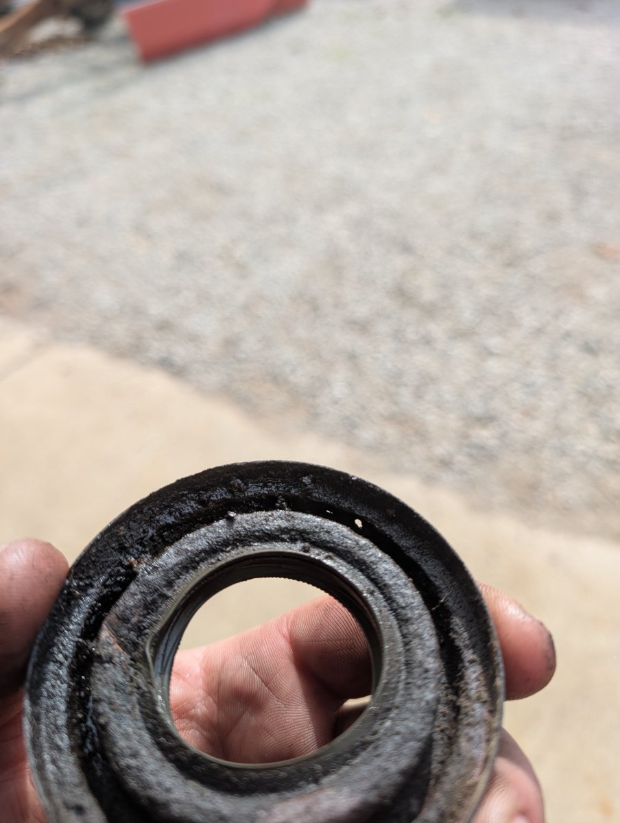

Bolted up the factory Ranger bar and mounts and used RWD Ranger rear end links with the studs pressed out. The offset is about perfect for the YJ U-bolt plate mount and the length is pretty close (ideally 1" longer, but the 4x4 links are like 4" longer). I pressed out the stud and the bushing came out with it, but I had a random box of new split type bushings laying around from my dually project.
PlumCrazy's Beater DD 4x4 SAS Build

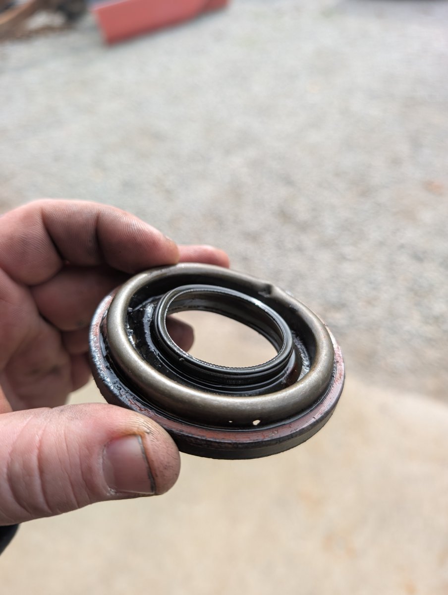

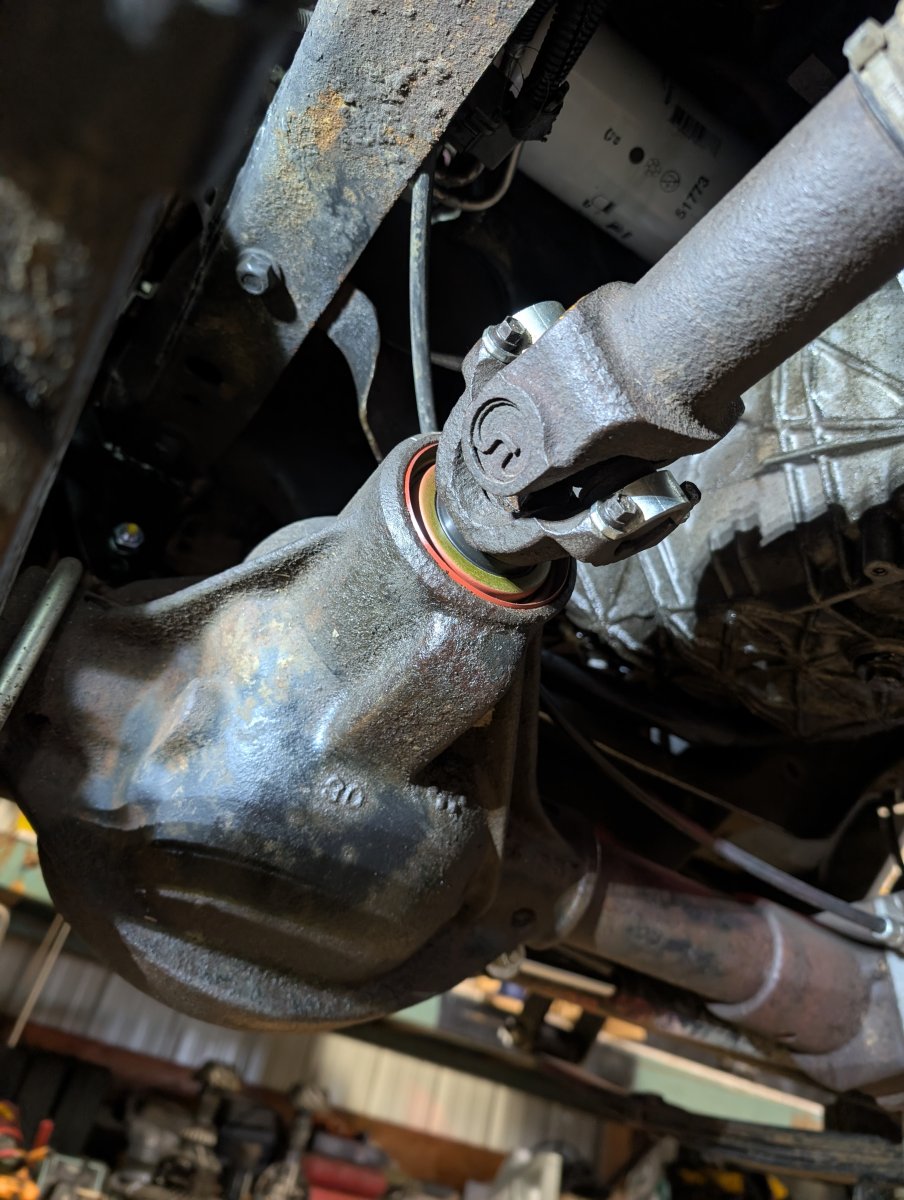

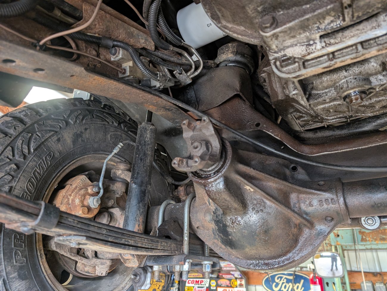

Also decided to address the leaky D30 pinion seal. It didn't make sense to me for it start leaking randomly because with the CAD it doesnt spin going down the road....turns out it wasnt leaking at the lip seal, but rather the metal casing had rusted through.
The original D30 vent hole was not in an ideal location due to the Ranger crossmember, so I used the 1/8npt hole in the CAD housing to relocate the vent tube

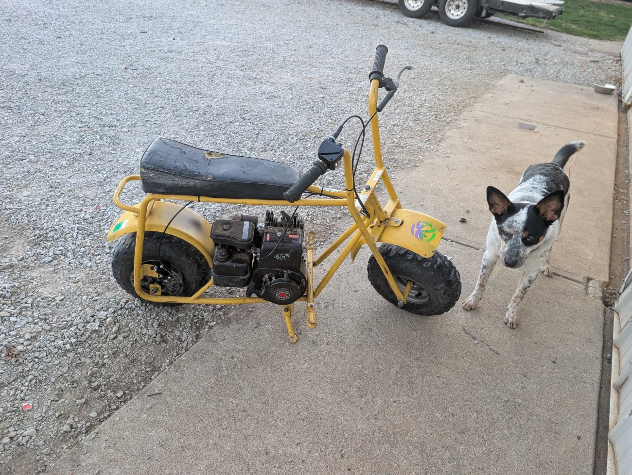

Also picked up a little side project. Snagged a nearly free Doodle Bug frame and used an engine from a free roadside rototiller to make a little pit bike. I need to rig up a headlight still, but its a ripper.

Bad ass little pit bike, my youngest son has a Coleman CT100U about that size that he's trying really hard to wear out. Mini bikes and scooters and dumb toys like that are so much fun.

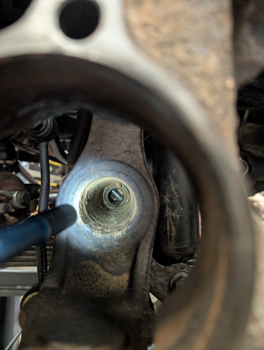

I did find some play in the unit bearings even though they sound and feel smooth. I have a pair I bought when I assumed this axle would need everything on day one, but they were okay enough to run for a while after I removed the crusty calipers and rotors it came with. I also ordered new 5-760X wheel joints and axle stub hardware for when I replace the unit bearings. Ball joints still feel fine, so at least I have that going for me.

The CT100U is nearly the same bike. Just tweaked enough to avoid copy rights lol Its a riot to buzz around on. Had it up to 35mph with the stock 70 tooth rear sprocket, so I put a 75 on to slow it down and move my fat ass from a dig faster.

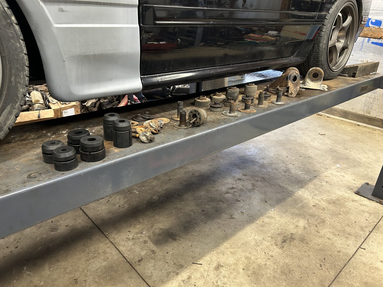

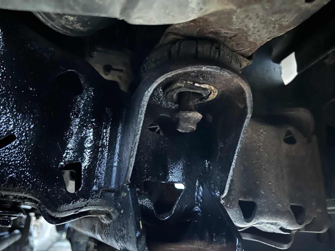

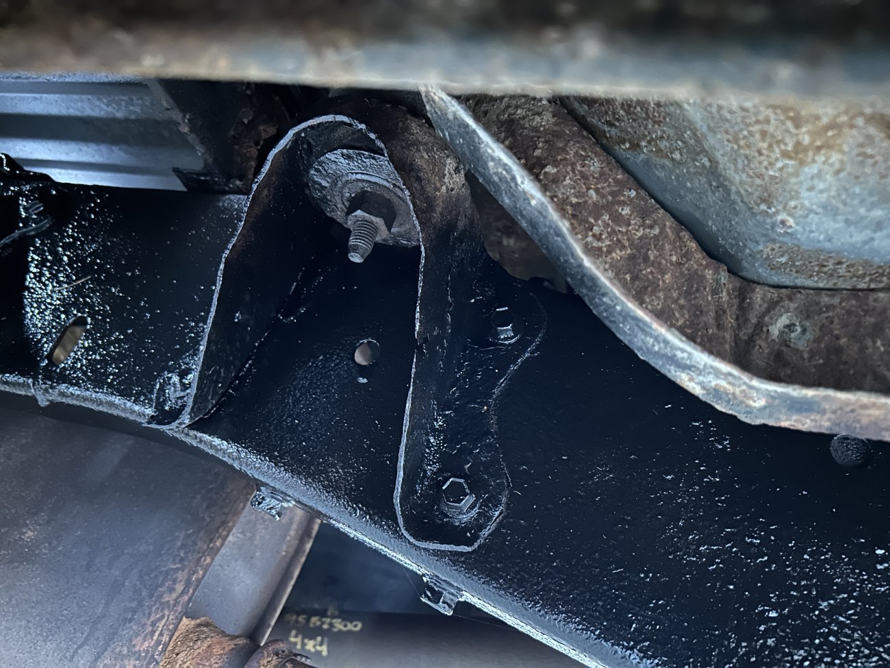

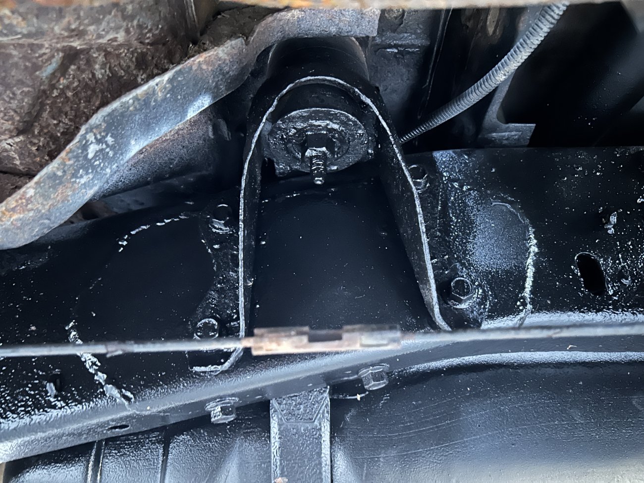

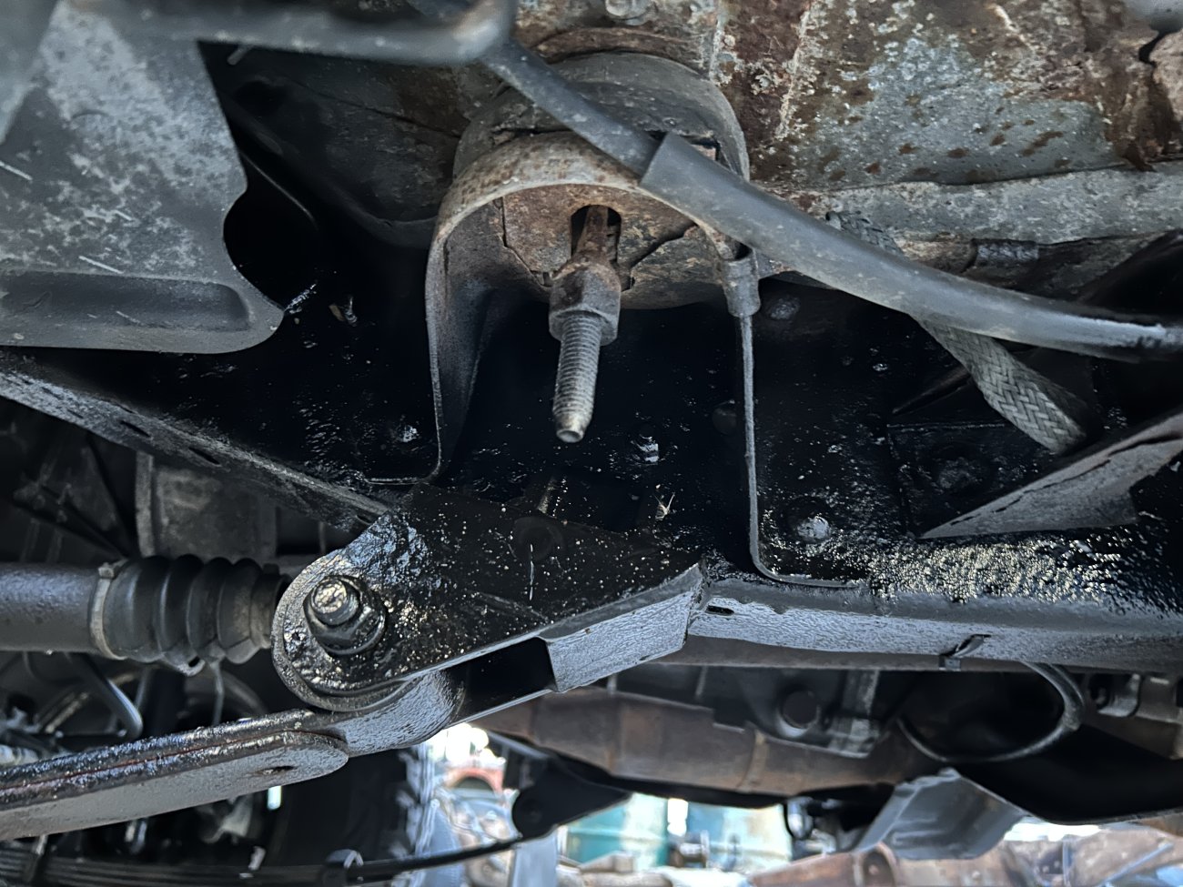

Well…I had planned to push off doing cab mounts until I swapped cabs, but of the 6 mounts…only one (DR rear) is actually doing anything. It’s bad enough that a rough bridge joint moves the cab to a new resting spot each morning. So before snow flies and I put the thing in the ditch with an ejecto-cab I’m going to have to do something

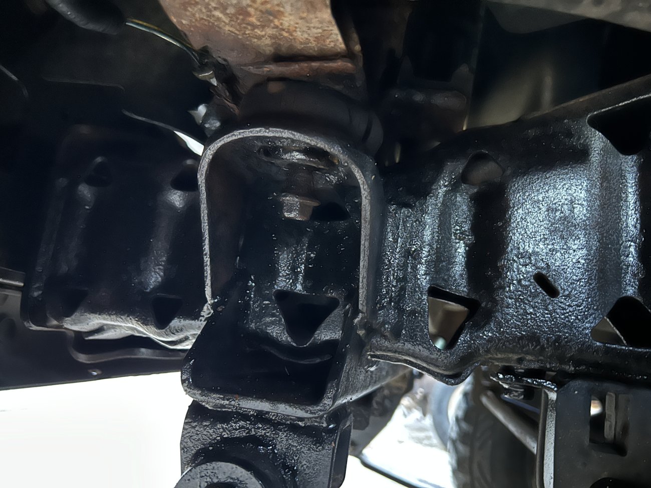

Pass core support
Driver core support
Pass middle
Driver middle (note added srcap metal to keep rubber from falling through the rotted mount)
Both rears are ok, but the pass side mount is rotted through
So I stripped the good mounts off of the frame I drug home and pulled what body mount hardware I could salvage from it and the parts truck (that will someday donate the rest of the cab).
Between those two trucks, a NOS set of prothane mounts and the mounts remaining on the black truck, I have enough to cobble up 6 mounts…I think.
The core support hardware will be a last minute deal since nothing in death row here has a salvageable pair of the inner sleeves.
Also…semi regret spraying black Fluid Film all over randomly last week
Dang...
That's gotta be the worst set of cab mounts I've seen.
Dang...
I knew the core support and DR middle mounts where shot…but with all the frame work and moving the cab around for the frame repair it broke the rust free that was holding it all together I think lol
Holy cow, and here I thought my cab made some bad clunking sounds on my '90! I think I just lost all preload on the rubber, the core support rubbers are shot but I think the other 4 are still there...

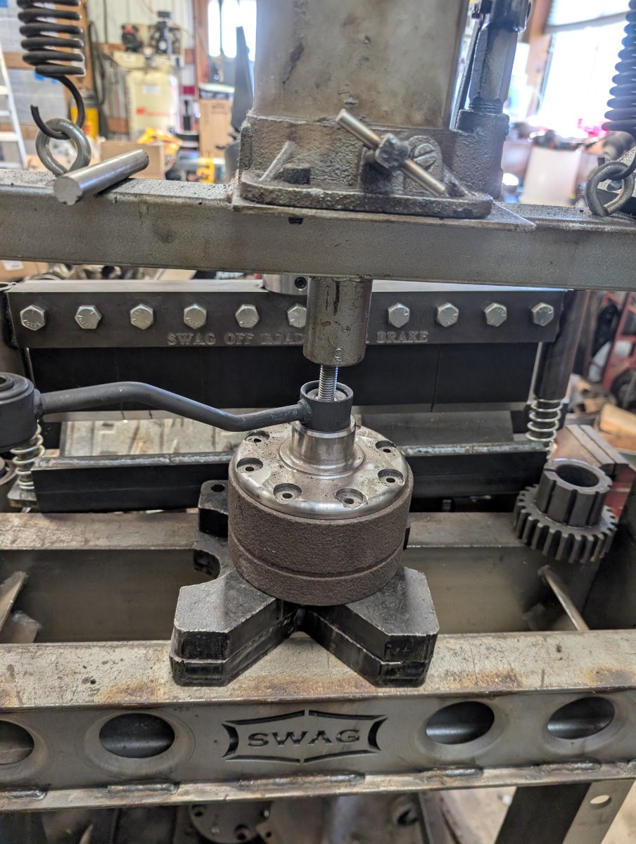

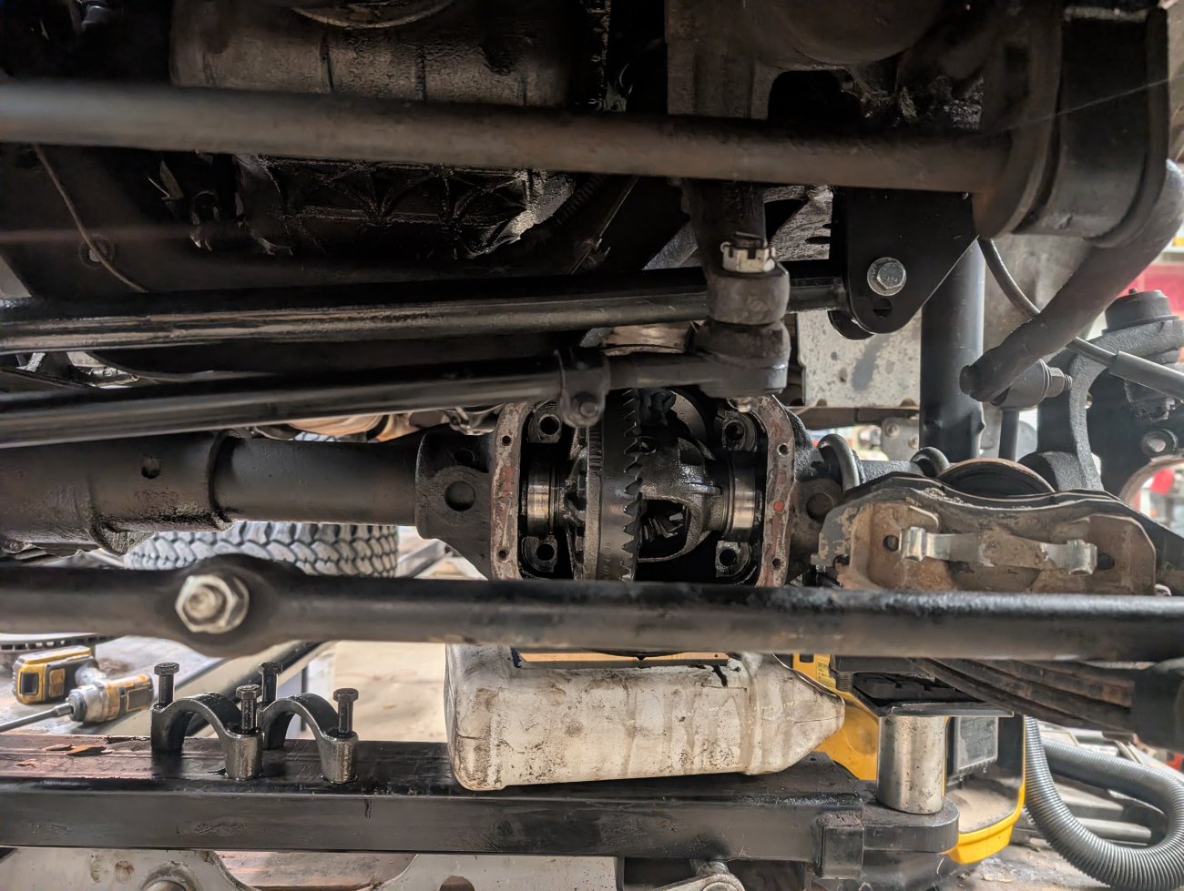

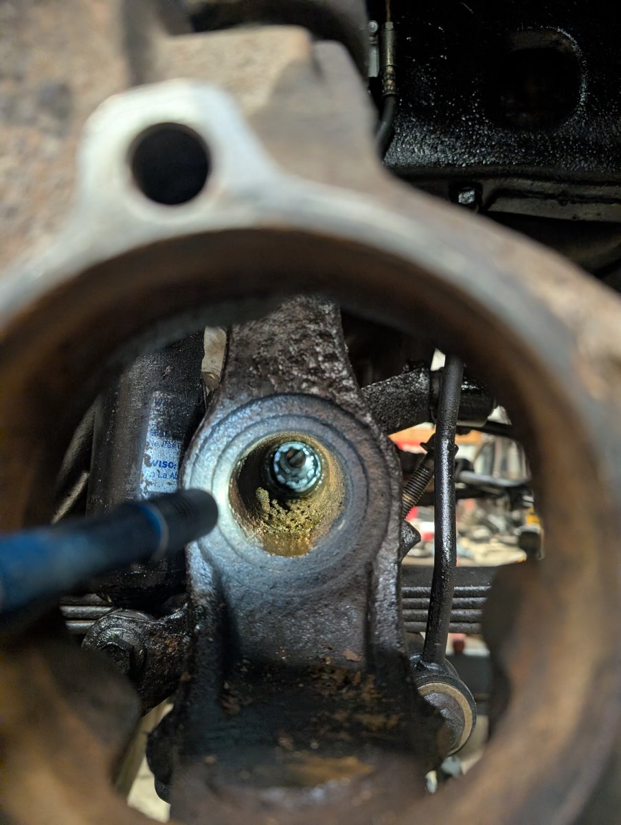

Pulled the hubs and shafts last night....but the axle tubes were full of dirt/sand and in a futile attempt to clean them I ended up pushing dirt into the diff.......so I need to pull the carrier out and flush the case and bearings now.
