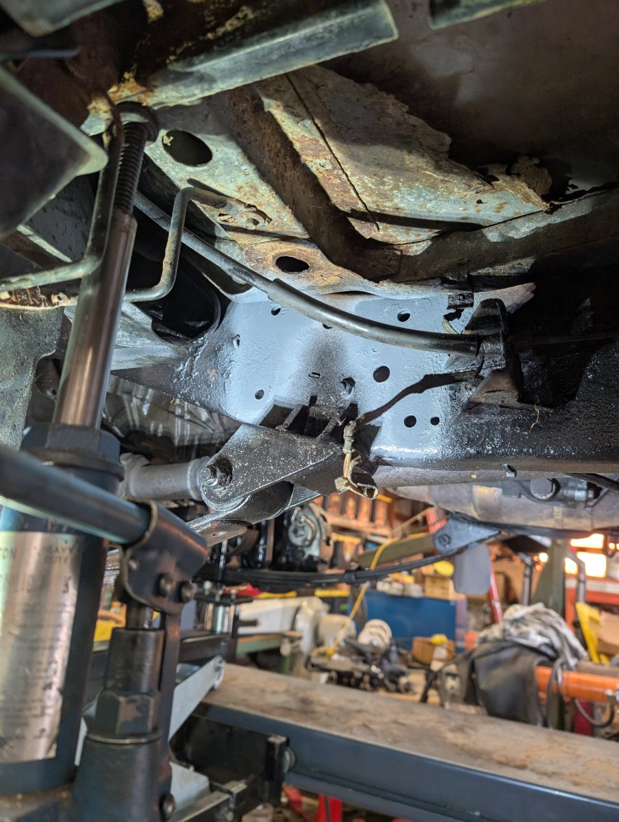

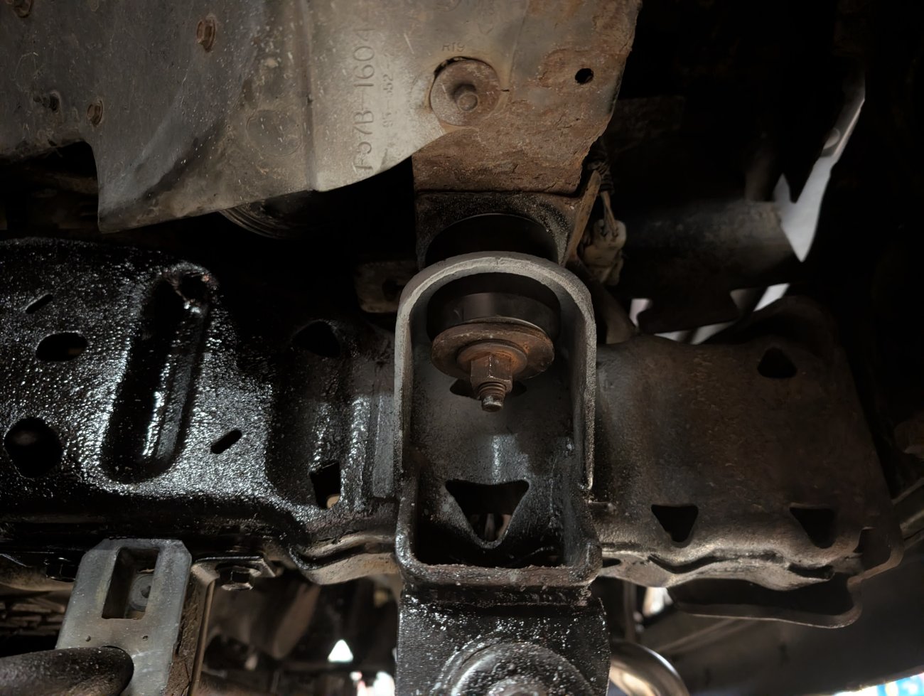

At least the tops of the mounts are rusted off and not the sides! The 93 I've been working on has big holes in the sides of the rear mounts and the core support mounts, and the core support itself, is basically just big flaky rust chunks now. Nothing is solid. The gas tank straps rusted in half and it's sitting on the skid plate now...and I can break off pieces of the skid plate by hand. It's sadly not the worst I've seen but it's pretty bad.
So what I'm getting at, is yours looks pretty good :ROFLMAO:
If I didn't have some sentimental attachment to this POS it would have been in death row for parts with the rest of them. I have parted out better lol

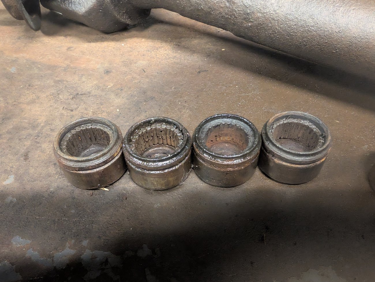

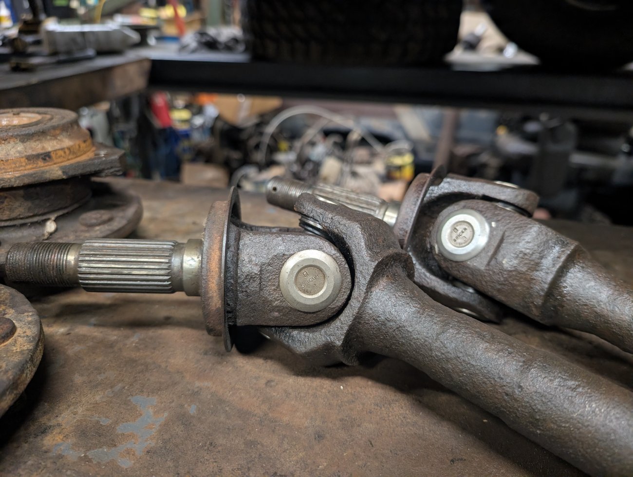

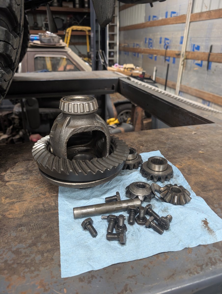

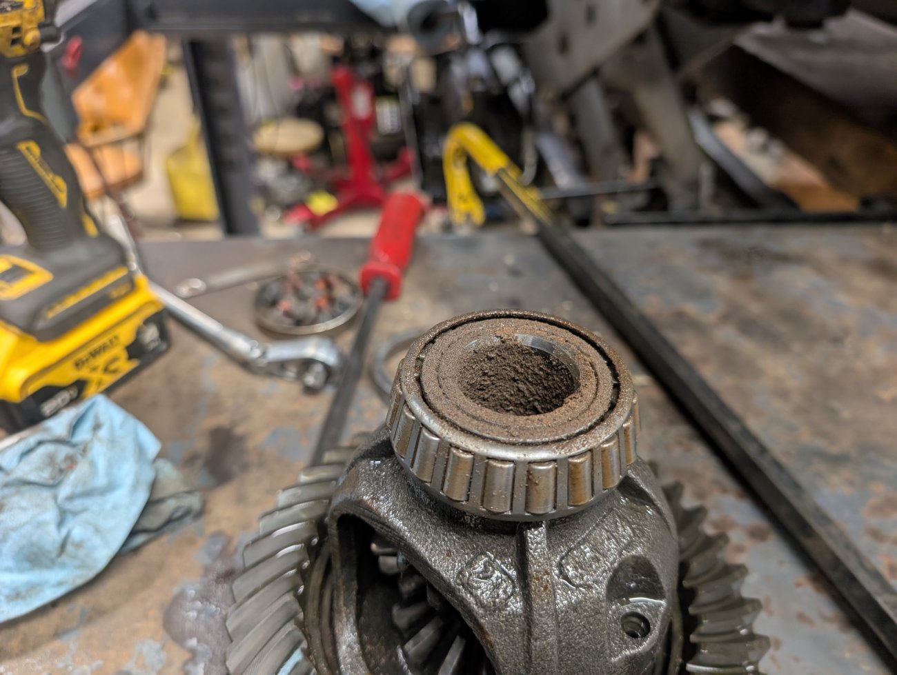

Gonna run the diff through the parts washer tomorrow, but got fresh joints in the shafts.

They were living on borrowed time from the looks of it. Quiet and smooth though.
PlumCrazy's Beater DD 4x4 SAS Build
Those needle bearings are still good, just clean the dirt out and repack them. They haven't turned to dust yet so that's how you know they're good.

If I didn't cut the joints apart to remove them from the stub shaft I would have considered it lol

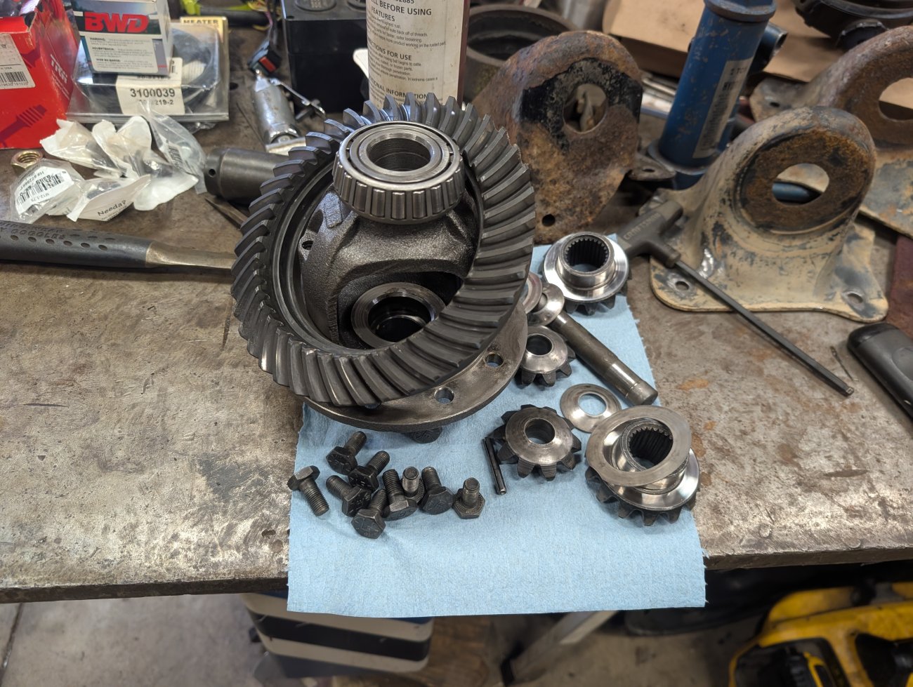

Diff cleaned up really nice with a combination of ultrasonic and parts washer.

Reassembled the front end with fresh hubs and wheel joints without any issues.

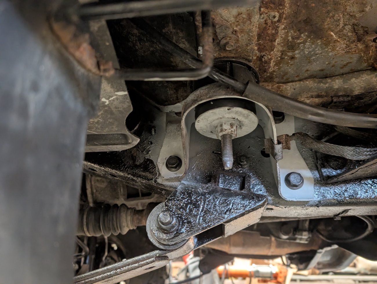

Moved onto body mounts...

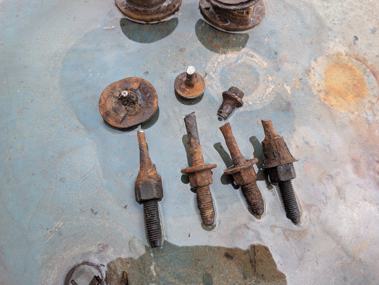

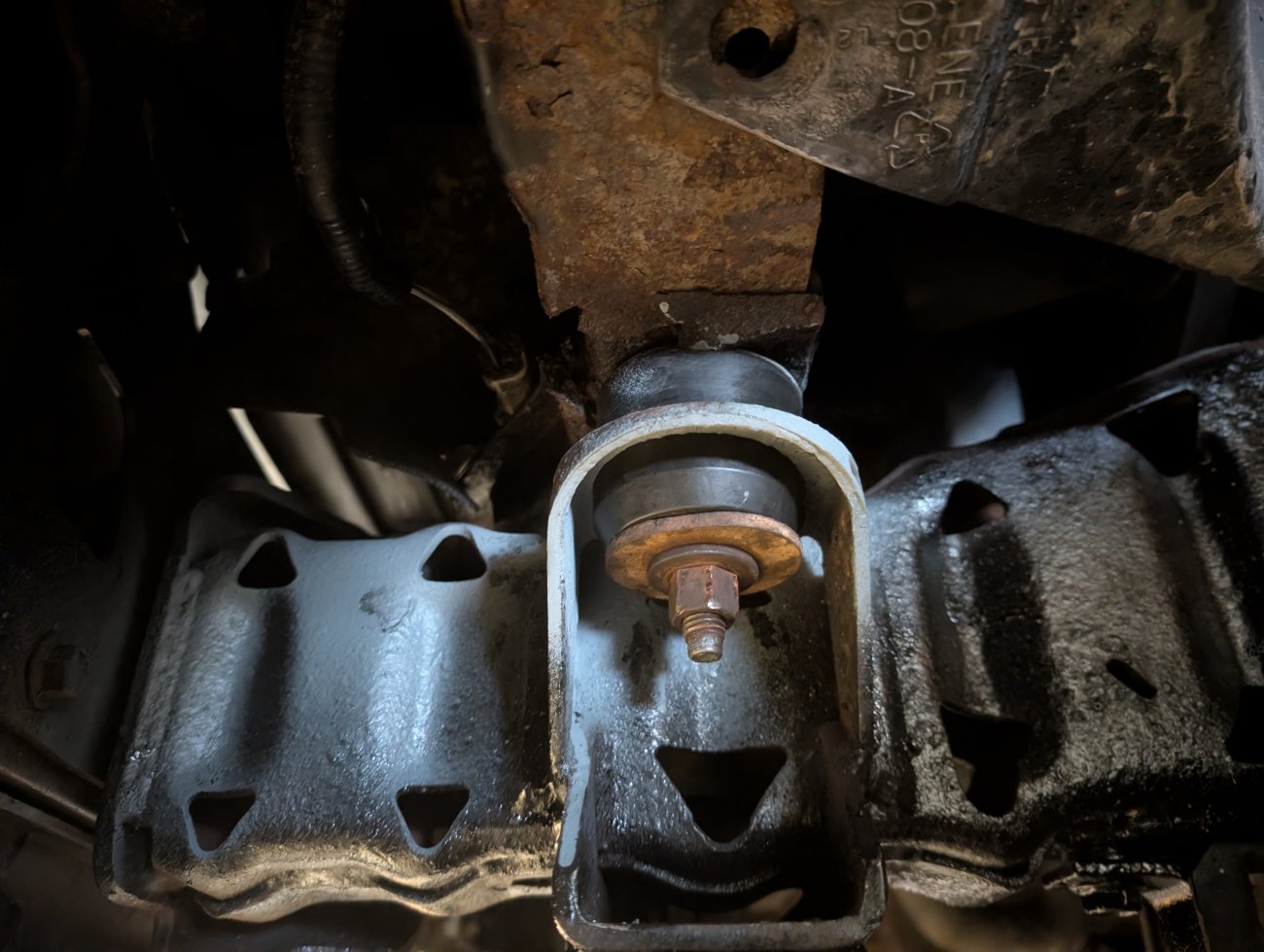

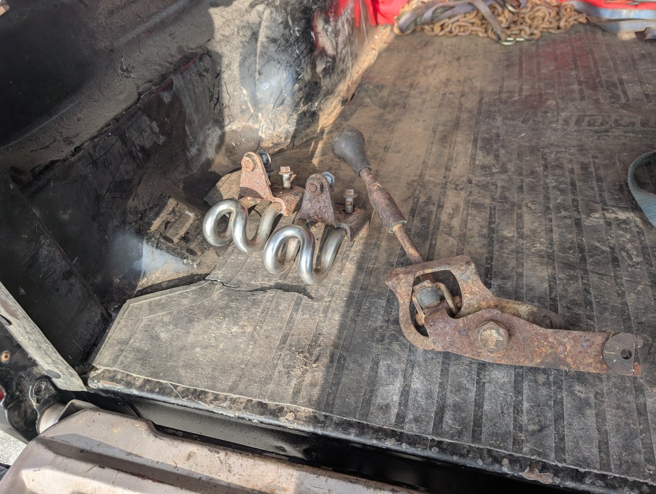

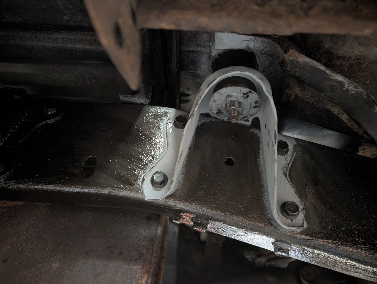

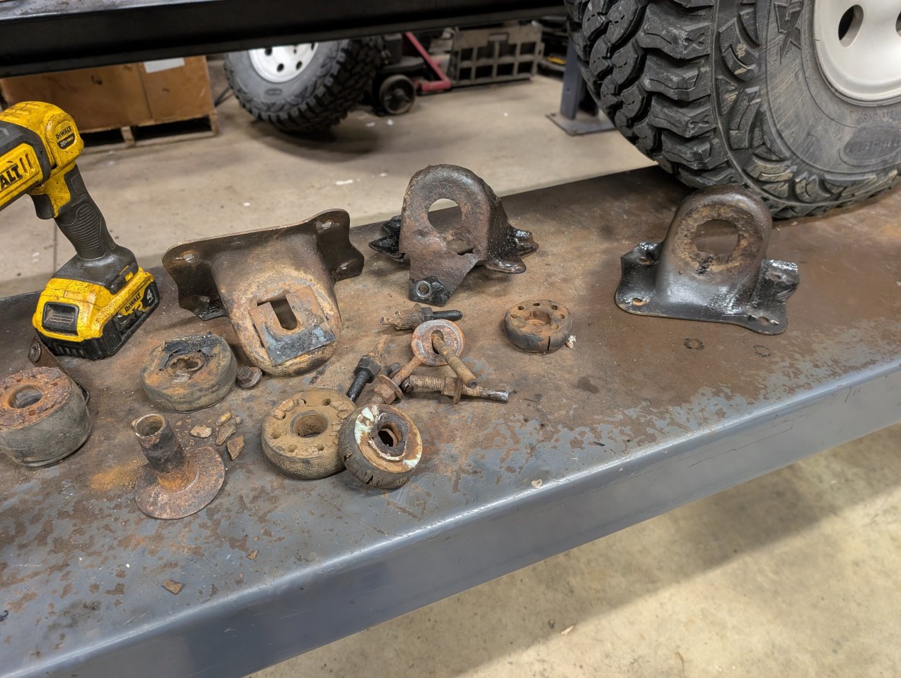

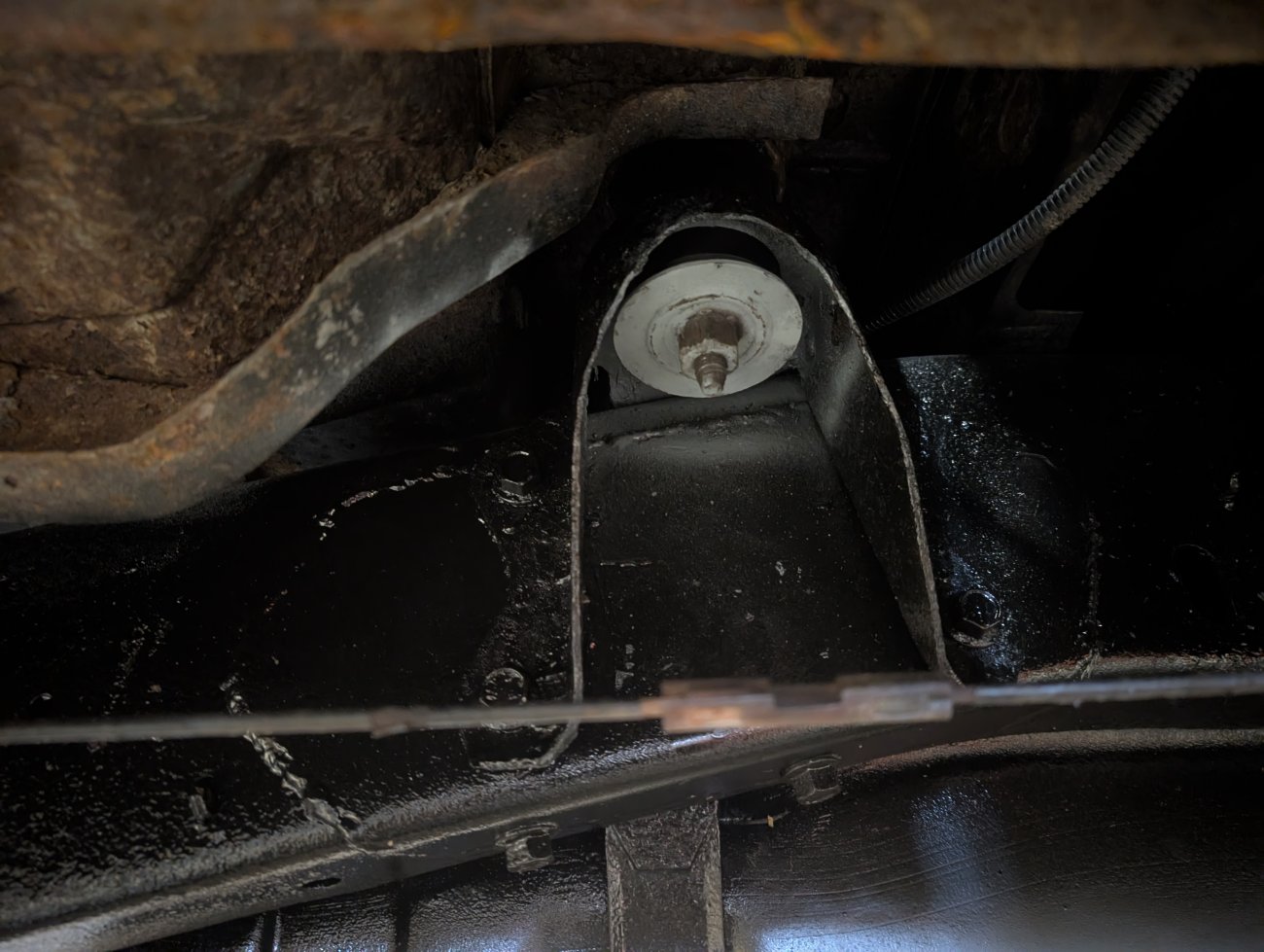

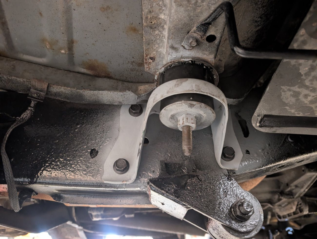

Removed the rotten mounts (some were worse than I had even expected

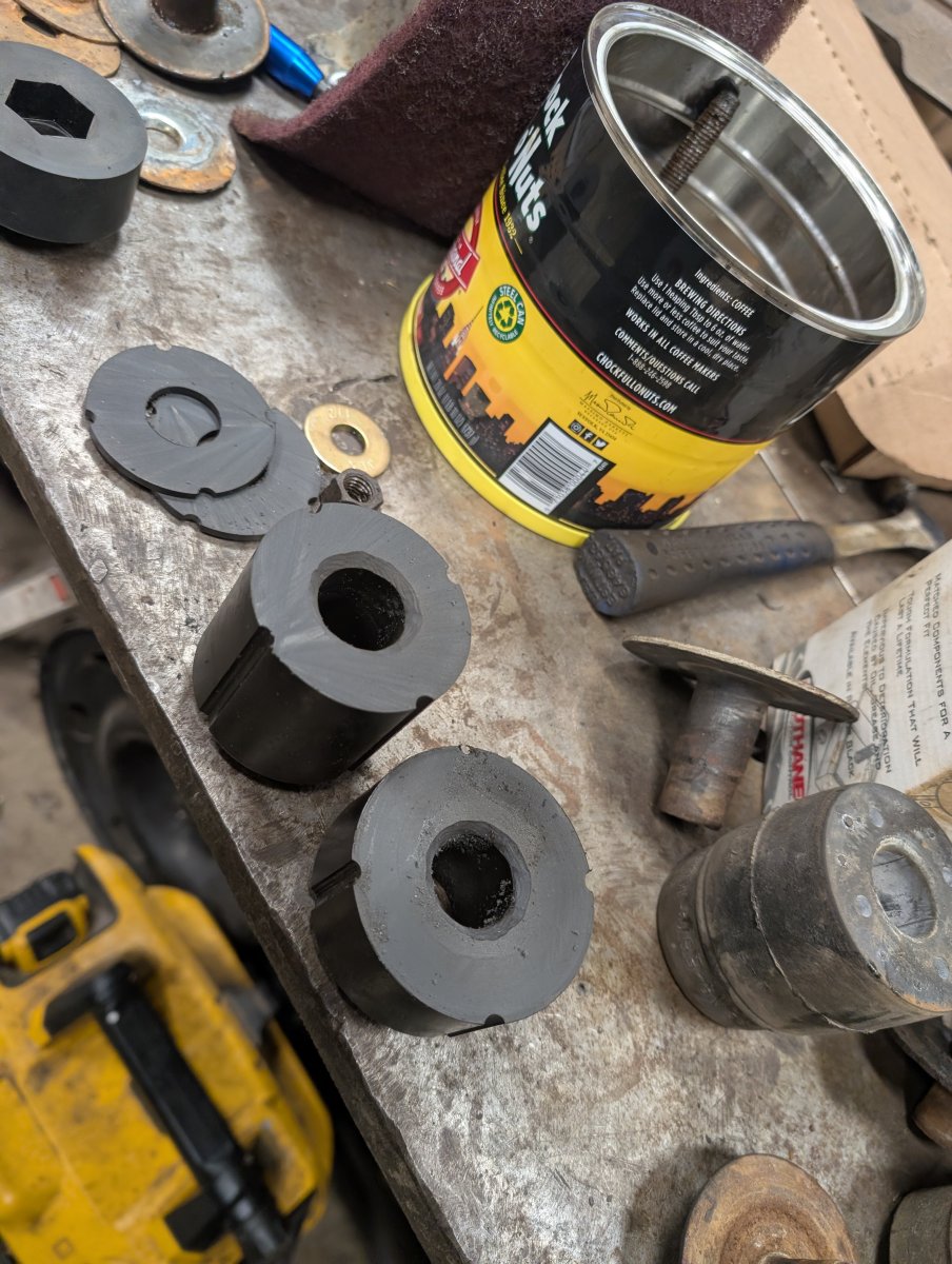

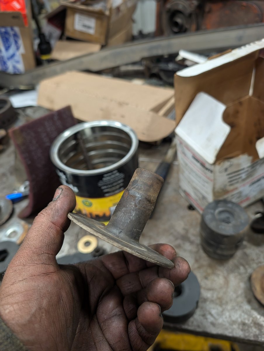

Had to modify the poly mounts a little. The rears were 1/4" too tall and all needed a chamfer on the ID to clear the radius of the factory inner sleeve.

Core support mounts got a grab bag of hardware. I used 2.3 head bolts and some body mount upper washers to reassemble with the poly mounts.
All mating surfaces and most hardware were stripped down and coated with cold galvanize paint before reassembly. Everything will a get afresh coating of Fluid Film soon.

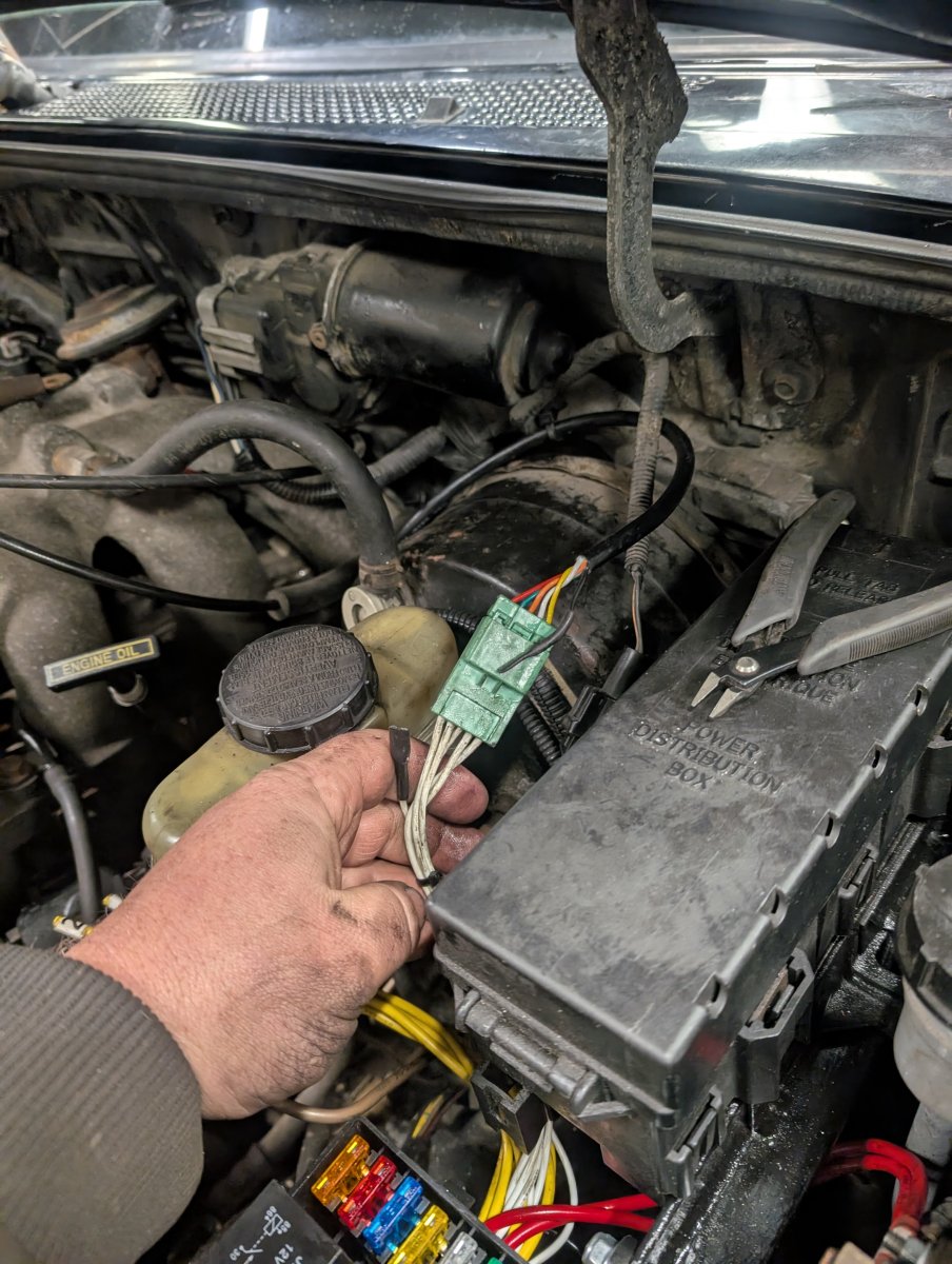

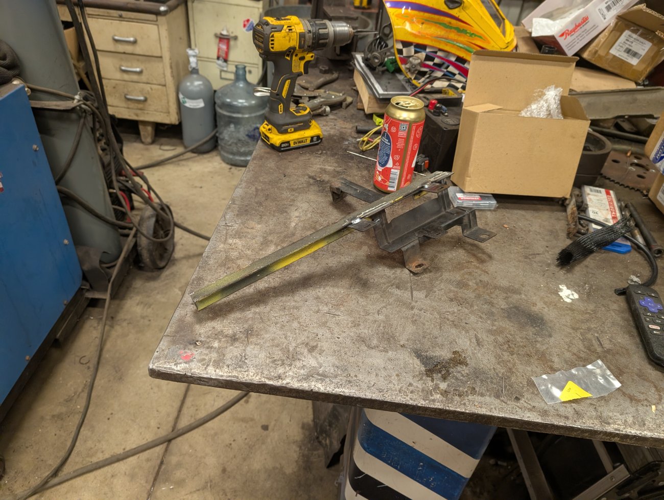

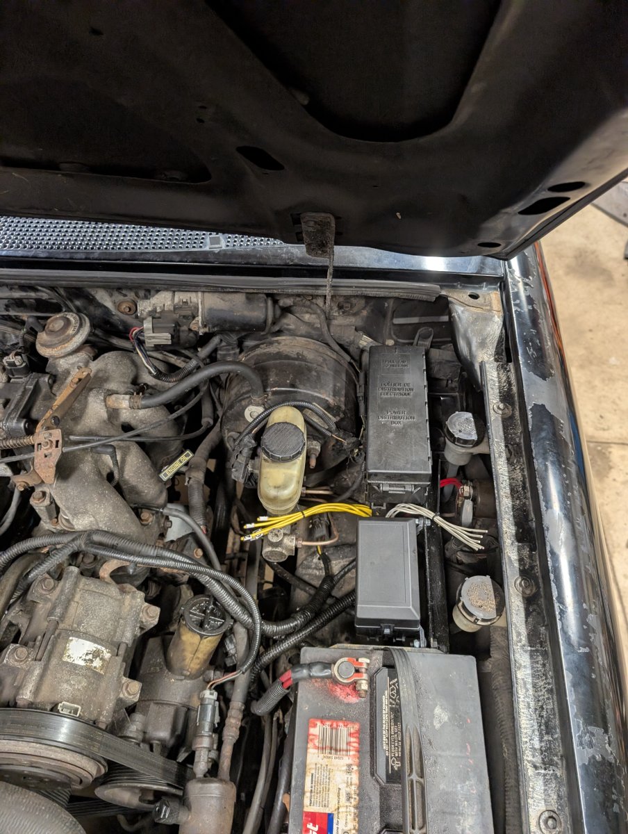

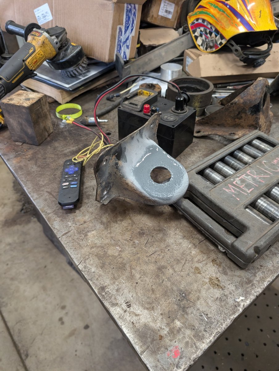

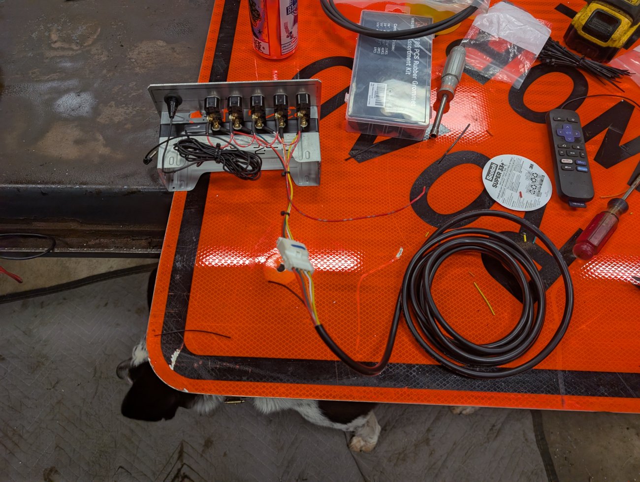

Added an additional relay/fuse box for some upcoming lighting upgrades.
Ideally I'd like to add some long range driving lights, some sort of yellow fog lights, power the strobe on the cap, and potentially some auxiliary switched backup lights.
Used some 3/4" angle off of the factory fusebox bracket to mount up the new relay box.

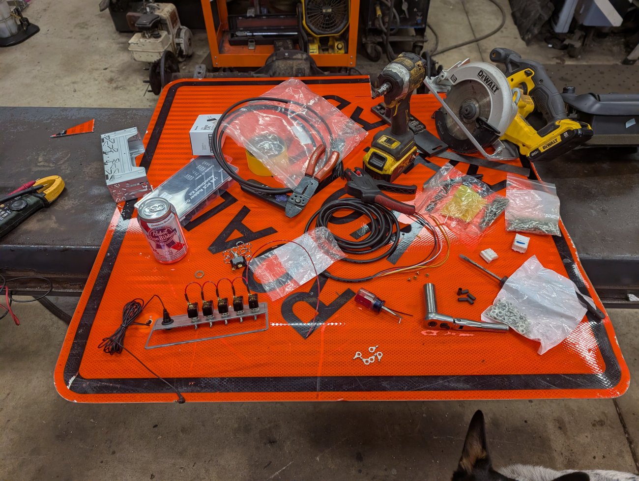

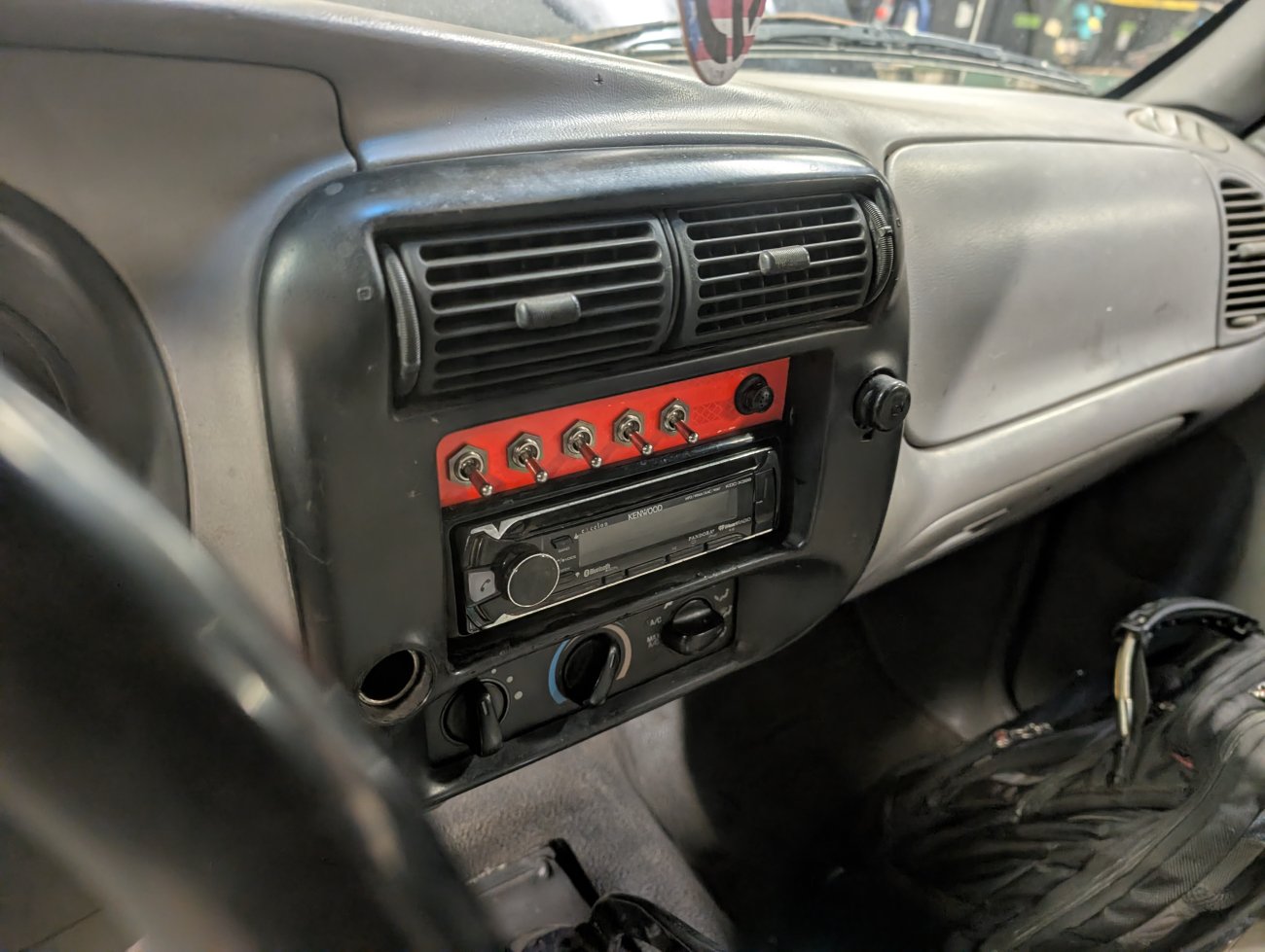

Recycled some aluminum I bought from the state department to make a switch panel and move the mic for the radio. And wired up everything with connectors and pins that were phased out at work.
Not 100% sold on the orange...but time will tell.

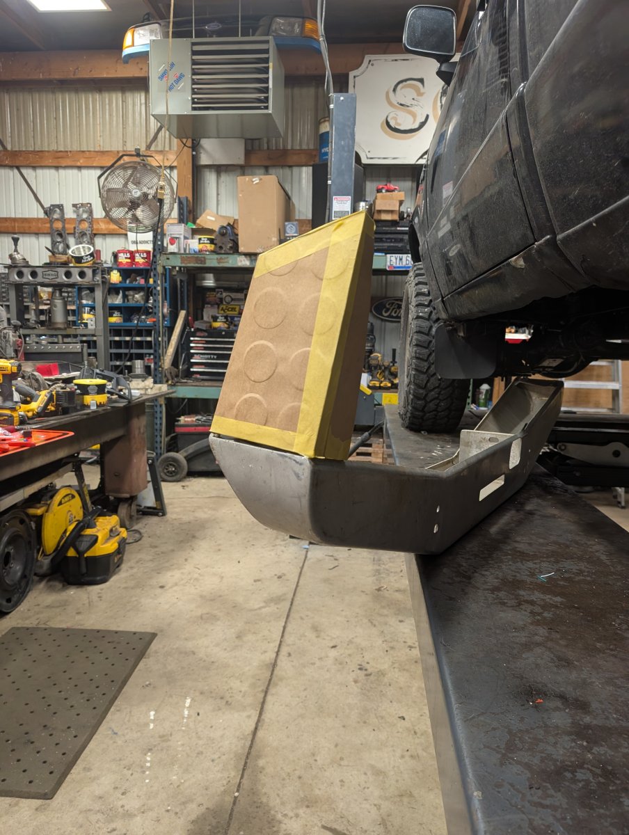

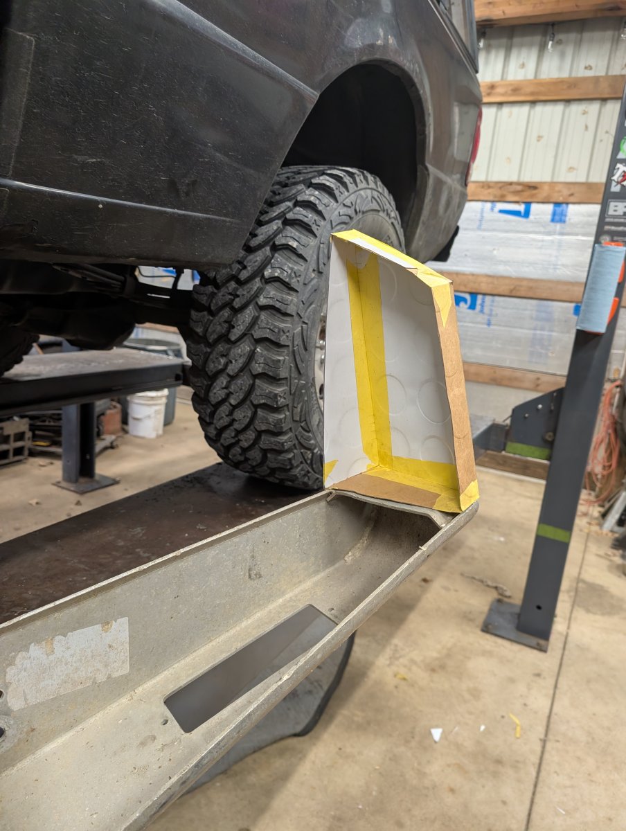

Also started mocking up some end caps for the TJM bumper

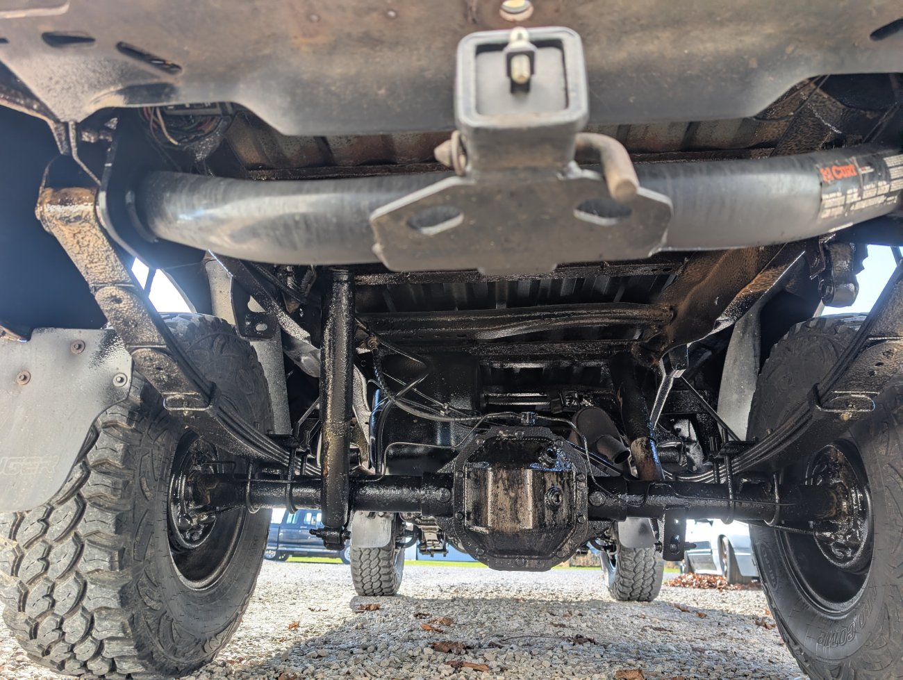

Finally got this thing thoroughly Fluid Filmed too

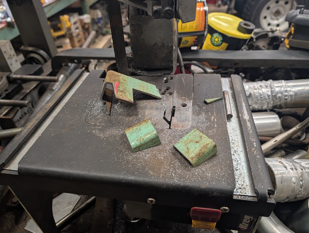

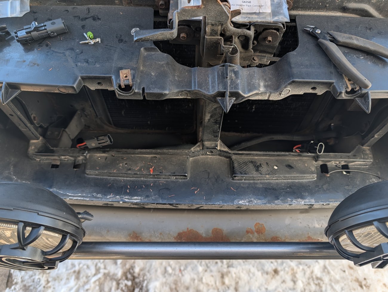

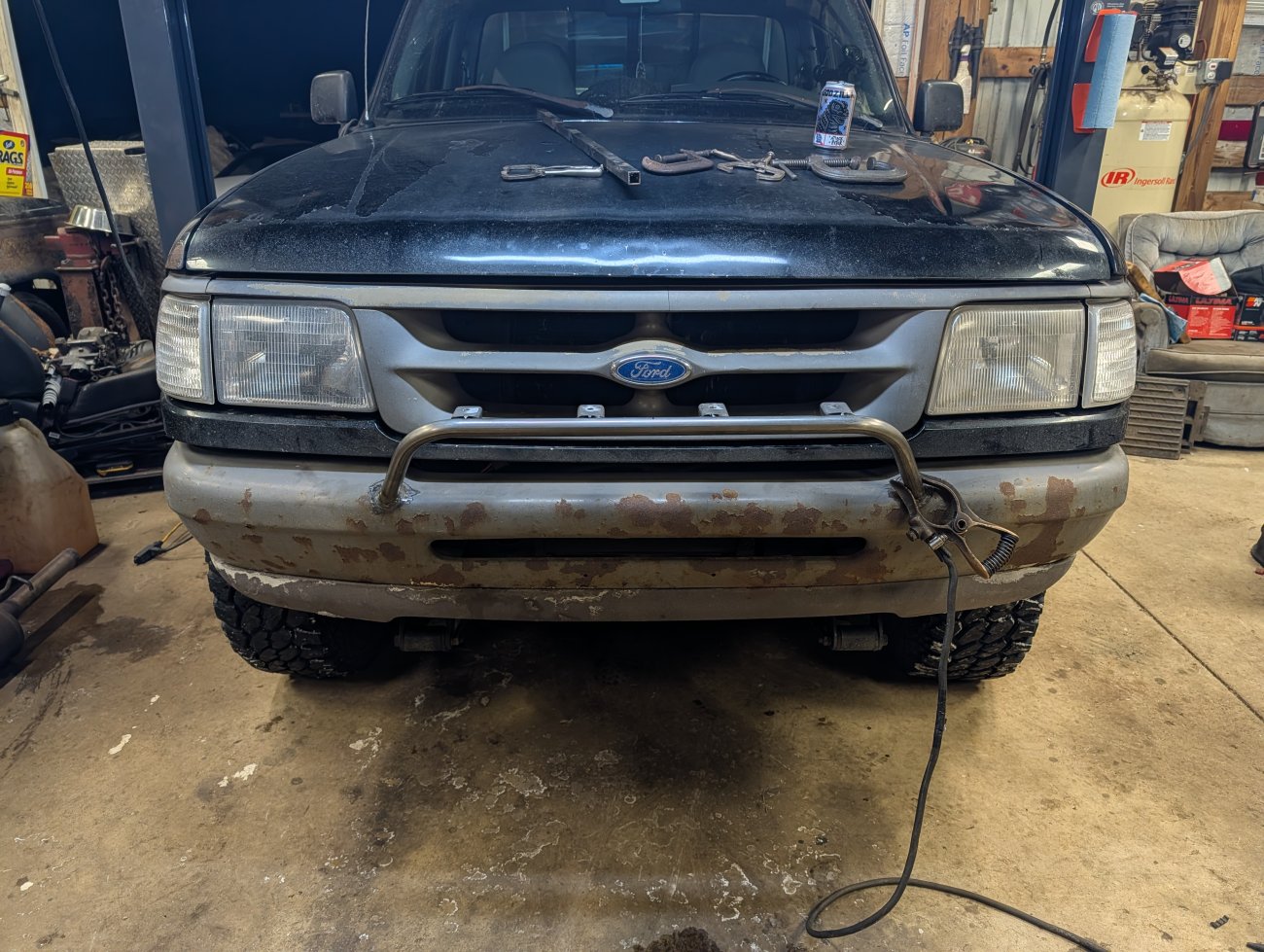

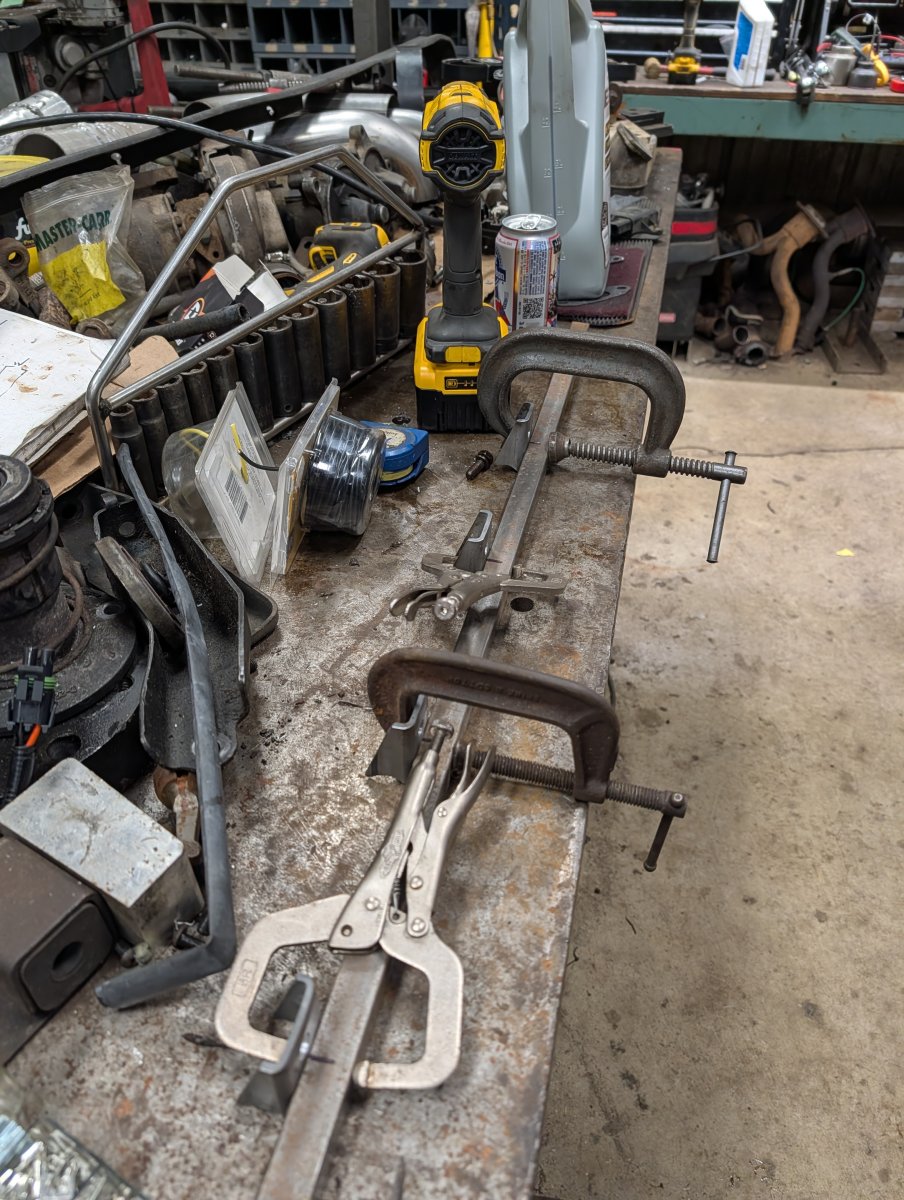

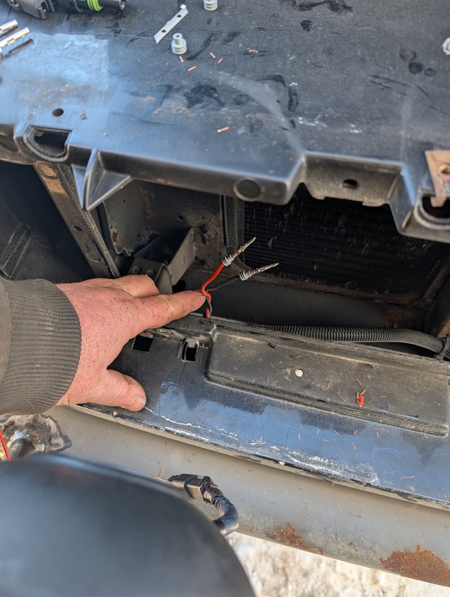

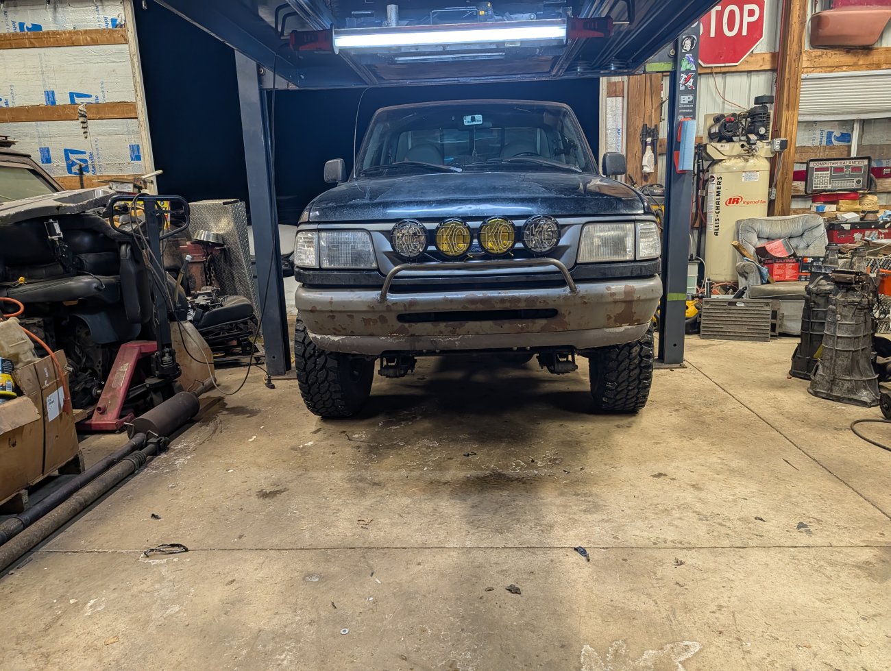

Whipped up a quick and dirty mount for driving lights
I had run wires a while back when I built the switch panel, so I just had to trim to length and add pins for weather pack connectors

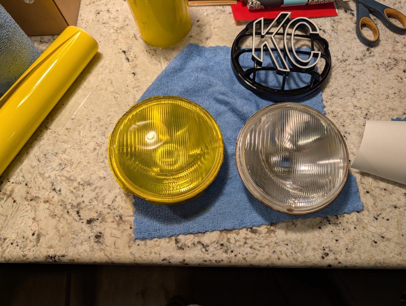

After welding on tabs and mounting up the two lights I had.....I decided to cut the tabs back off and add two new lights.
Wrapped the spread beam pattern in yellow so my poor eyescan see in the snow lol
Waiting on more 2 pin connectors to finish wiring up the center lights. I'm sure the 95a alternator is going to love this setup. The spot beams are 130w and the driving beams are 100w (we will see if the wrap holds up...may have to back down to 55w)
I left it a little taller than I like so that in the future I can cut it off and weld flanges on the ends to bolt to the aluminum bumper whenever I get around to mounting it.

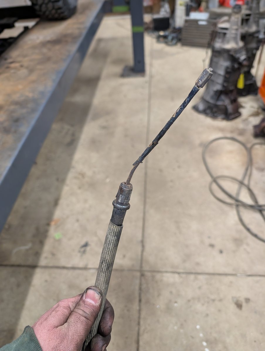

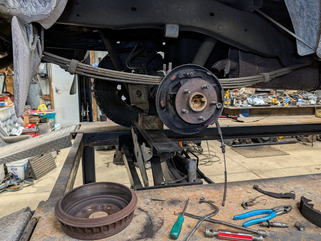

Still racking up 60 miles day on DD duty, but parking brake decided to become less than ideal after dinner last night.
Got home and the rear right showed 300* on the temp gun and the rear left was still 50*
Cable swelled up in the liner on the front end

Anyways...works great with a fresh cable.

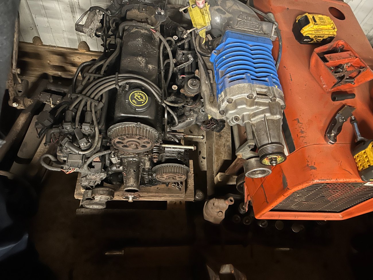

With winter coming to a close, my turbo truck and 5.0 Ranger are itching to get some miles.
Which means this old beater can sit back and relax all summer....
Perfect time to see if I can make this work.

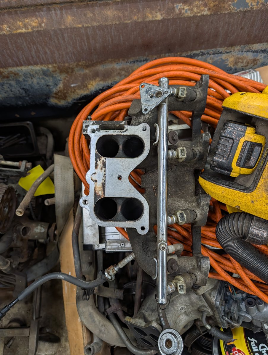

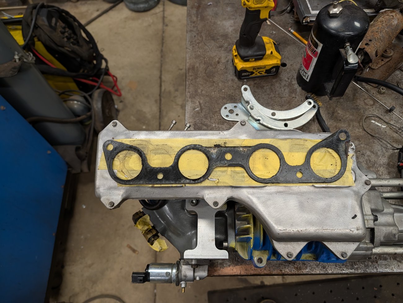

M62 setup for a 4.0 OHV....but with a fairly simple adapter I think I can mate it to the 2.3 lower plenum.
I have both style 8 plug lower plenums to play with.
I'd like to play with pulleys to keep it under 5psi and let the stock computer deal with it.
I have the black box from the original BBK Instacharger kit that will retard timing via a circuit that interrupts the crank signal and references boost. It also has a potentiometer adjustment to set base timing. I need to look into the OBD2 2.3 setup and see if they reference the cam or crank for timing.
I also have a few sets of turbo pistons if the factory NA pistons aren't up to the task.
