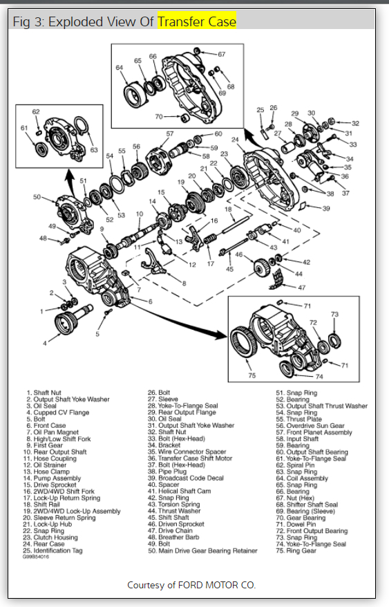

Does anyone know how to remove this circular flange attached to the transfer case the seal is leaking an needs replaced but I can’t get it out! 2006 Ford ranger 4.0!
