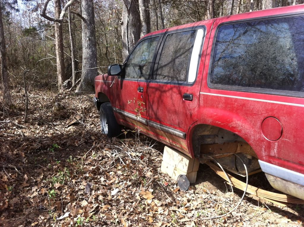

92 Explorer, stripped... it's sitting on the frame rails. No motor, no trans, no t/case, no axles.
I'm thinking of a "budget" junkyard build to run 35's to 37's. I want low-ish COG so a lot of cutting will be in order. No it won't be pretty, that's what my Mall Crawler B2 is for. It will be a beater and it will attempt to conquer all of Superlift, Hawk Pride, and SMORR and the other parks in TN.
I'm looking for input from those that have built explorer's and what you are happy with and what you'd change about it or stuff you would have never done. Plans are to NOT chop the top...for now. That might change later.

it's ugly already! and I HATE that red interior...but hey, it's a beater.
this pic was taken before I stole the d35 out of it for the B2.
