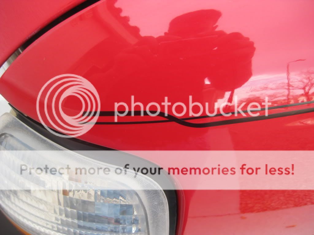

I used my nail and it came off in a line with bug and tar remover then i found i needed something to break it up(had silver stripes wanted black), got a $6 roll from autozone and put powerblock tech to work. Had to use a bit of lighter to get it to stay down on the ends.
