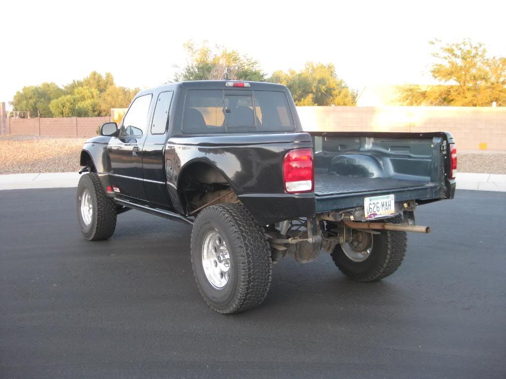

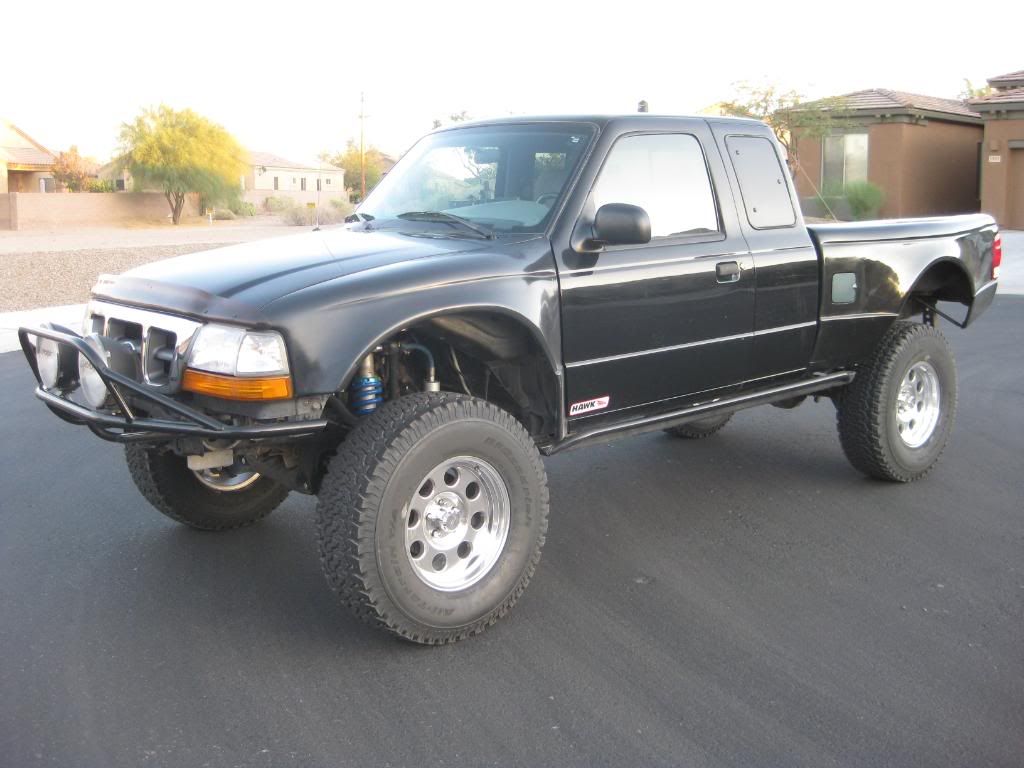

Just a quick update. Bed swap, Fiberwerx 6" flair bedsides and 35" BFG KO's on 17" wheels.
Up next, Ford F150 9.75 Axle with 4:88 gears, posi and disk brakes; Giant 64" spring kit.

Agreed on the regular bed. The Dixon kit seems to be doing great. I need the get the back built so that I can really test it out. New axle and leaf springs should be in by the beginning on next week. 16" shocks and bed cage will happen somewhere in the future when funds permit.
How much travel are you able to get in the rear, and how did you set up the shocks? I want to eventually do a 64" leaf swap, but I don't want to lose my bed.
64" are not installed yet. It should pull 19"-21". As I understand it, the preferred shock setup is generally a 16" stroke smooth body or bypass (link killer preferred for the Giant kit) set between a 0 to 20 degree angle from vertical. Shocks will need to come through the bed, but a cage can be designed to maximize bed space. Mine will be setup with run of the mill factory (stock) shocks for a while until I can purchase race shocks and have my cage built.

Are you still running 3.73 gears, how is it. Are you worried about the front diff on 35's?
Truck looks great. I think you oughta flip the rear shackle so you can lower the back of the truck down a bit. Just my .02
I am running stock 4:10 gears right now. It is not as bad as I would have imagined but a regear is definitely in order. Speaking of which, my front CV axles are currently removed because I will be installing a Ford 9.75 F150 axle with 4:88 gears within the next couple of weeks. I will not reinstall the front CV axles until I can afford to regear the front differential to match.
I agree 100%. When I install the new axle, I will be installing the Giant 64" kit. That kit includes new front and rear (flipped & drop) hangers with custom 8" shackles. I am hoping that the back of the truck will be lowered by at least 3". I will see when it is all installed. I will be waiting on a bed cage and long travel shocks until funds are replenished. Everything in this sport costs too much money!

Hey, for the rear you could take out the factory lift block, or put the factory shackle back in. Either would lower the truck for now, and it is free.
I considered that originally, but since I was running extended Bilstien 5100's (Back of the truck is still running the RCD lift equipment) I did not want the shocks to reach bump before the axle did. At this point, I already have all of the parts to do the axle/spring swap, I am just waiting on the gear installer to finish the rebuild. If you know of anyone looking for an add a leaf lift, let me know.
