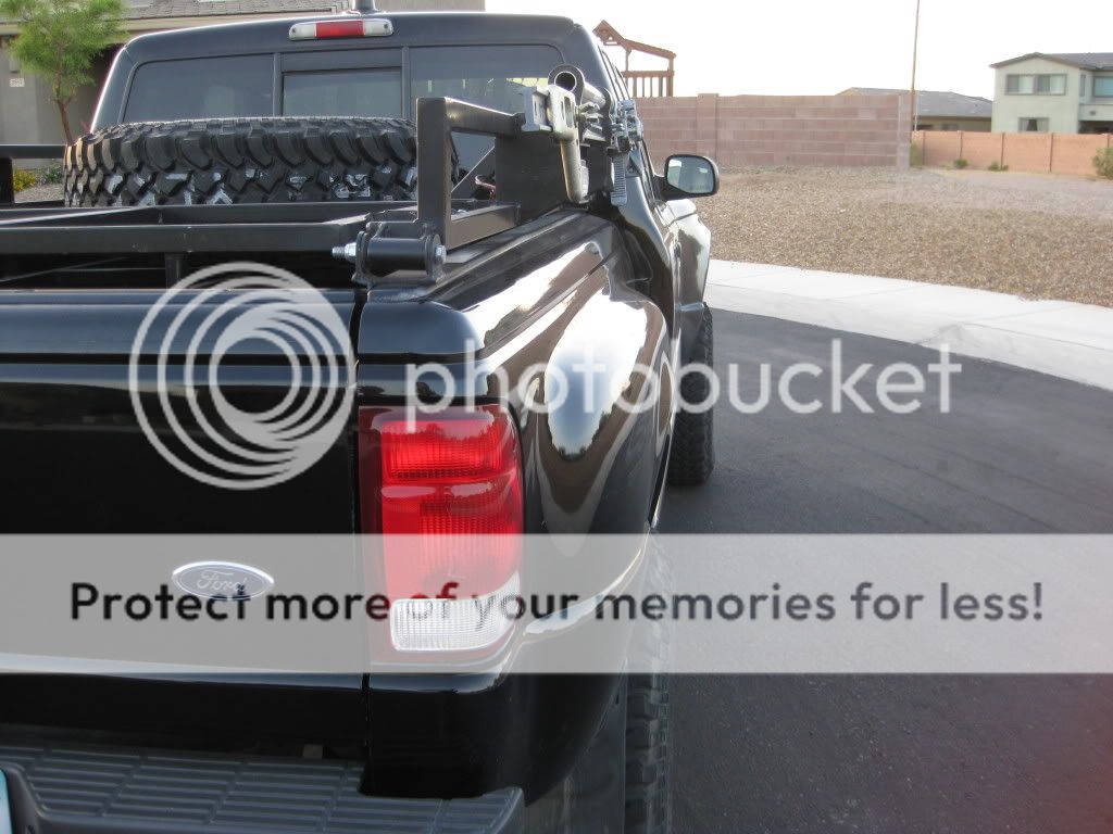

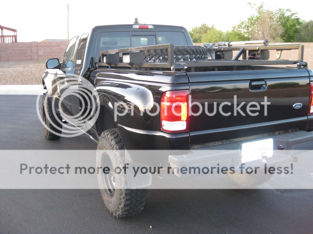

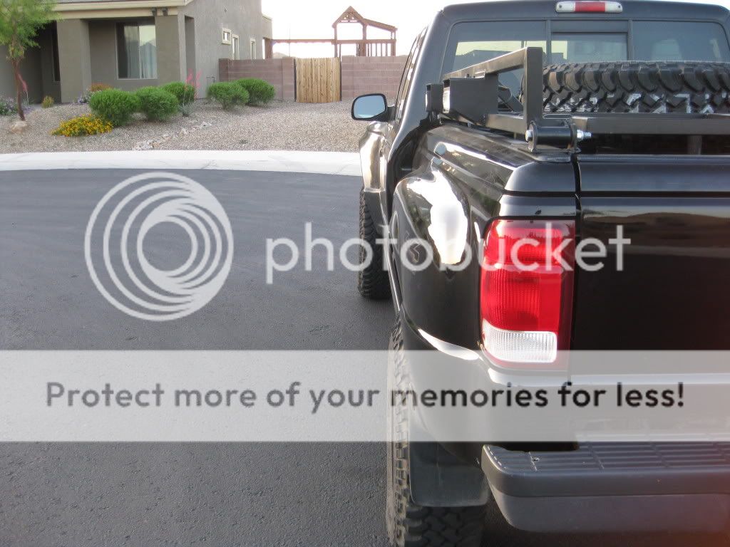

i like the way the truck looks and nice job on the lift btw where did you get that back rack for you truck
Thanks. The rack is a one off design that I did and had a local welder fabricate. It works quite well for what it is.

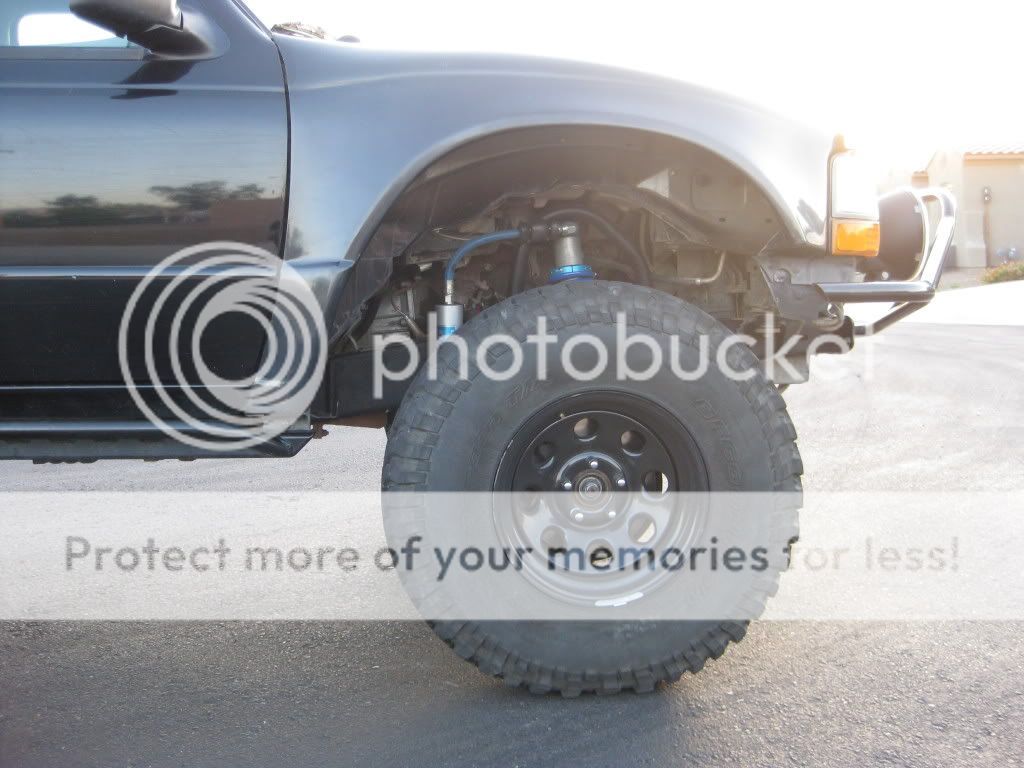

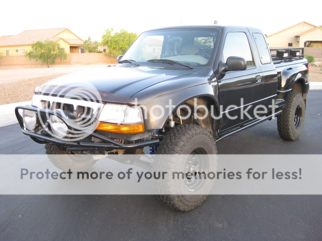

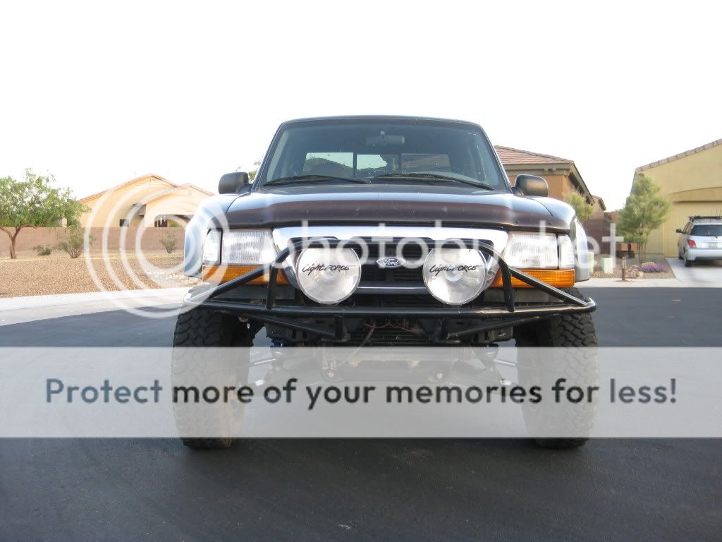

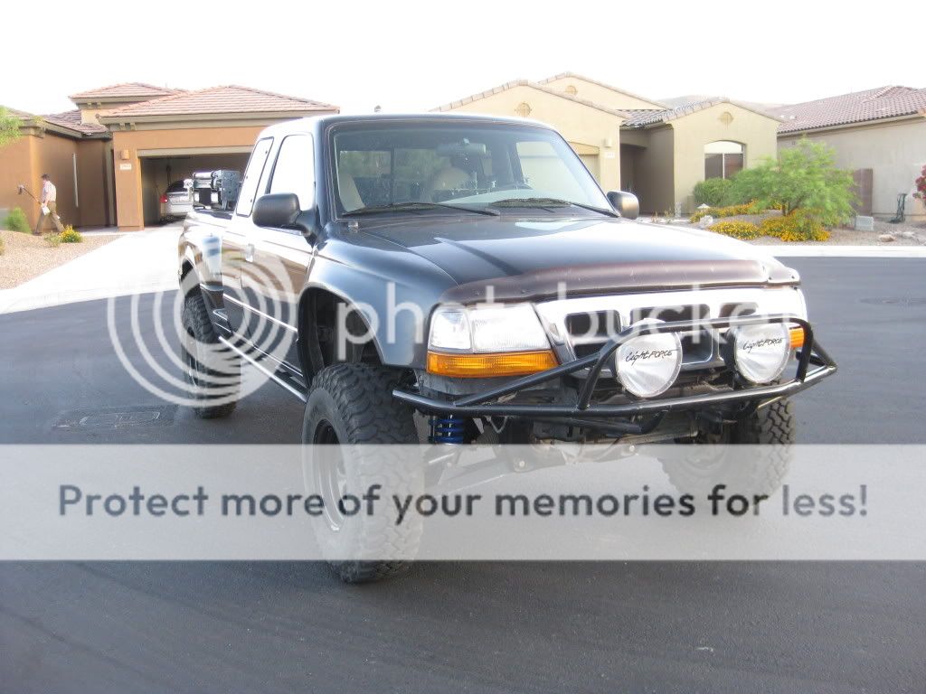

Pictures with fenders mounted up...
When the existing tires wear out I will go with 35X12.5's (current tires are 33X10.5's). Next task will likely be the addition of a skid plate to the existing bumper.
The conversion took a buddy and I 30+ hours (60 man hours). As for lift, my truck sat higher with the RCD kit.
My truck was sitting level when the first pictures were shot, but I only had a couple of inches of down travel left. Once I reduced the preload, the front of the truck is probably 3" over stock plus tire height.
Not really a 4X4 killer. I am just waiting on the half shafts. Aaron was out of stock when my kit shipped out. 4X4 should be up and kicking in a couple of weeks.
