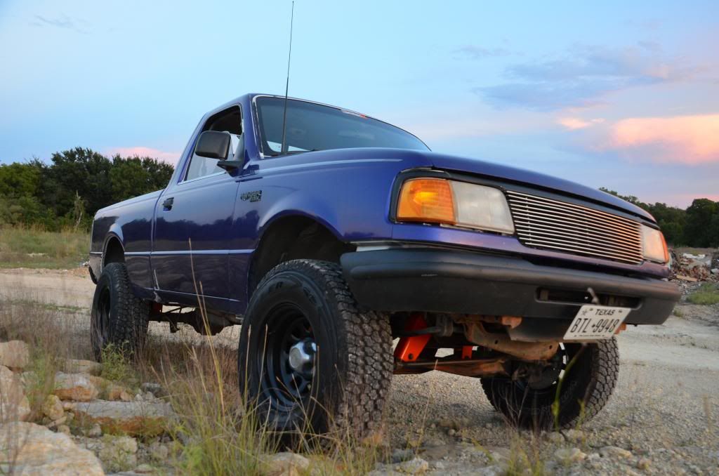

4in Rough Country lift kit, wanting to add a 3" body lift next!!
3"spindle with coil spacers in the front and 3" blocks in the rear ,with 33" 12.50 15 bfgoodrich km2 mt

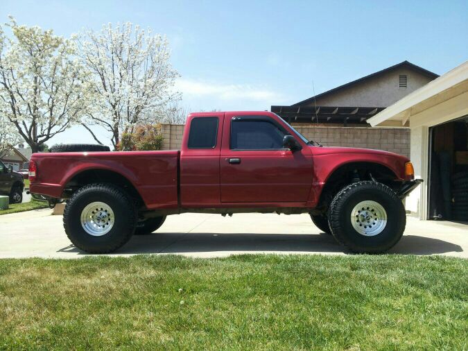

Cut front coils, explorer 8.8 SUA and belltech shackles / 4 inch trim on fenders and bedsides with 31x10.50's on stock 15x7's
SOA and f150 coils coming soon
got the axle flipped and F150 springs installed.
Im going to have to lower it some or bend the beams. I am maxed out on the 2 1/4 degree cams and still have 2.2 and 3 degrees of camber. :bawling:
