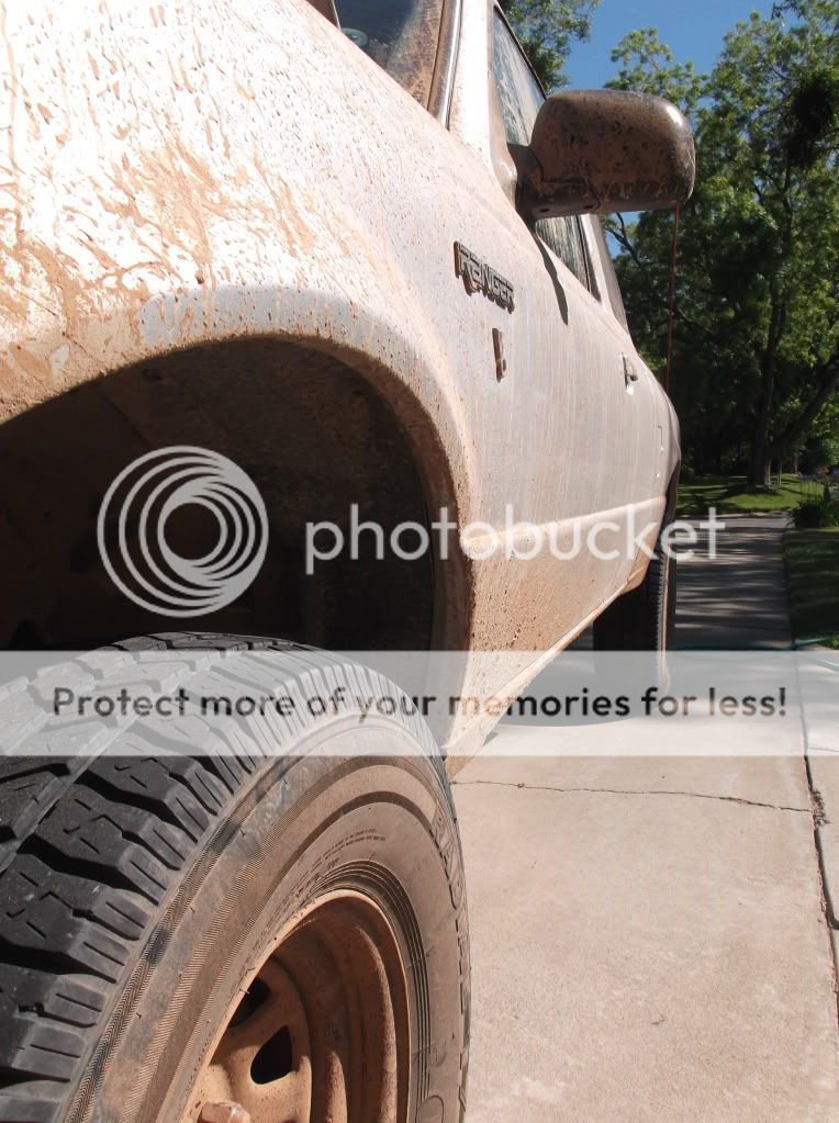

update pic with wheel spacers

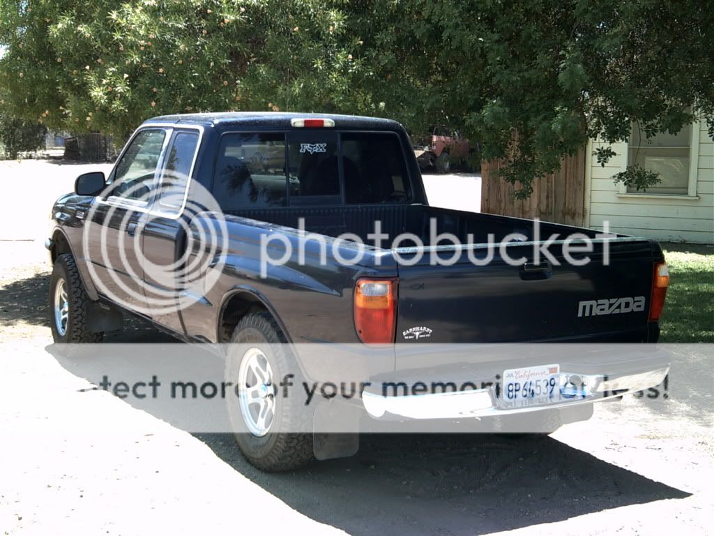

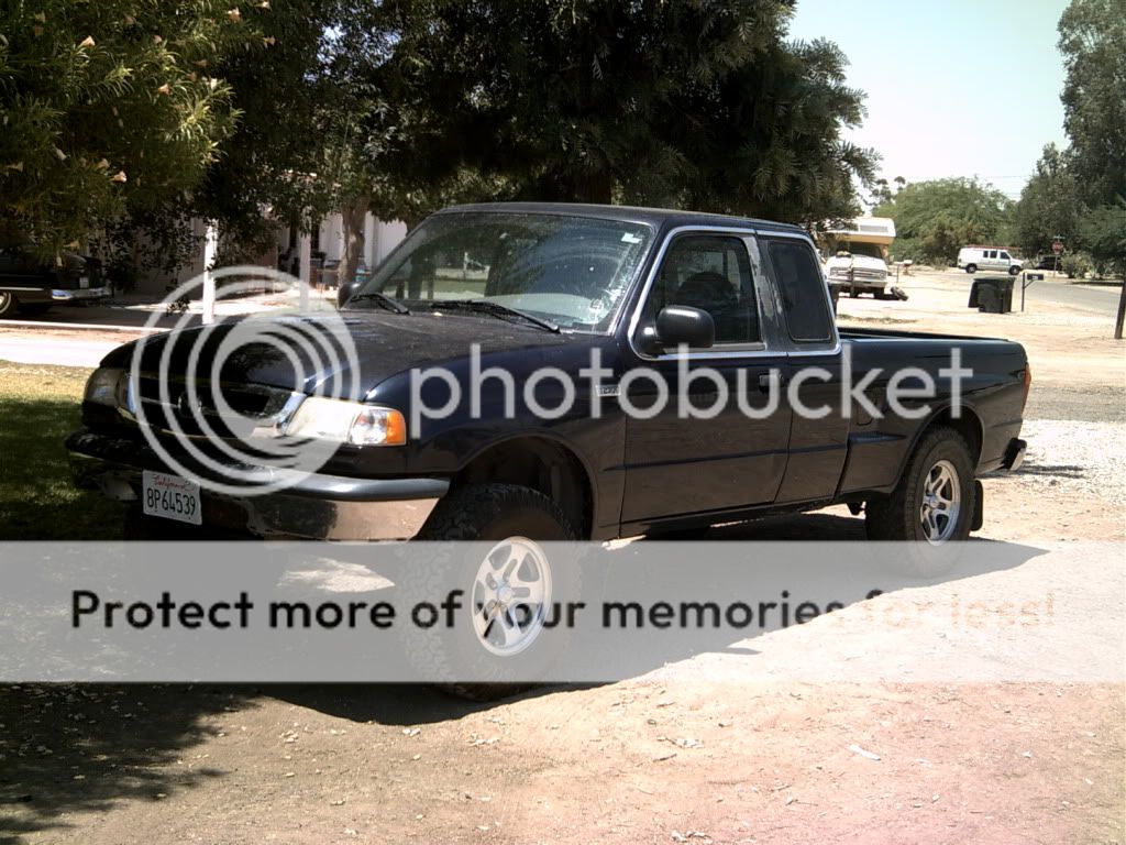

heres my 2002 mazda b2300 with a 3" spindle lift and 31x10.50r15 bfg all terrain tires

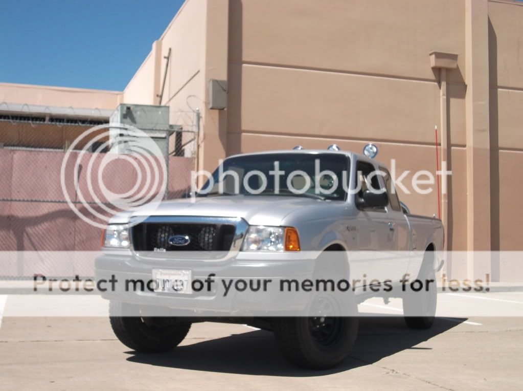

ive got 2 inch coil spacers, 31s and a 3 inch bl.
