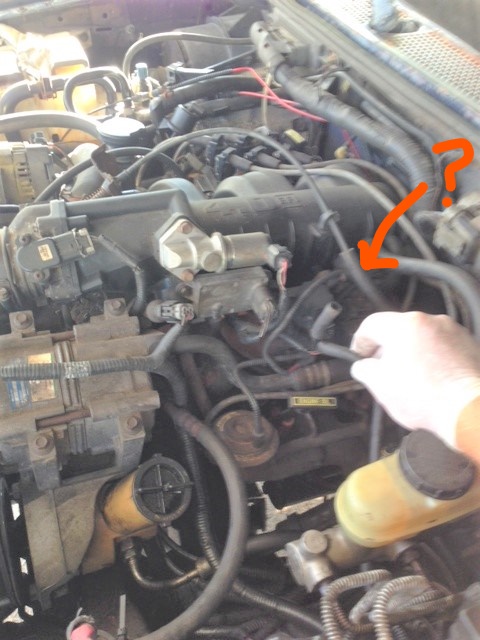

Does anyone know
index.php
26109
26110
Cannot find where this hos hooks up too help anyone ? please show me as we cannot find the vacuum post to hook this onto We cannot find a schematic or a drawing many thanks to any one who can help. this is a Ford Ranger 4.0 1995
Not 100% sure as my 4.0 is '92 but if it is for the vapor purge, there is a nipple on the throttle body that mine connects too.
It would be on the bottom of the throttle body.
