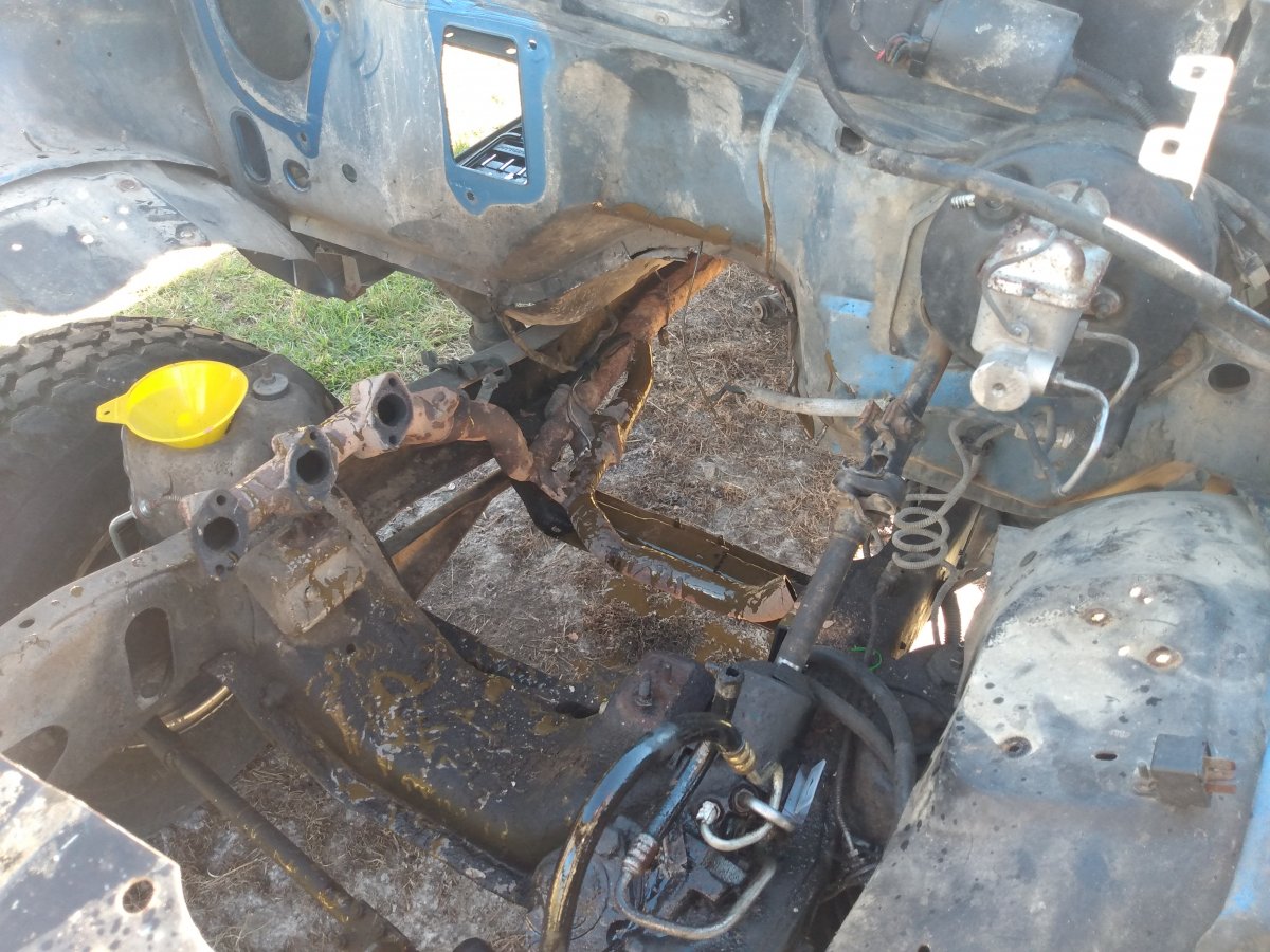

Not sure exactly what the previous owner did the firewall on our Ranger but I think the openings are just covered with sheetmetal.
68367
It looks like they are there, inline with each wiper knob, thats what they are there for, to access/service wipers
You can see the indented part of the plates in the picture
Center of engine bay top(behind the hose), and drivers side next to inner fender, right inline with driverside wiper knob
The heater box holes have sheet metal cover

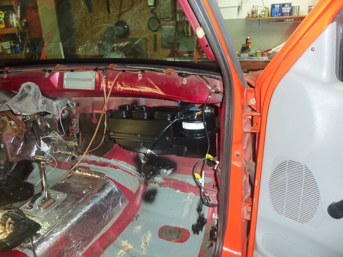

I used a Vintage Air system because my truck was formerly drag raced and the HVAC was missing. Vintage doesn't use outside air, they just recirculate so I blocked the air inlet under the right side of the dash with sheet metal and seam sealer. Vintage Air is in Texas, they couldn't understand why I'd want to draw outside air into my truck. I guess they never had to clear a fogged windshield on a 40 degree rainy day.
