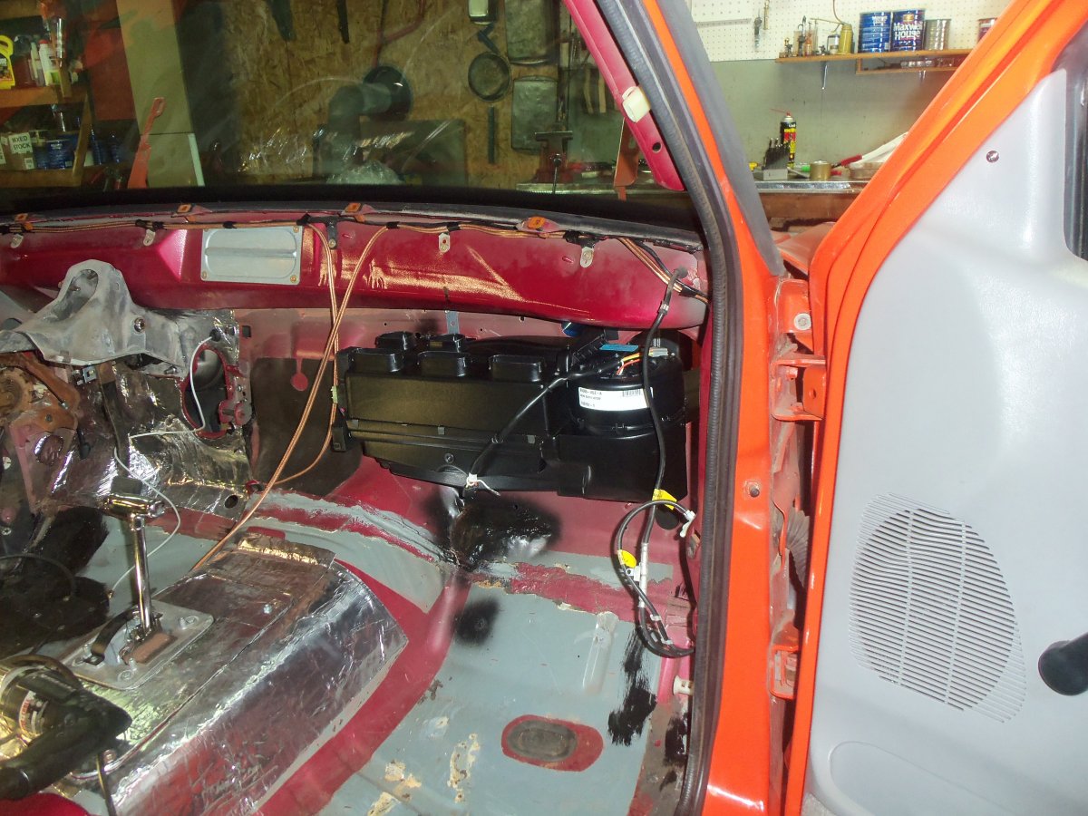

I used a Vintage Air system because my truck was formerly drag raced and the HVAC was missing. Vintage doesn't use outside air, they just recirculate so I blocked the air inlet under the right side of the dash with sheet metal and seam sealer. Vintage Air is in Texas, they couldn't understand why I'd want to draw outside air into my truck. I guess they never had to clear a fogged windshield on a 40 degree rainy day.View attachment 68374

If I had the original ducts I could have hooked them up to my unit. It's called a mini unit and has heat, a/c, and defrost. Though. like I said, the defrost doesn't work great.
