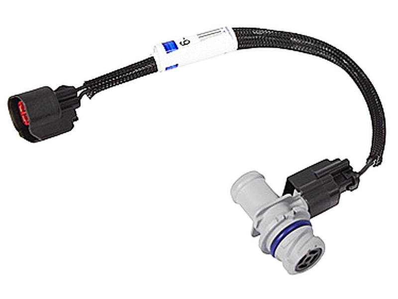

I was going to replace my PCV valve while doing a tune up but I'm finding conflicting part numbers. I have an electrical connector on mine so the one at RockAuto is wrong. I've come up with EV273, EV271 and 3F2Z-6A666-AA. They are all Motorcraft numbers. Does anyone know which is the right one? The longer number is like $70 while the others are more like $45-$50. Would anyone recommend just cleaning and reusing the same one? It's not broken but I know they need to be replaced from time to time. Thank you!

My 2001 had PCVValve with the goofy Coolant OxBow; deleted that 5/16"ID Coolant loop non-sense several years ago with no regrets.
Part number I have here for the PCVValve with ElectricHeat is 3f2z-6a666-aa.

That's what mine looks like. It has the electrical connector. I will just clean it like RonD said. Thanks!
