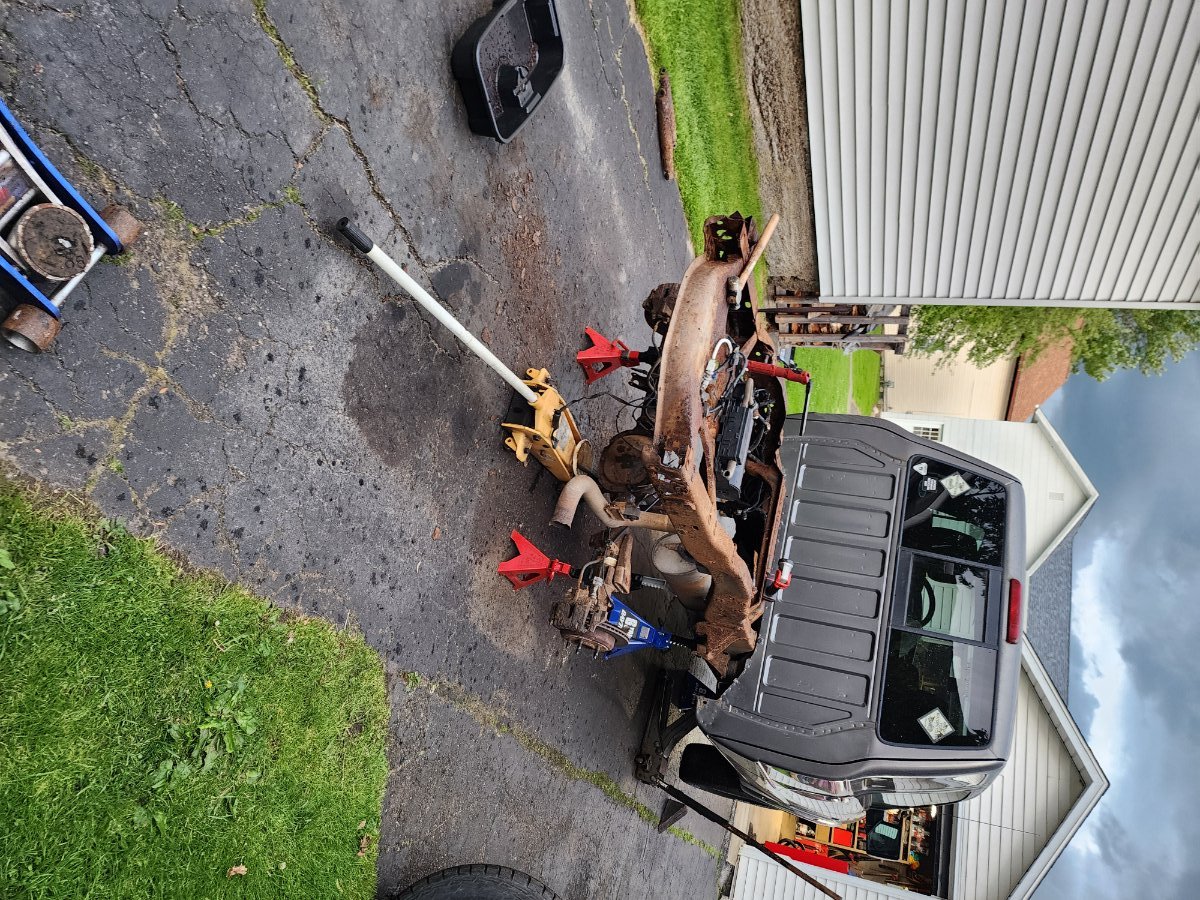

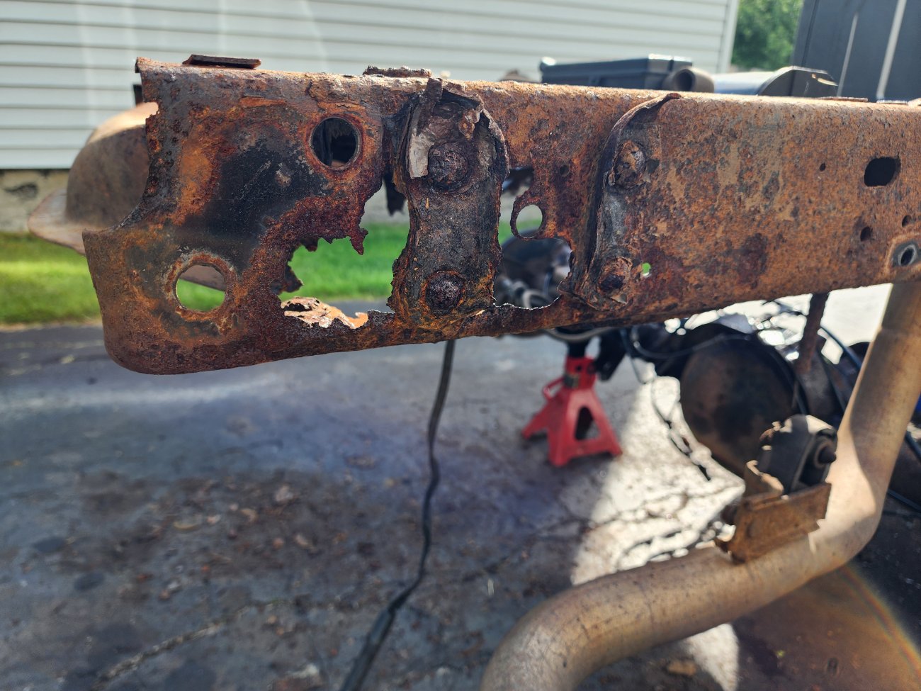

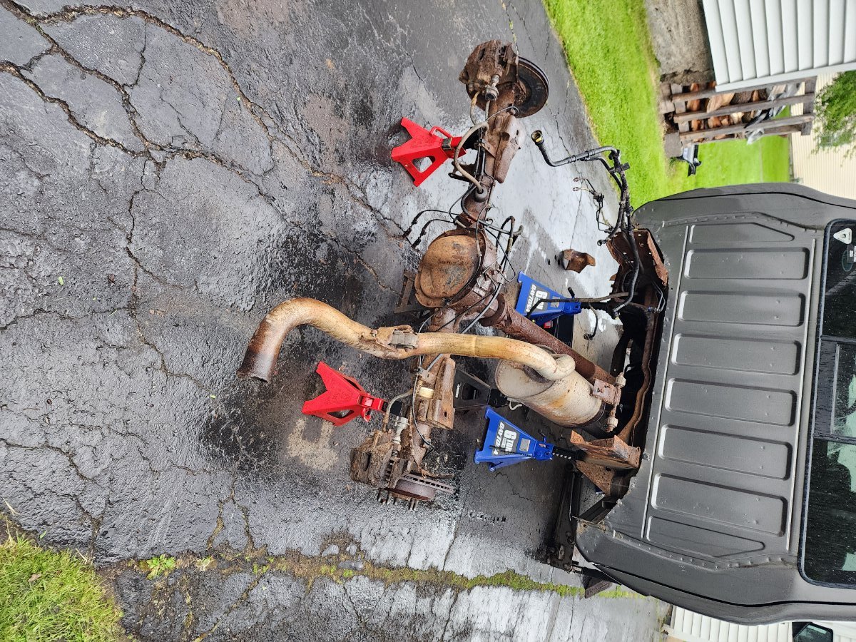

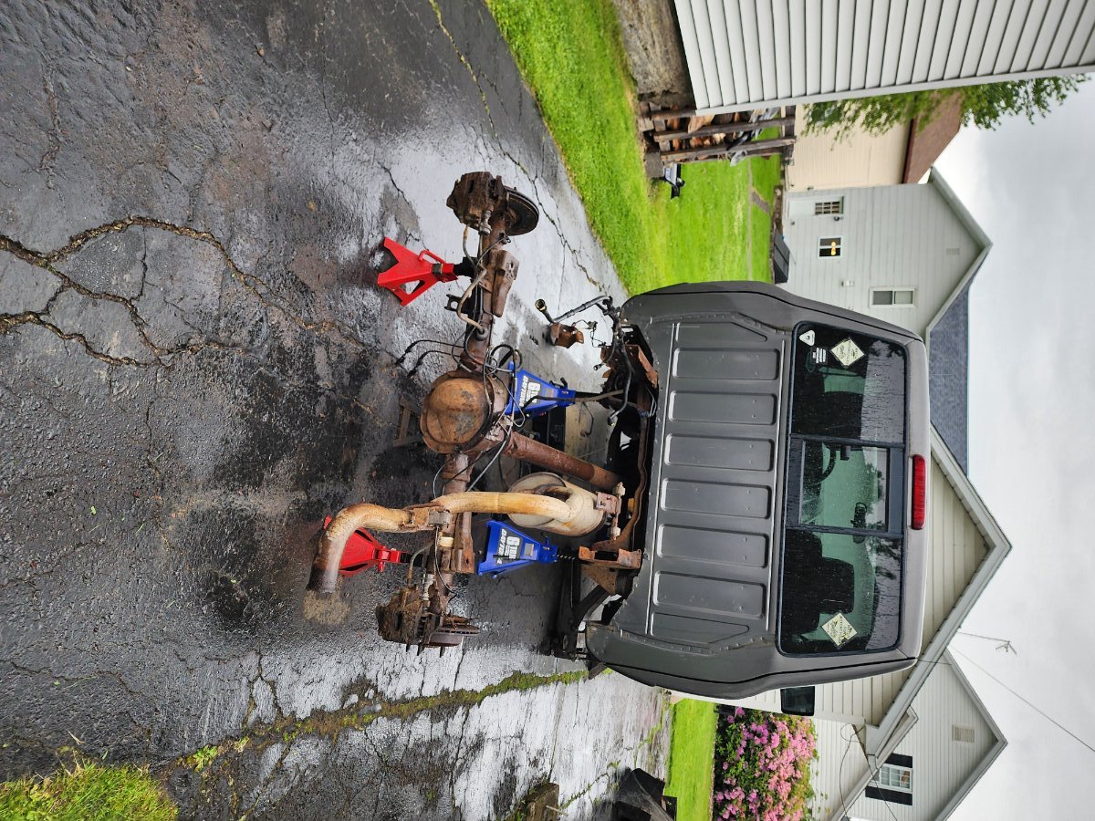

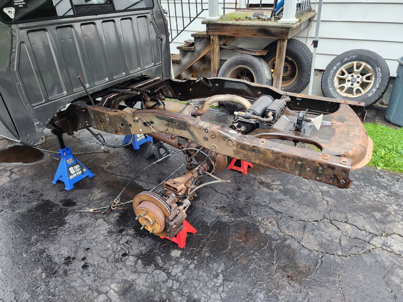

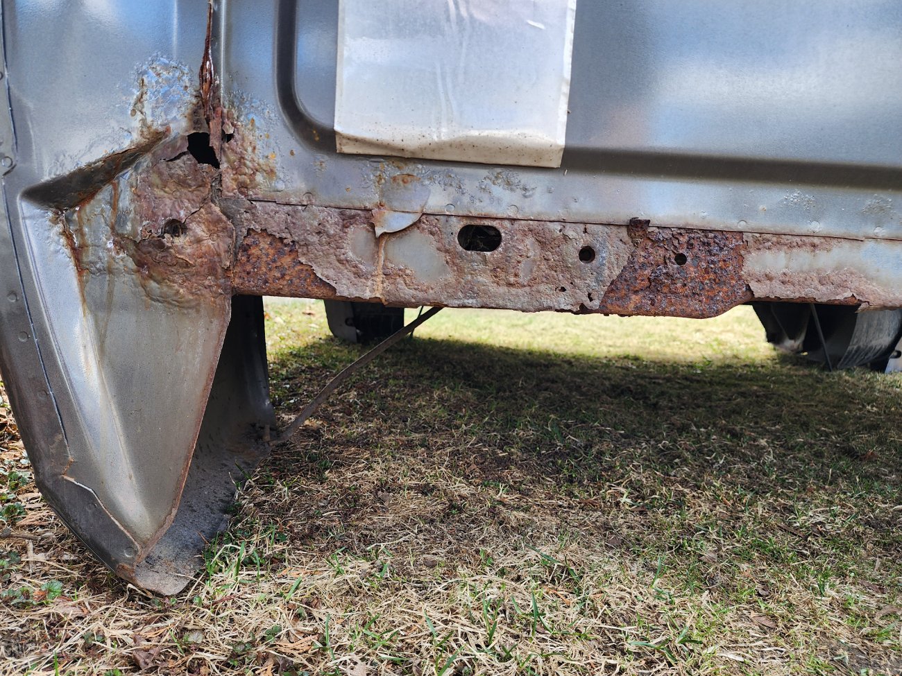

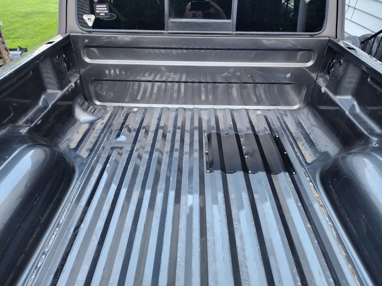

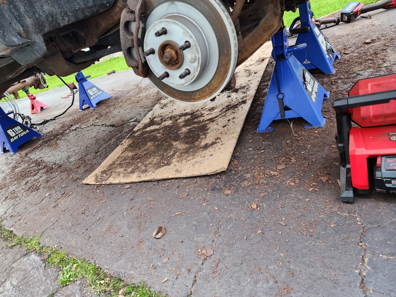

All done. Attached some pictures of the journey. Completed the following. Hopefully it will see many more years of service. Thanks everyone for the help and advice.
Rear frame and bed replaced along with the following
Leaf spring hangers/shackles
Rear shocks
Front shocks
Leaf spring bushings
Trans cooler lines
Parking brake cables, shoes, hardware, filters (fuel, air, oil, transmission)
Parking brake levers
Rear slide pin boots
Rear center Brake hoses
Remove seized/broken bleeders from rear calipers
Transmission fluid and engine oil change
Undercoat
Bed patch panel
Descale entire frame, hitch, bumper and apply surface shield
Repair rear wiring harness/trailer plug
