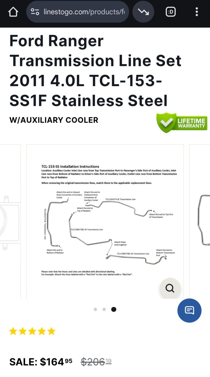

I have also found linestogo.com. Pricey, but they're made from stainless. That set comes with all three.

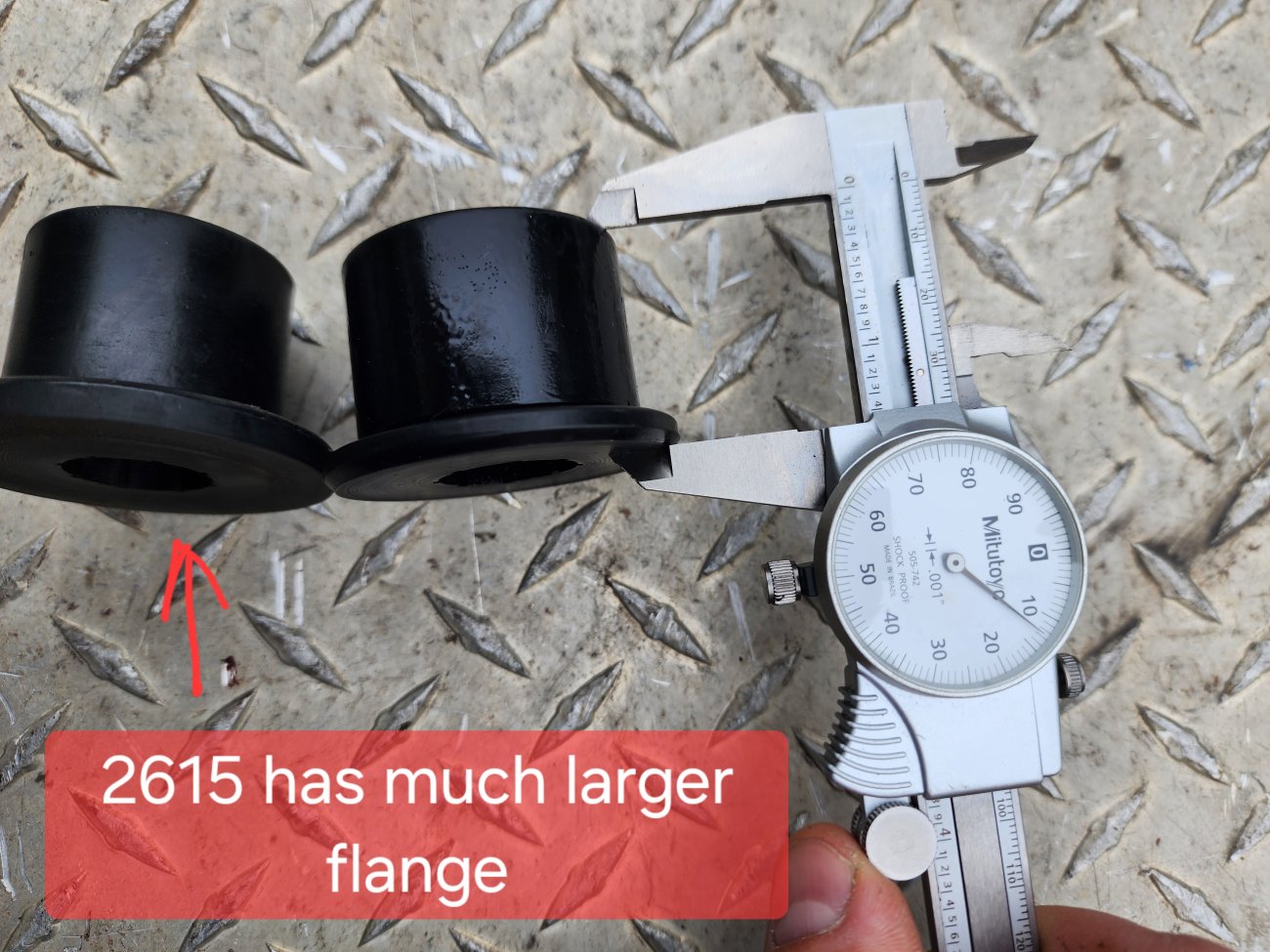

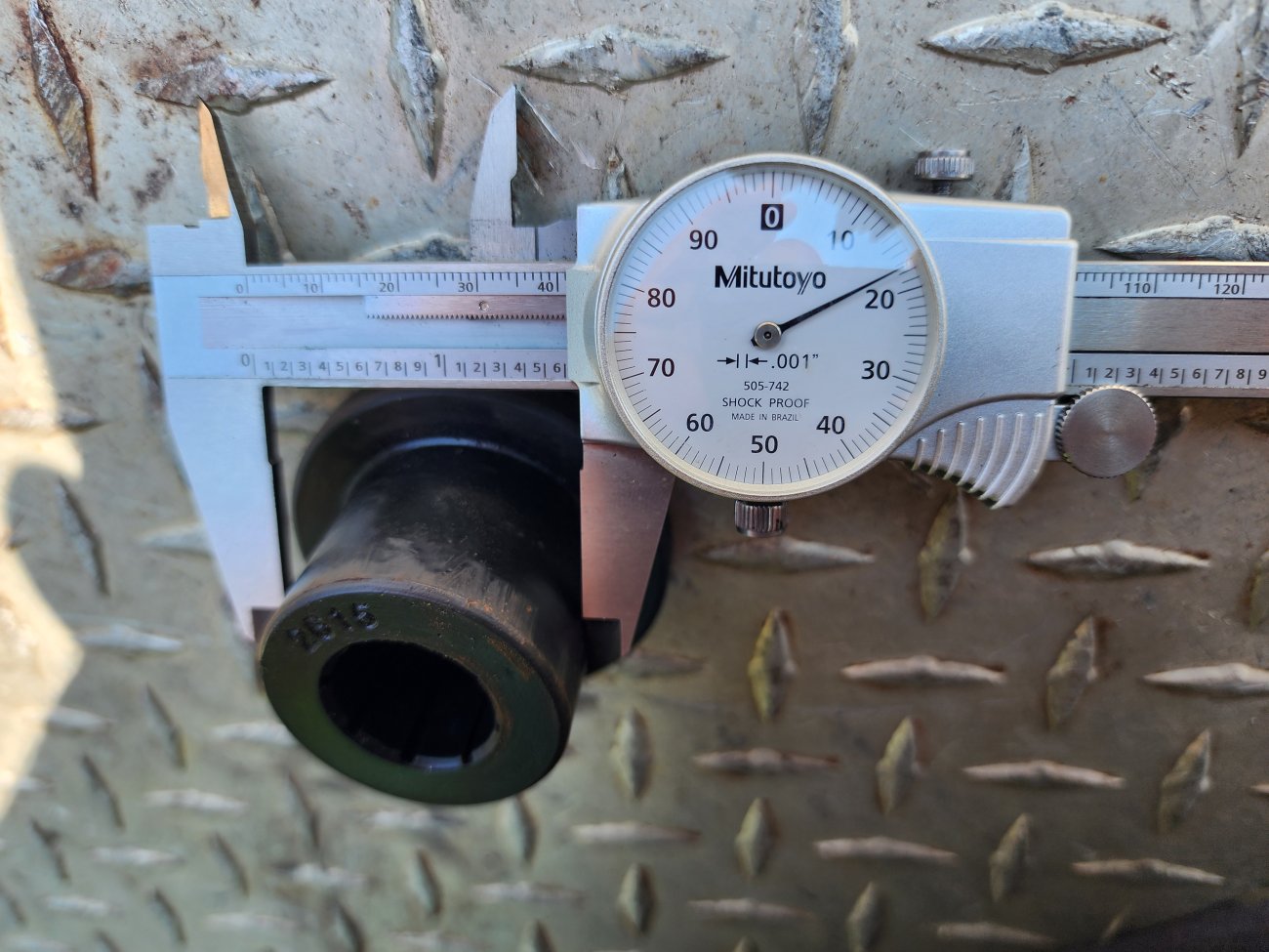

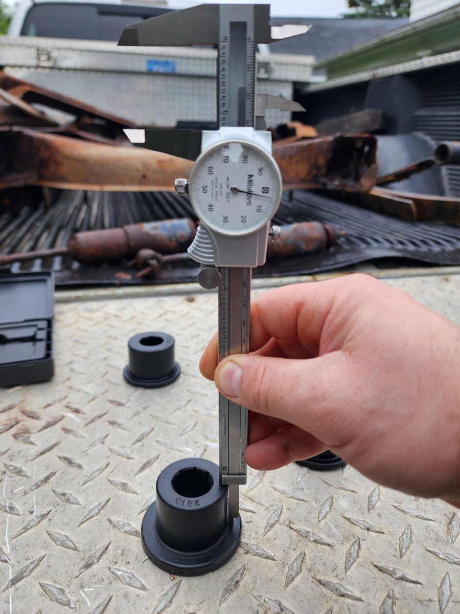

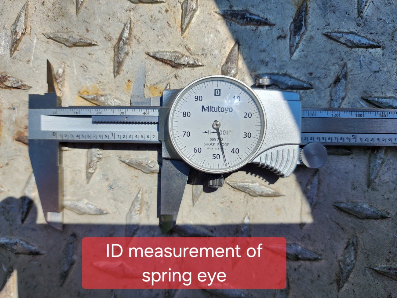

I have a question for you guys that used Energy Suspension bushings. How well did they fit? I bought the kit recommended from their website. Kit number 4.2156G. The bushings for the rear eyelet fit well. They slide into the eyelet with a snug fit. However, the bushings for the front eyelet have a significant amount of space between the outside diameter of the bushing and the inside of the eyelet. The bushings are about 3mm too small. I'm curious if anyone else has experienced this. I've tried attaching a video to display the issue but I can only post pictures.
After a week of emails back and forth with Energy and many measurments exchanged, they sent me a list of similar size bushings and had me select one which I felt might fit best. They sent the replacements to me under warranty. These fit much tighter. I'm not sure if it will be an issue yet. But the flange on the replacement bushing is not nearly as robust as the original. The original bushing is 2615 and the replacement is 2233.

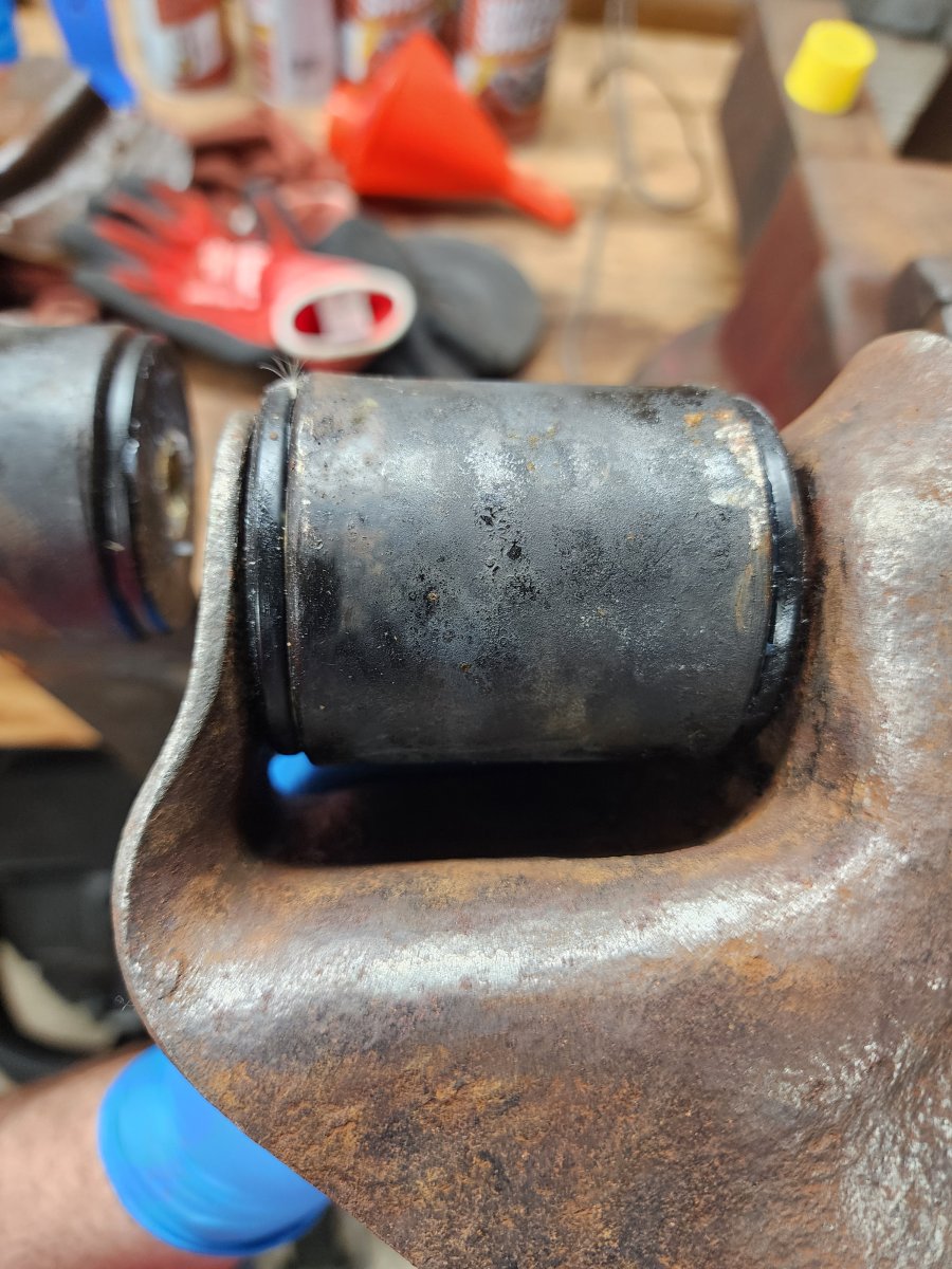

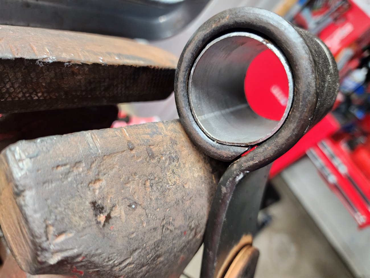

So, one thing to watch out for is that some of the poly bushings require the removal of the metal sleeve from the spring eyes that are part of the original bushings and some require that sleeve to be left in the spring eyes. I ran into a few problems. FYI, after I talk about the U-joints and yokes I go back to talking about the bushings and my sleeve fix
The truck I'm working on is a 2011 and the donor truck is a 2008. The leaf springs are the same as far as I can tell. The factory bushings had no outer sleeves. It's just rubber bushing against the inside diameter of both eyelets. As I said, the bushings for the rear eyelet fit fine. So they must have been designed to work without a sleeve. The front ones seem like they need a sleeve. I was thinking I could try to make a sleeve out of a piece of pipe if the replacements they sent me end up not working.
Seems pretty half assed on Energys part to put these bushings on the market claiming they are compatible with a year/make/model when they aren't. They must know some later model trucks don't come with an outer sleeve. If an outer sleeve is required for use, it should be included in the kit. I realize the end user can get creative and modify, but if that's the case, the instructions should say so. We shouldn't have to cobble wobble stuff together to make their product work.

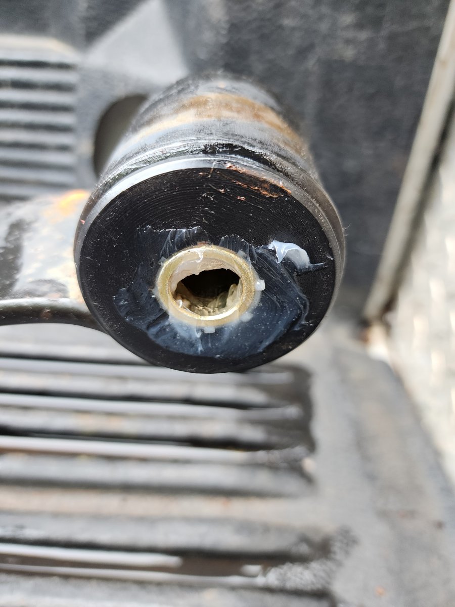

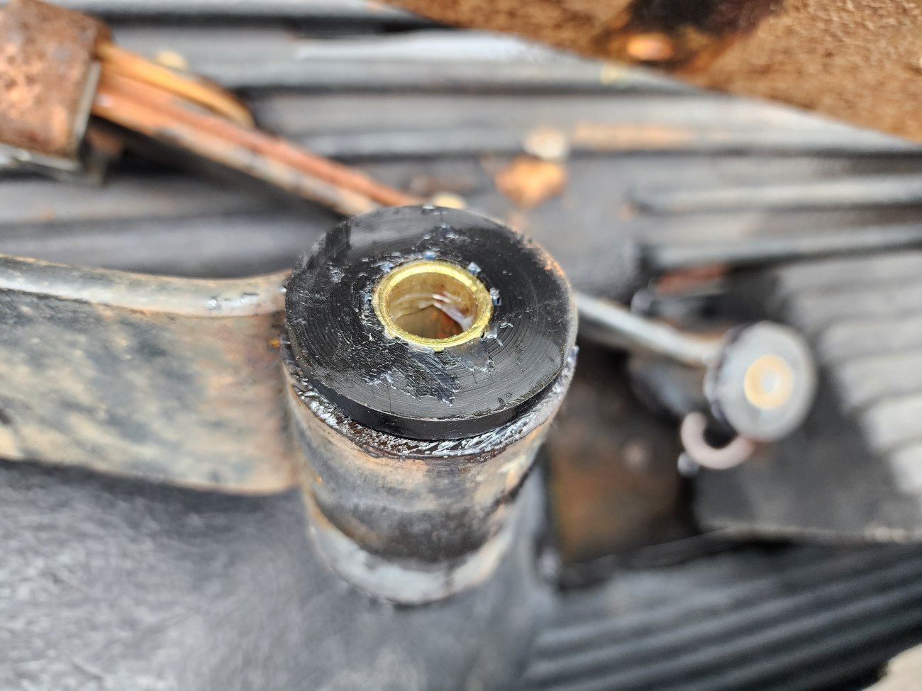

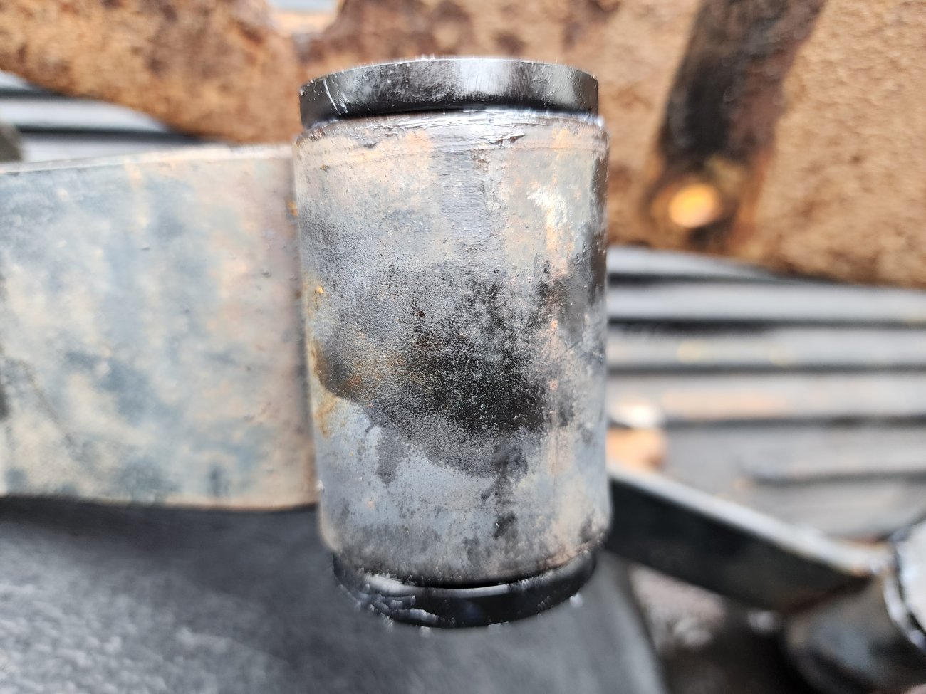

I have attached pictures of the replacement bushing they sent installed. As you can see, the outer flanges of the warranty (2233) bushing are quite a bit smaller than the flanges on the bushing that came with the kit (2615). I'll follow up with how it works out when I install the springs.

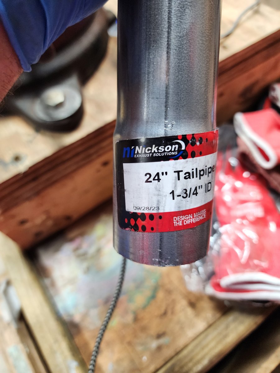

Interesting. I installed the 2233 bushings but once I put a shackle over them i wasnt happy with the fit. Would it have been ok? Probably. But instead i bought a piece of exhaust pipe (Nickson 17631), cut a couple pieces to length, and pressed them into the eyelets with a ball joint press. The correct bushings now fit well.
I ended up buying the transmission cooler lines from LinesToGo.com. The fit is very good (would have been even better if I was working on a lift and had more patience), the biggest selling point was FREE overnight shipping. They actually arrived next day.

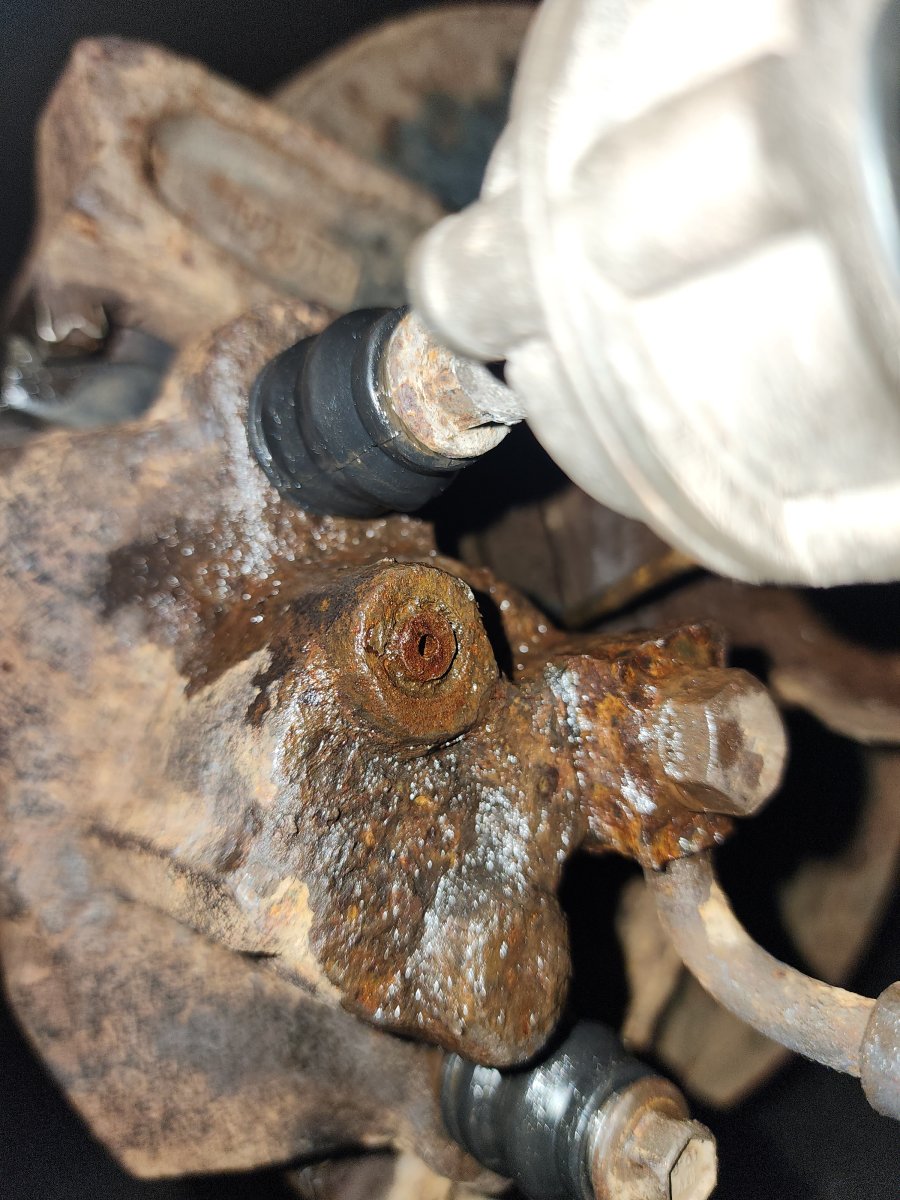

Assembly continues. I had to cut the rear brake hoses out of the frame bracket because they were rusted solid. Donor frame had a different bracket, so I had to salvage it. Somebody replaced these rear brakes and rotors not too long ago because the pads have alot of life and the rotors are nice. But they must have been looking for a quick payday because the slide pins are nearly seized, one of the boots is torn, the rear intermediate parking brake cables are swollen with rust and seized, the parking brake shoes are long dead, and the parking brake levers are rusted fast. And one of the bleeders is broken off. 😑 can't stop now.
