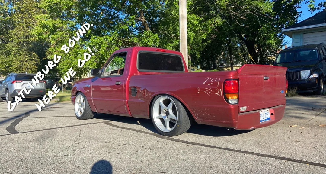

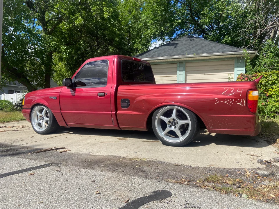

This guy did it. Put a Mazda bed on his Ranger. He keeps calling it "Mazda/STX", as if they're one and the same.
notice the tail lights in tis one.
I know the bed will bolt onto the frame. The question concerning the bed were if (a) my styleside, flush mount, tonneau cover will fit; (b) if the STX and B-series taillights will interchange; and (c) if the tailgates interchange between the the styleside, STX and B-series?
Still unsure about the taillights and tonneau, but that appears to be a thunderbolt tailgate spoiler so I'd guess that the tailgates interchange.
