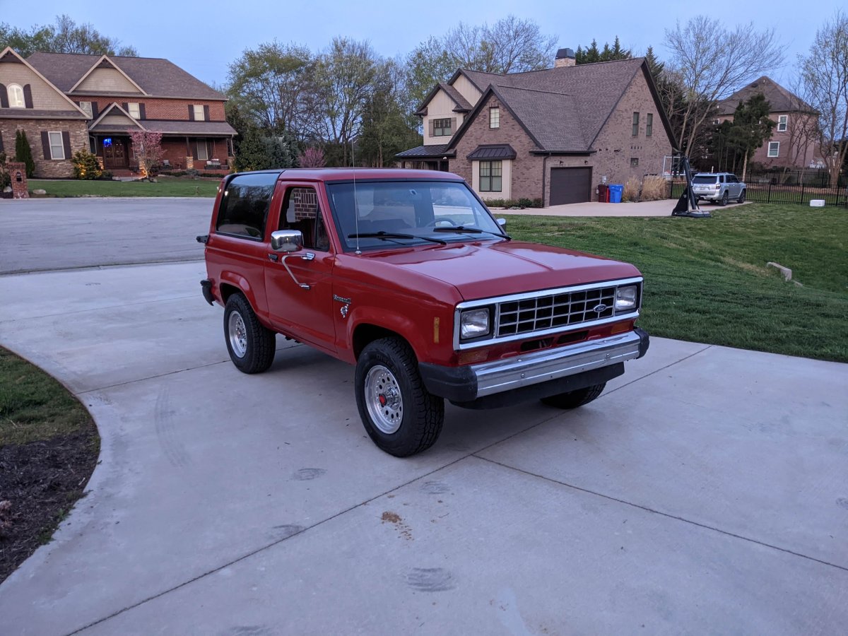

A picture from this weekend. Luckily I found the trim that flew off the windshield in a pull a part.
Coming along, I put about 75 miles on it this weekend shaking out the bugs from sitting for 11 months.

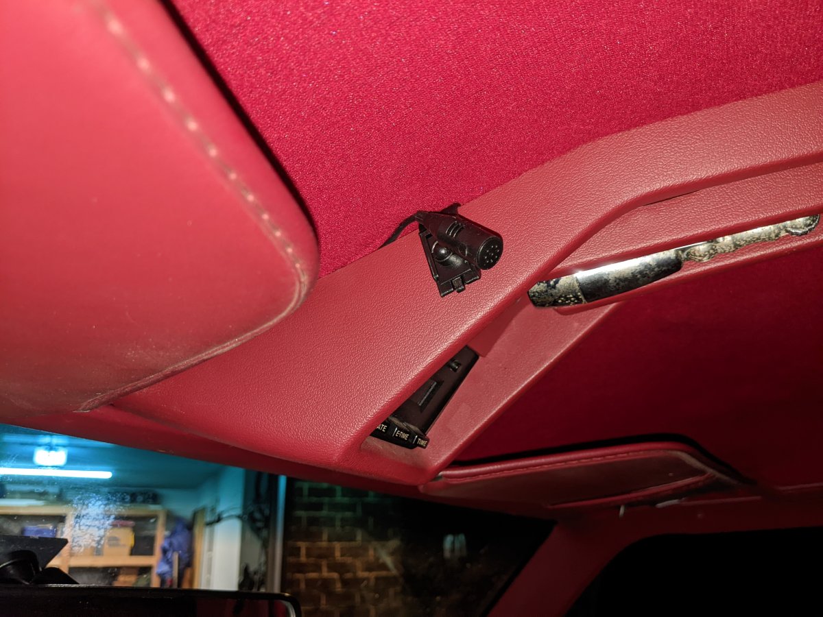

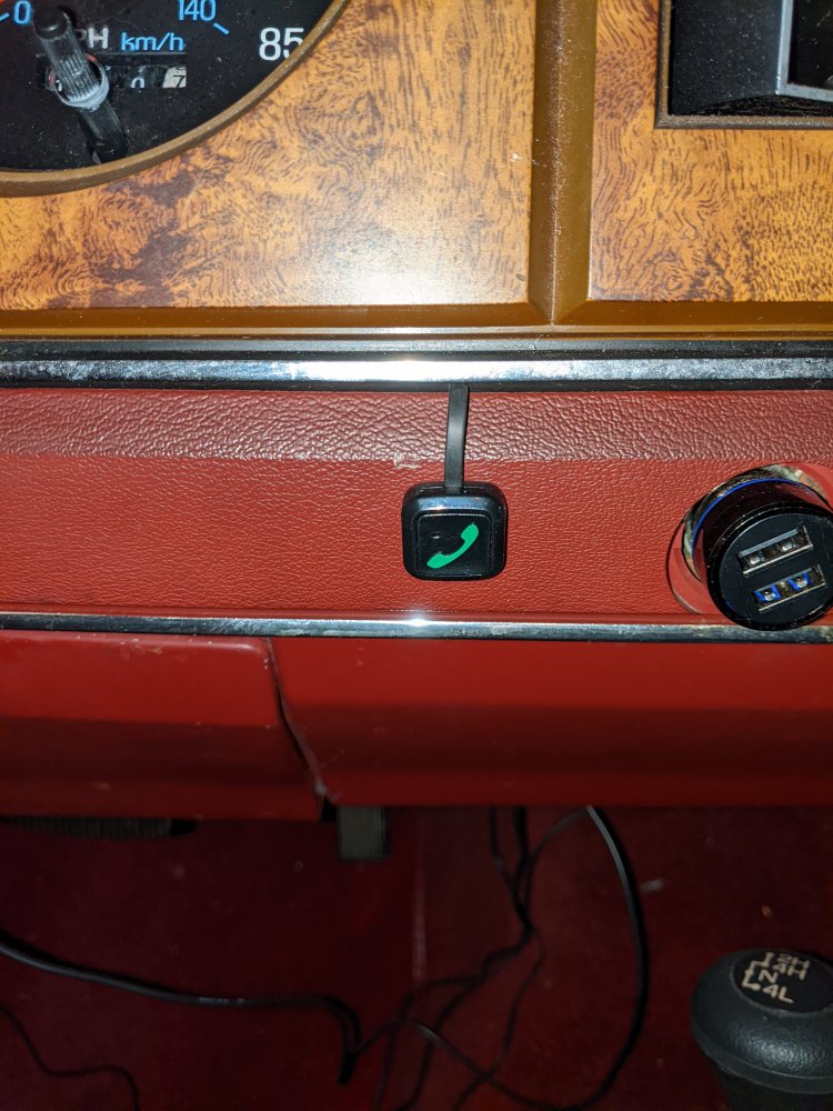

Added something tonight that I can't hardly drive a vehicle without anymore..... Bluetooth!
I bought this Isimple kit from Amazon a while back.
iSimple Hands-Free Calling and Music Streaming Kit with Control Button for Smartphones - Frustration-Free Packaging - Black https://www.amazon.com/dp/B00FRU5UNA/?tag=959media-20
I don't remember it being $90...., but it works great and I retain my stock radio and premium sound system. Easy to do a clean install and I like that it blocks FM signal so no interference like the cheaper FM transmitters.
